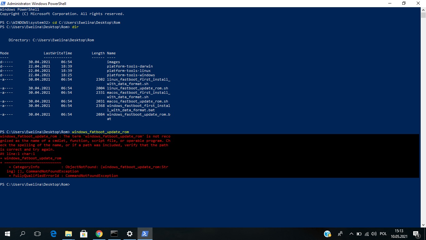

I want to install 12,5 global rom https://androidfilehost.com/?fid=2188818919693791060 . So I'm trying to use the command panel and I'm trying to follow the video tutorial and already at the beginning I must be doing something wrong. I'm getting lost when he is typing "update" I attached the screenshot.

I want to install 12,5 global rom https://androidfilehost.com/?fid=2188818919693791060 . So I'm trying to use the command panel and I'm trying to follow the video tutorial and already at the beginning I must be doing something wrong. I attached the screenshot.
This is NOT global ROM but the Xiaomi.EU custom ROM. Sorry for a little terminology:
- Global, EEA and CN : official Xiaomi ROMs for the respective sales regions
- XIaomi.EU : custom ROM derived from the official CN ROM
As to your screenshot: you have a typo in the command !
And you need to run" windows_fastboot_first_install_with_data_format" not the update.
