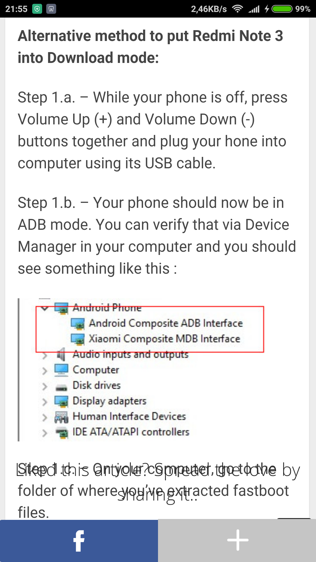

Are you coming in the alterive download mode
Thanks for ansverig, but! My phone not startup, not going to recovery or fastboot. When I hold Vol+ during USB inserting, probably starting EDL mode. Phone recognized as Qualcomm blah-blah-blah in device manager. But when i try to flash the ROM via MiFlash i got error "Reached end of file ....... Receiving hello packet"
End of file means its the wrong mode. Press volume up + volume down + power to reach the proper download mode. Then flash with any official fastboot rom
Pressing volume up + power will bring up boot menu. If your system has problem, the menu will not show up. It will instead go into an alternative download mode.
You don't want that. You want to go to proper download mode. You need 3 buttons. Volume up + volume down + power to reach the proper download mode
