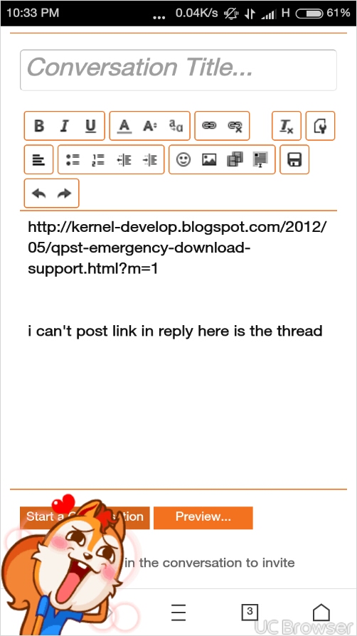

that thread
if you found a solution pls alert me
Reactions: G0ku5
i can't paste link so make screenshot pls check

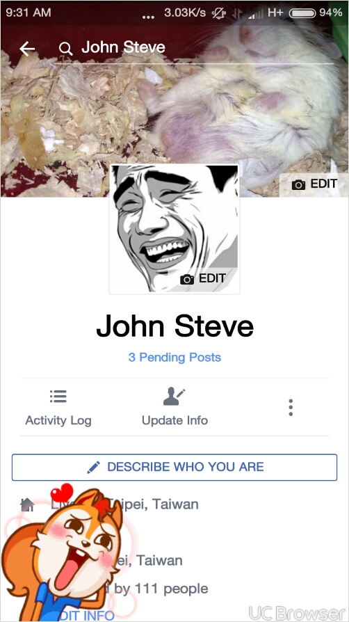

guys if you have facebook account we can use group chat to solved that problem
here i have problem to receive notification if u wanna join here is my facebook account
john steve
