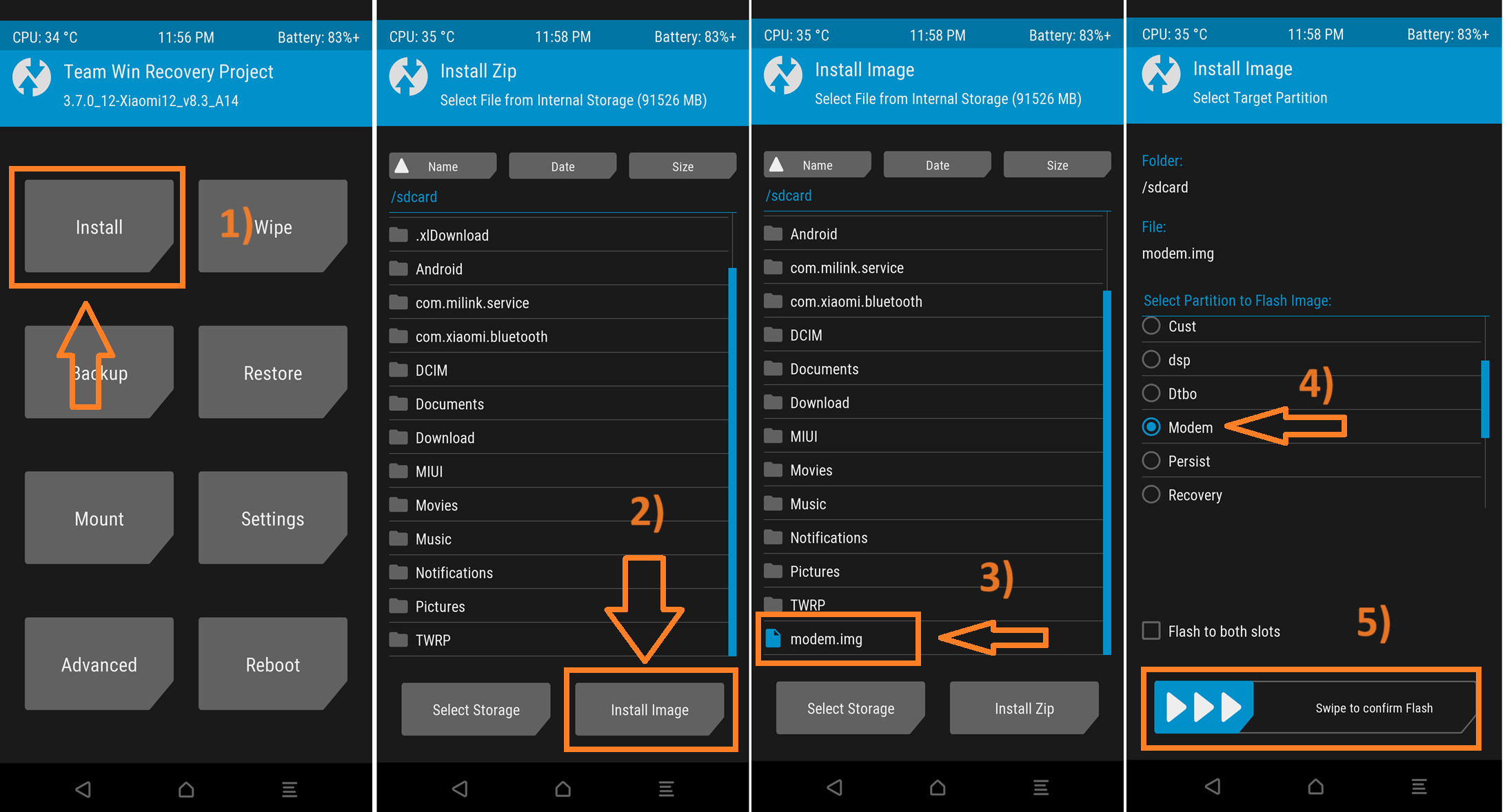

I'm sorry if this has been asked before. I'm on a EU device, so I need to flash the modem files.
As it seems this has to be done every update, did somebody maybe made a package that can be flashed through TWRP (with OTG)?
I always prefer to try and do all on the phone if possible and only get the laptop out if something goes wrong.
Yes. Looks like you can copy the modem.img to local storage and then in TWRP install this image to the modem partition. As for OTG, I could flash even the ROM itself from OTG, so I think you should be fine flashing modem from OTG.
Reactions: Bamn09
So only modemfirmware.img the rest in that file can be ignored?

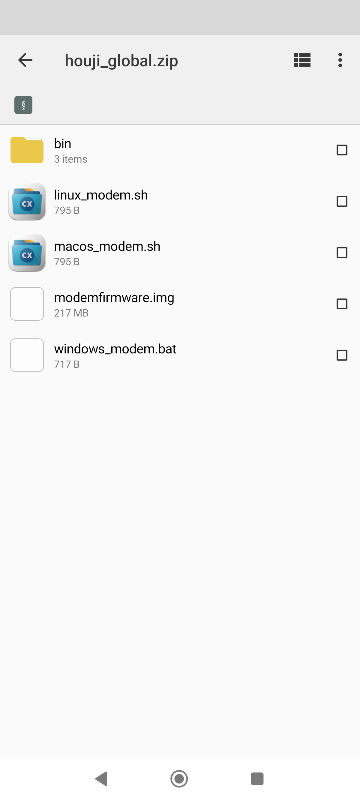

Redmi Note 13 Pro 5G / POCO X6
In the Houji zip found on this forum the file is named modemfirmware.img 217mb.
I guess that should be the one.
There are more files in the zip, I think those are just to accommodate fastboot flashing.
That should be it. I have seen it with different names before. I think you downloaded it not from the firmware repository but from a custom packed place. You can name the file whatever you want, it's not of importance.
Edit: Seems like the procedure varies across devices. See the next comment made by gogocar62, don't flash that image from TWRP. That's when the other files comes in hand. Those are shell/command prompt files which make it easy for you to flash it using a PC without writing the commands yourself. Just double click on the file of your platform.
Bamn09
No. For "houji" it is not possible in TWRP.
Only "modemfirmware.img" is installed, the other files are just PC tools.
