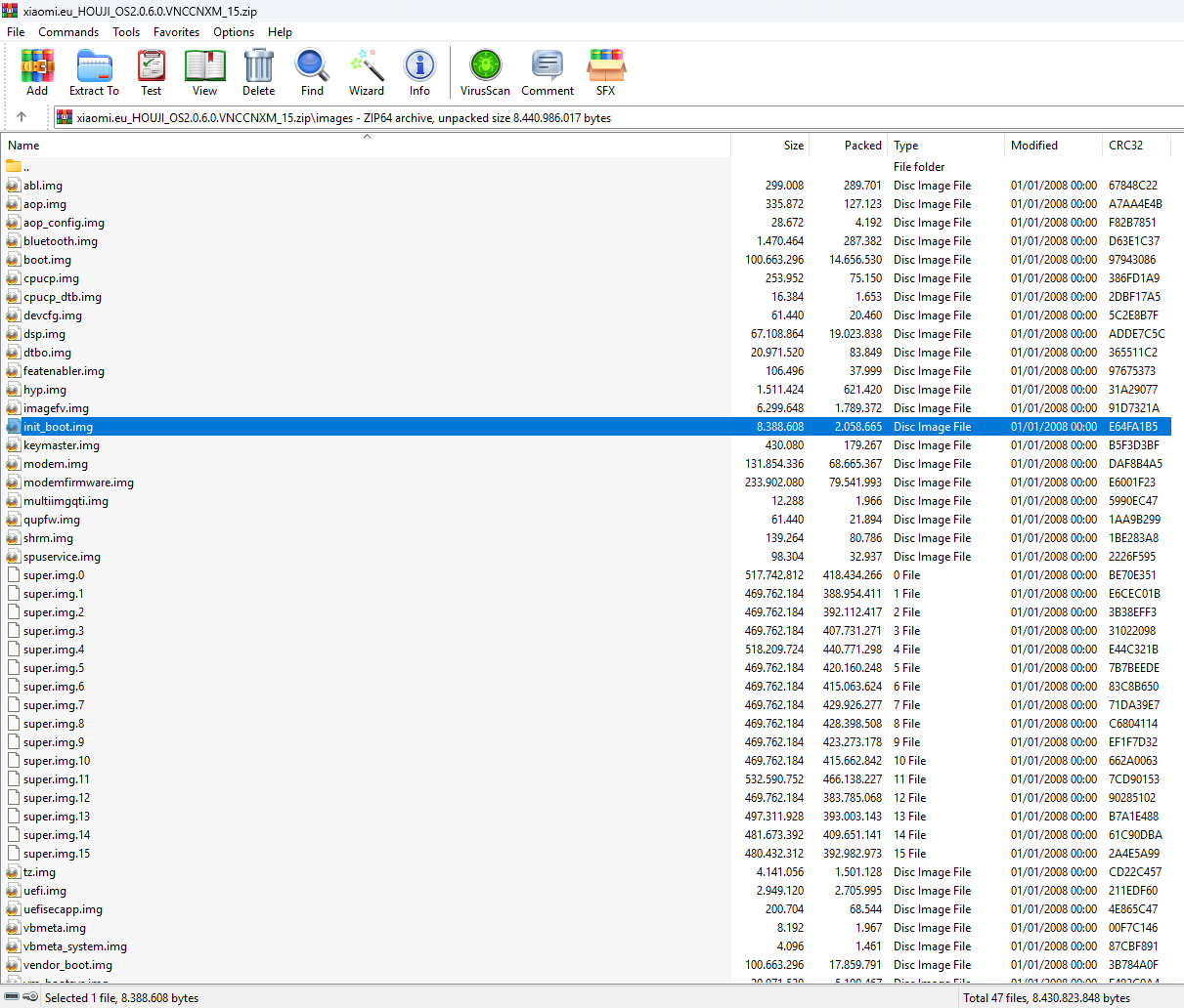

Guys, my phone is Xiaomi 14. I upgraded it from hyper os 1 stable xiaomi eu release to hyper os 2. Now I cannot patch init_boot file to re-root the phone, as the official houji image is for hyper os 1, and its init_boot file is not suitable for hyper os 2 version of the phone. How did you tackle this issue?
Theres a init_boot.img in the ROM, you have to extract it, go into images folder and take the init_boot.img from there
