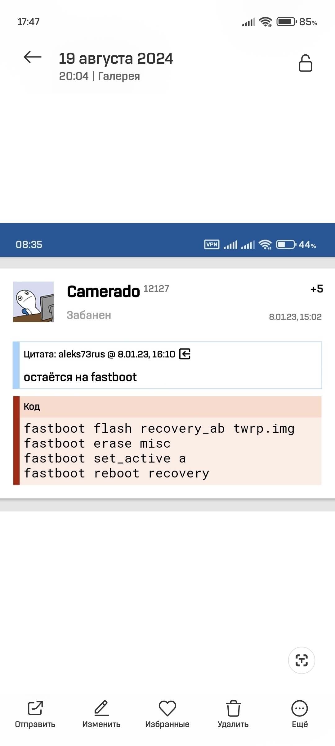

I need quick help, got my houji unlocked today, trying to install this rom via twrp, when I'm flashing the A15 twrp through fastboot as per the instruction here, after the fastboot reboot recovery command, the device shows the twrp splash screen & comes back to fastboot mode. what am I doing wrong?
if I choose to install the rom through the fastboot method, do I need to remove twrp and return to the original recovery? If yes how to do it?
update: I flashed the current stable ROM via fastboot, device booted fine to setup hypros, but when I wanted to go to recovery, twrp still flashes the splash screen and redirects to fastboot. wanted to know how to remove the TWRP from the device now or make it work. Thank you
Enter these commands
No, not necessary.
I think the twrp versions of Xiaomi 14 series cannot decrypt the storage password. You can install rom via fastboot
tried this, still twrp goes back to fastboot,
EDit: more digging shows this problem persists on indian variants, here
so for now re flashed stock rom via mi flash, updated a15 rom via fastboot, staying away from twrp. need to figure out rooting via fastboot isi at all its possible.
