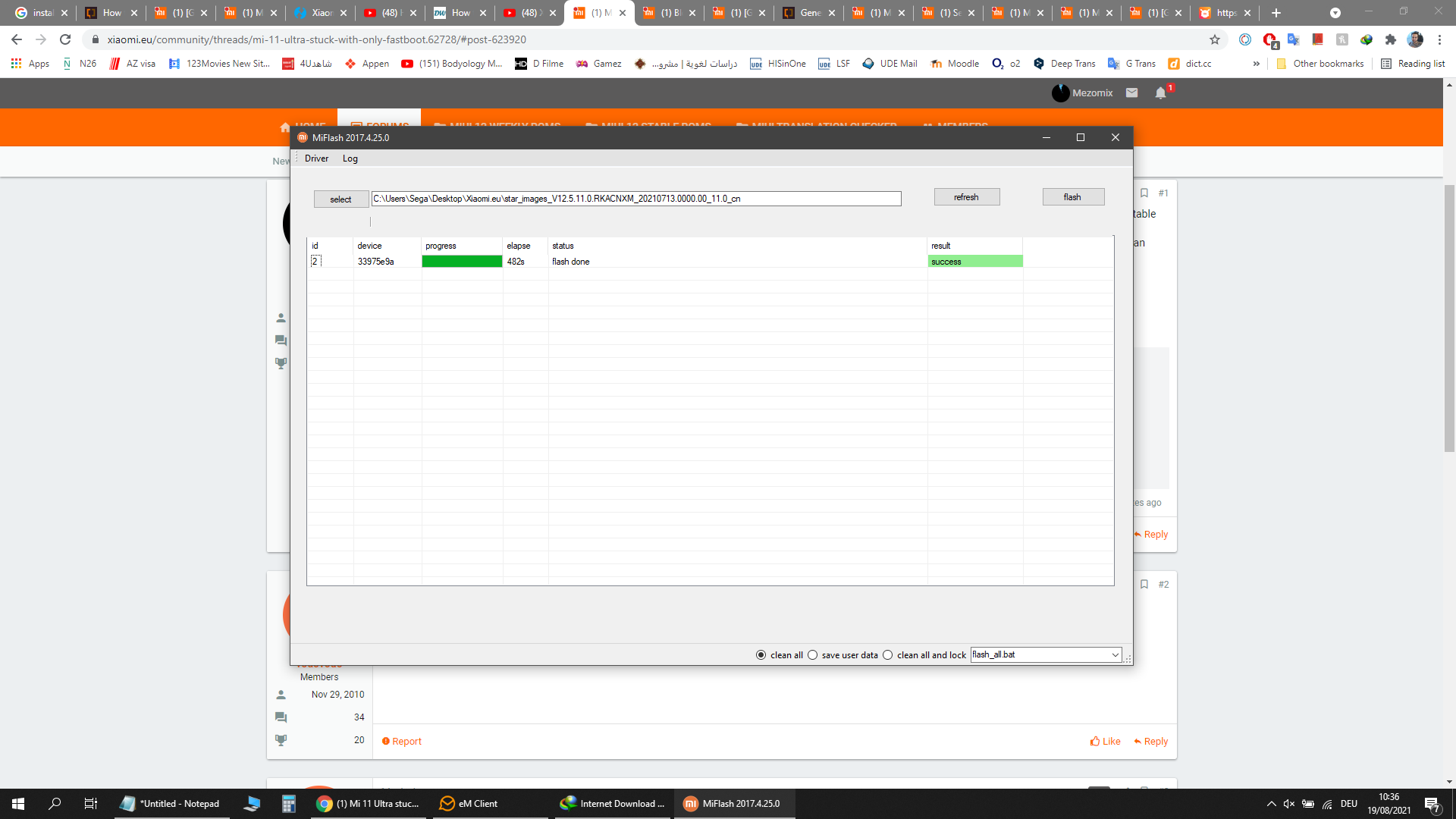

dear, all the time my bootloader was unlocked, and the fact that the Russian guy did flash my phone through the EDL mode, not the fastboot mode, which as I explained tried to do but it asked for an authorized Xiaomi account, which can flash the device in EDL mode.
so that was my only resort in the end because as I have shown by screenshots, I tried every available solution on the internet and tried my own as well.

it was unlocked all the time, and I was checking it all the time by using the miflash_unlock.
and if you saw my screenshots, I have successfully flashed the CN Rom by using MiFlash, but the phone remained in the fastboot mode
