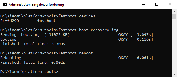

This was not the solution for my situation (MI 10 with a FASTBOOT circle after having downloaded the stable EU ROM v12.2.2.7).
This what I have done so far using the latest platform-tools:
Nevertheless the MI 10 is still in the "FASTBOOT" mode.

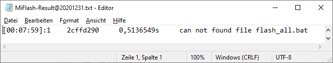

Then I tried to flash the EU.ROM v12.2.2.7 by using the MiFlash tool 20200314.
Result:

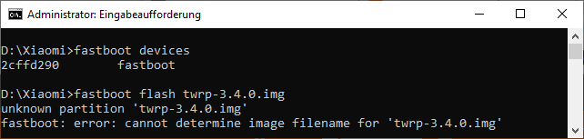

This is the error message I get:
EDIT1: I obviously forgot to enter the additional word "recovery". Now I try it again!

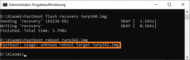

EDIT2: Now the flashing of the 3.4.0.img worked, but the reboot 3.4.2.img failed:
Mate, read again the command syntax from my previous post.
You're making a simple syntax error.
