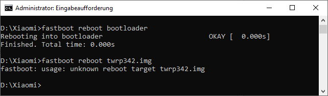

I will try that.
EDIT: The first command worked, but not the second. Look here:
Maybe I have to flash the 3.4.2.img at first.
I am not able to power off my phone. Whatever I try I always enter the "FASTBOOT" image.
Not fastboot reboot twrp342.img but ..
fastboot boot twrp342.img
Twrp 1206 here ...
Uppps! You're right, I was misleading him.
My bad, sorry.
At least he managed to boot to recovery.
