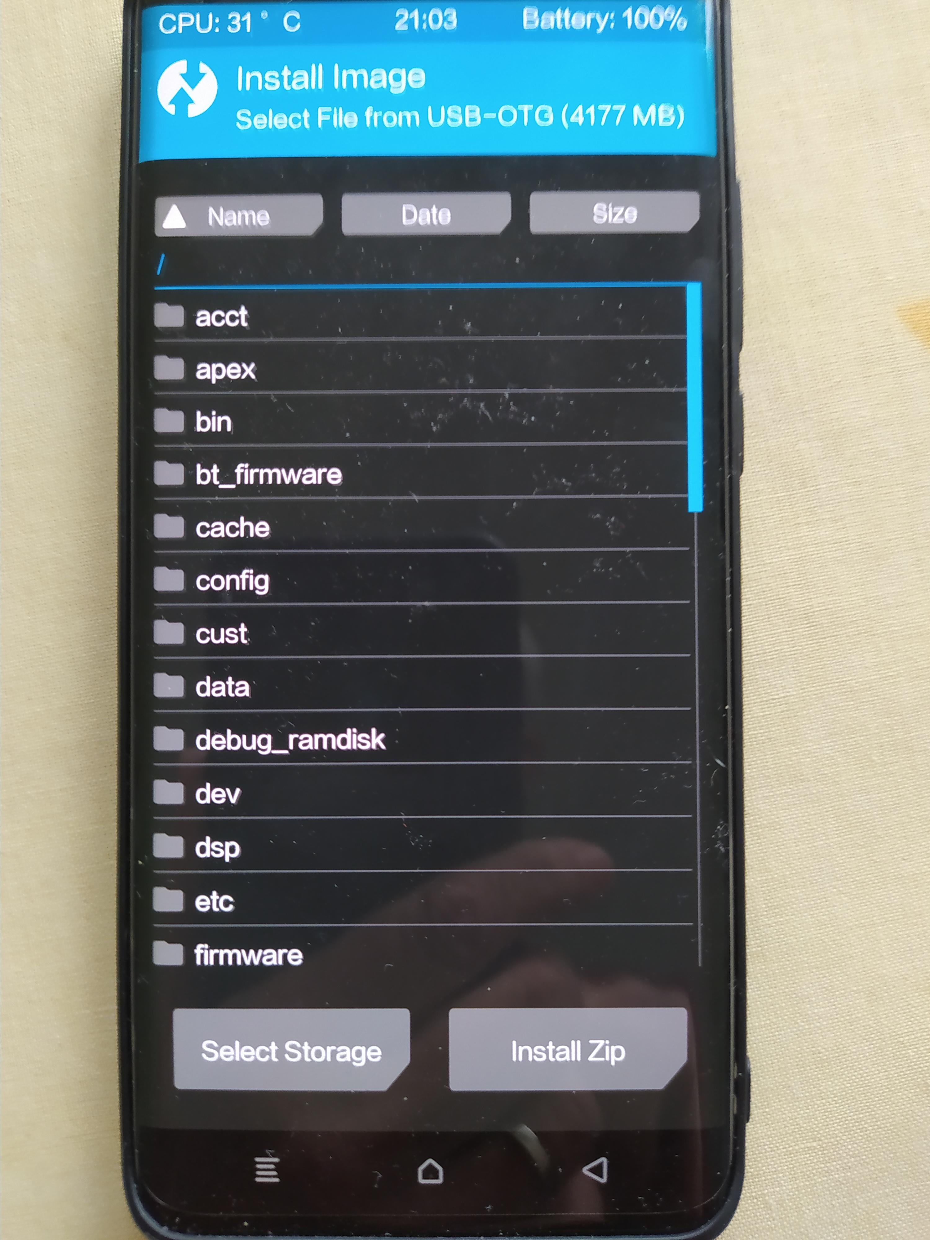

Can you give me a photo of twrp , Choose Install and give me a photo ..
Here is it:
The problem is, that nothing happens, when I choose "Install Zip".
Within the shown list there is only a folder "storage", but nothing in it.
You might have somehow sometime formatted your internal storage, and consequently lost your ROM.zip file.
What you need to do is to either use OTG or move the ROM to your phone on some way.
Послато са Mi 10 помоћу Тапатока
It is empty.
It is v3.4.2B-1206
Then try to connect your phone to pc as you are now in twrp , if you don't see anything you have to do a format data ..
If you found "sdcard" folder and it's empty then you have to do a format data ..
Nothing else works if data is encrypted ..
Choose , Wipe / Format data / type yes and hit enter ..
Go back to main menu and now choose , Reboot / Recovery ( phone will turn of and will enter twrp again ) ..
Now as you enter again to twrp you can connect your phone to pc and copy EU rom zip at your storage ..

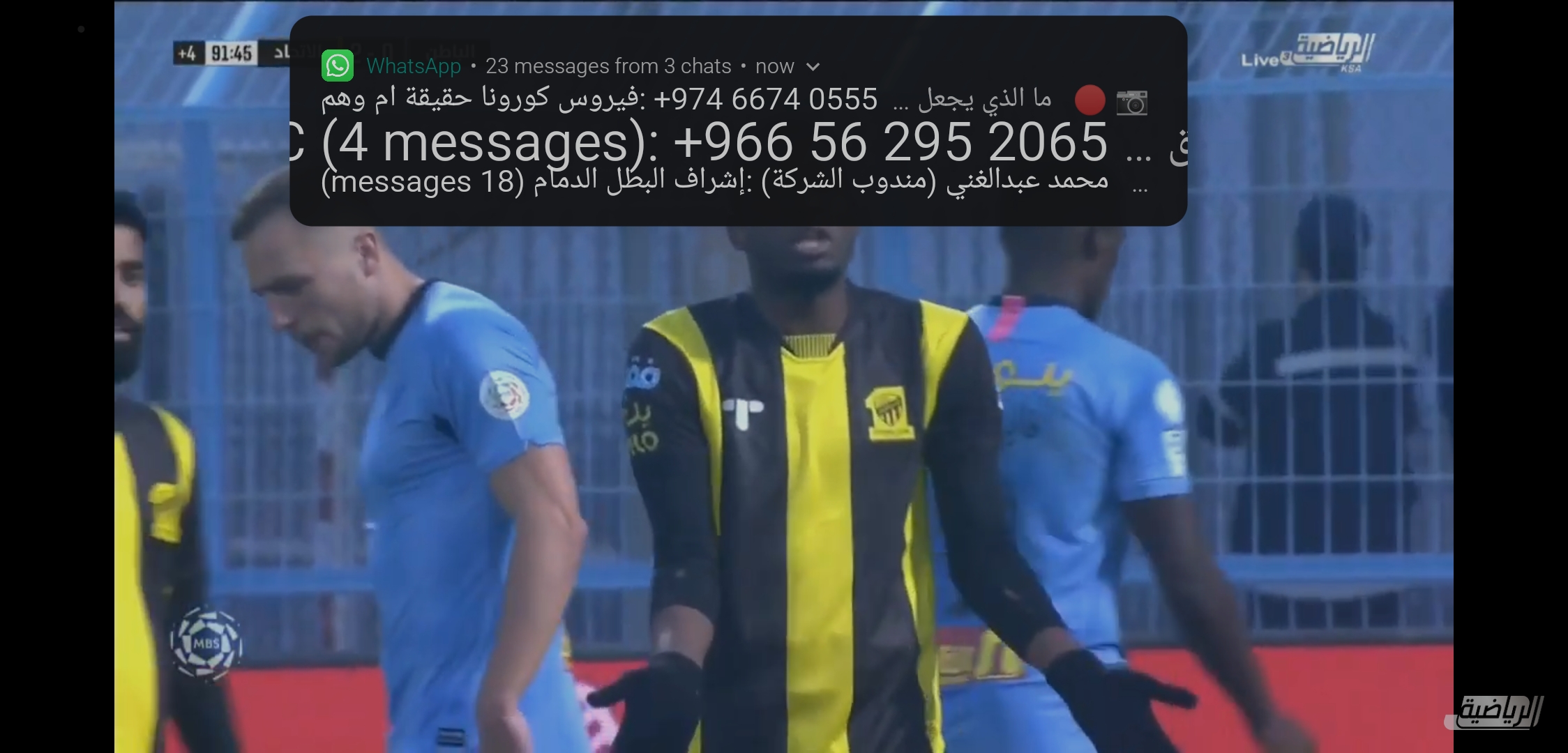

Whatsapp notification bug
Eu 12.0.3.0 dipper mi 8

Then try to connect your phone to pc as you are now in twrp , if you don't see anything you have to do a format data.
Ok, I returned to the TWRP main menu, removed the USB Flash Drive and reconnected the phone with my PC. The Windows Explorer now shows the entry "Mi 10", but I don't have access to any folder or file, which is within the Internal Storage of the phone. So I cannot copy the ROM (as ZIP or extracted?) into the phone this way.
My phone (MI 10) doesn't even have an SDCard slot.
Shall I nevertheless hit the "Wipe" button?
If you already have OTG USB, why don't you simply copy the ROM to it (on your PC) stick it back to the phone and proceed with flashing?
I have already tried that (with the ROM as *.ZIP file and extracted), but the installation did not even start.
You have to choose storage - OTG, not internal storage. Then select the ROM.zip file from the otg.
