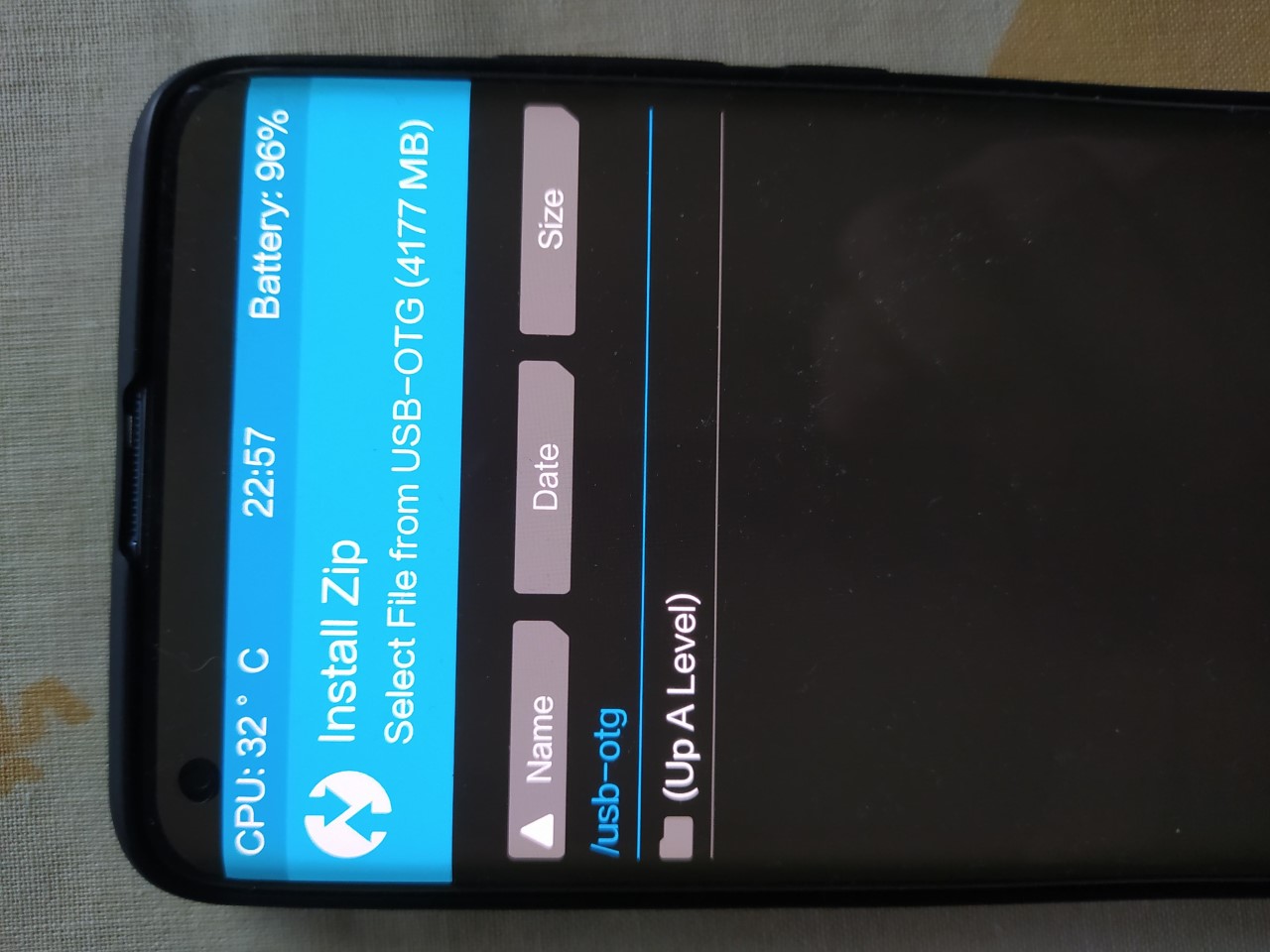

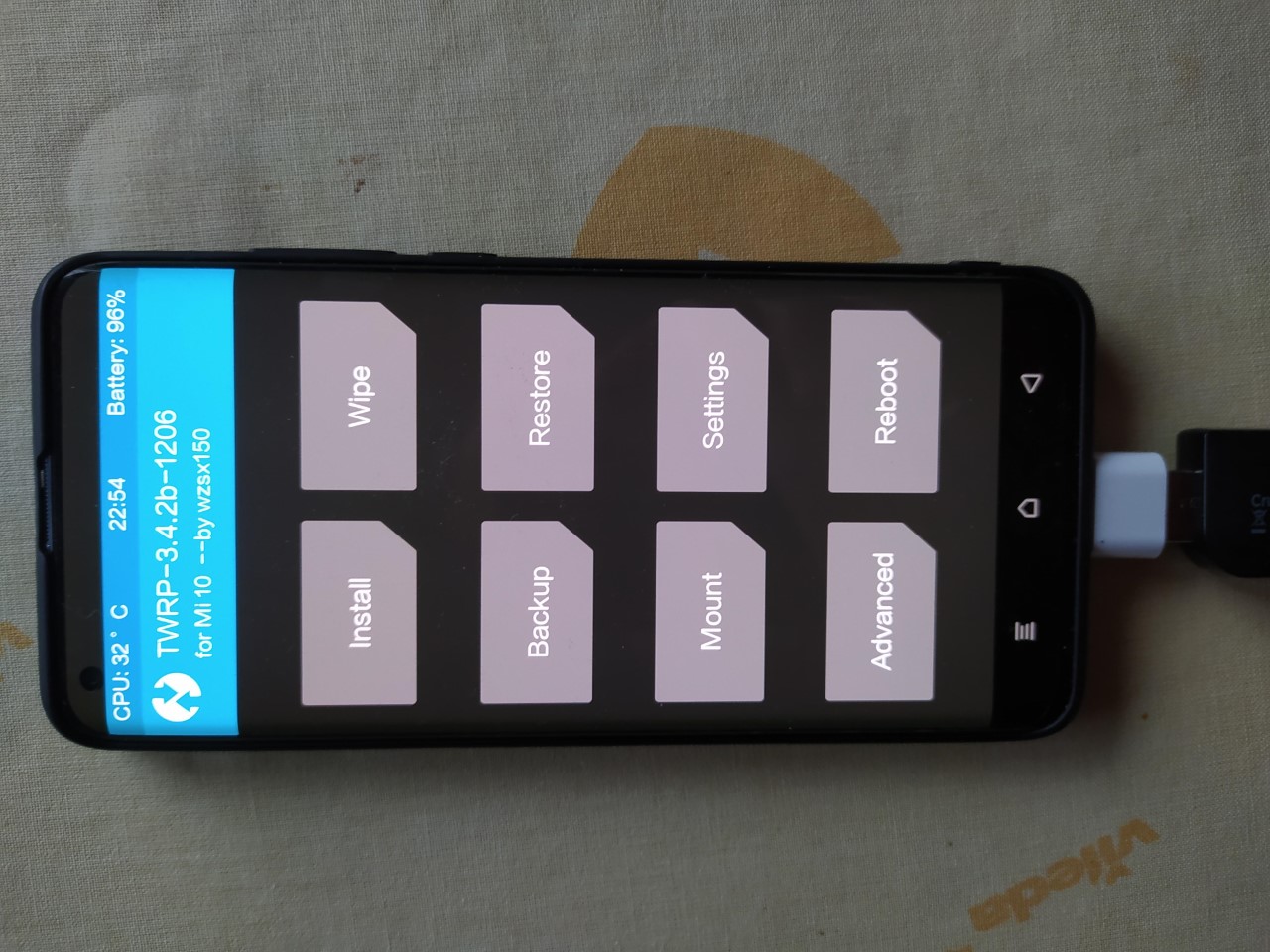

Meanwhile I have tried again to get the ROM installed by connecting the USB with the ROM ZIP in it.
The related *.ZIP file has not been detected by the TWRP. Here are the pictures:

I am really sorry mate, but I ran out of ideas.
It is really strange that the phone doesn't recognize the otg usb plugged in.
Maybe it has something to do with the filesystem, I don't know.
Maybe others could help.

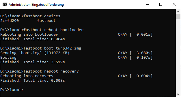

Meanwhile I have successfully restored the TWRP main menu by entering the following fastboot commands:
Now you wrote what exactly do ..
Go to twrp and reboot to system , disable all fingerprints and pin ..
Then enter twrp again and you will see everything inside ..
@gkalen: Thank you very much for your advices.
With your help I was able to recover my MI 10 and to get the stable EU.ROM v12.2.2.7 properly flashed.
After having entered TWRP again I was able to see for the first time since yesterday the Internal Storage of my Mi 10 and was able to copy the ROM into my phone.
