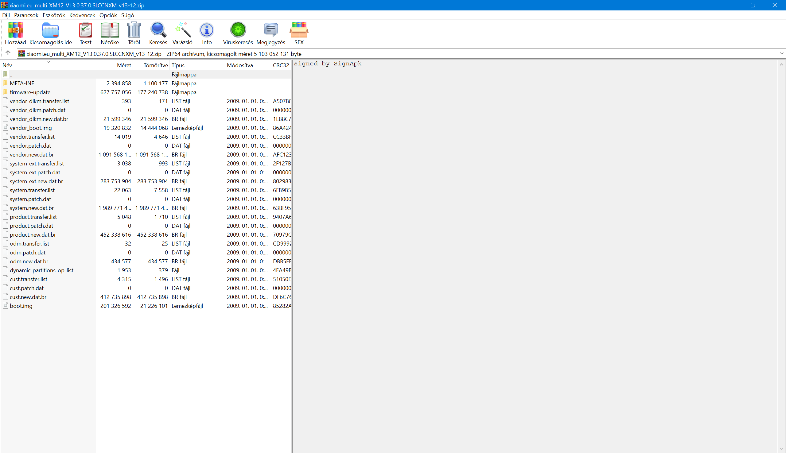

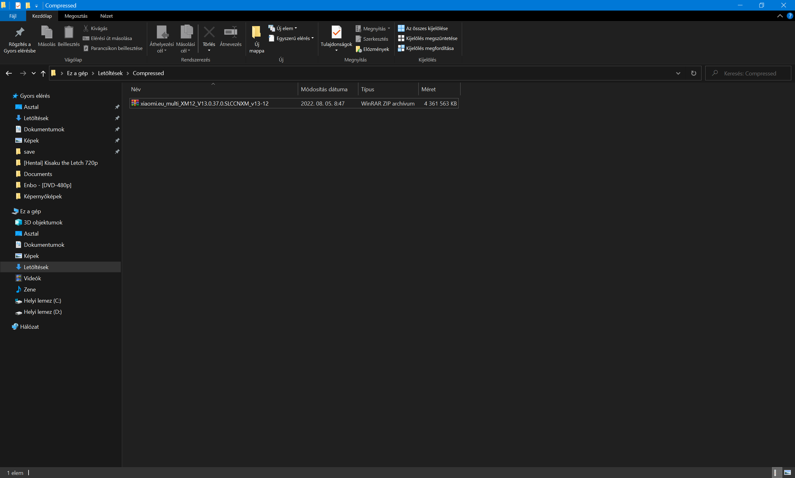

not iso file or img but winrar
How to put TWRP on the phone? According to my acquaintance, it is no longer the same as, for example, in the case of the MI 10T Pro
system_root couldnt be mounted (No such file or directory)
same with "system_ext" and "product"
