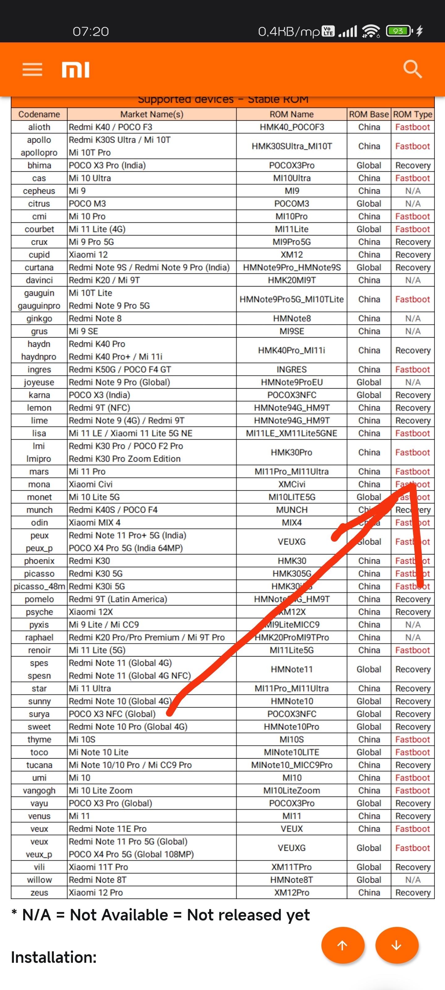

My storage is encrypted . when I install my Rom ,do you know what I should do?
The update procedure works the same on Mi 11 /12 / Poco F3 / etc.
TWRP
I flashed TWRP via this way.but I can't find any files in TWRP when I would've installed my ROM having downloaded. When I installed via OTA,it showed "Your internal storage is encrypted..."Do you know what should I do for this update without wiping my data.
