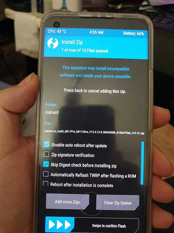

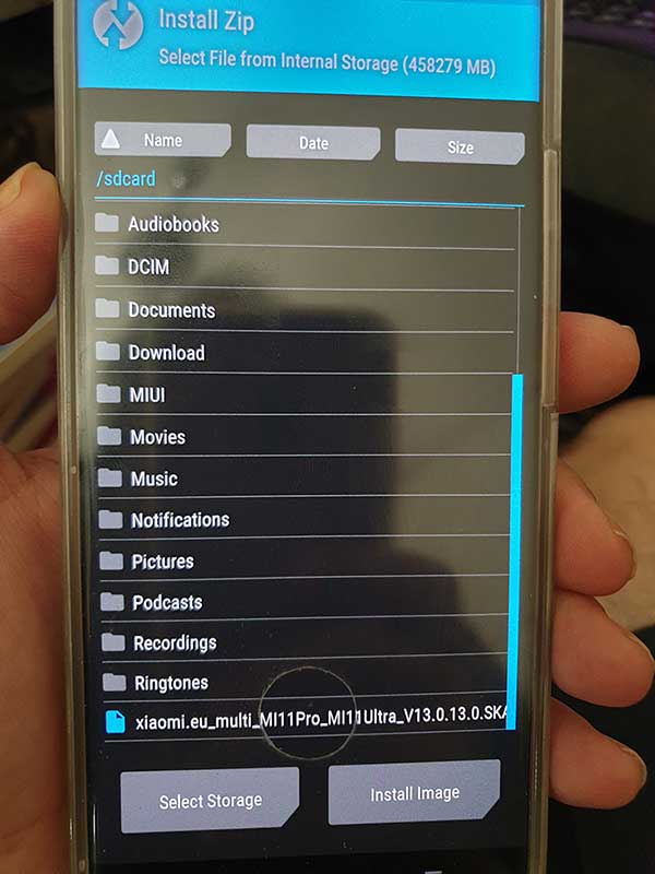

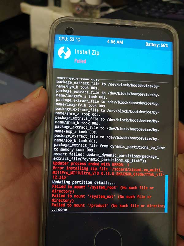

Hi, I installed the correct TWRP on my mi 11 ultra, when I try to do the update via OTA it reboots to recovery, but when I try to install it gives me mount error at system root(by the way I deleted the dalvik and it formatted everything, good thing I have bakup on the qnap), I tried changing slots on the B but it's the same. I attach photos of the steps. Thanks
View attachment 43414View attachment 43415View attachment 43416
TWRP update shows ERROR: 1 / can not mount system ...
- this error can occur if you try the update with updater app or if you started TWRP manually
- Solution:
-> while you are in TWRP reboot your device in recovery mode
-> try to install the rom again
-> if it will fail, reboot in recovery again
-> or use "fastboot boot twrp.img" again
-> sometimes you need more then one try
-> if it will not work choose another twrp version
- Solution:
Perfect restarted in recovery from recovery the installation succeeded, if I had asked earlier I would not have lost my data. Thanks
