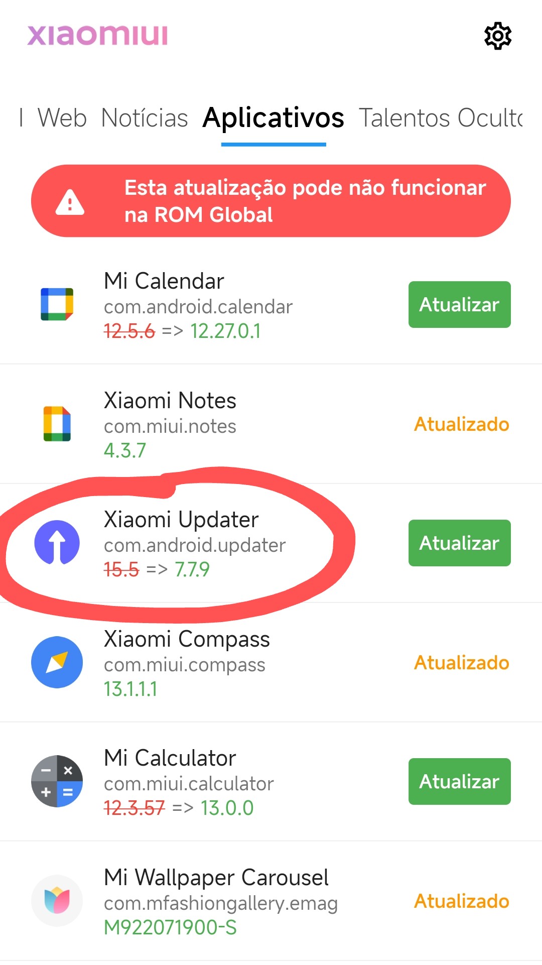

@samirglima formatting is no solution, i would rather want to understand why it happens, can you get me output of:
I understand. And forgive my ignorance, but what is this command you say is for? One thing I also noticed is that in the Xiaomiui app it says that it has an update for this, do you think it is prudent Update it? I say "try" because not always updating something available works on xiaomi.eu, I think it's also more for global version.

@samirglima command will return local (cached) miui version value that both settings and security app base on to notify user, those updates from xiaomiui app are for global and you will not be able to update system apps like this, it's impossible so users would not make bricks of their phones

I understand friend, so just use this command in fastboot and that's it? Or does something open for me to do?

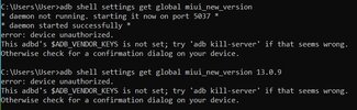

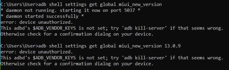

Okay, image below showing what appeared. Did I do something wrong (or did I do nothing hehe)? I put both "adb shell settings get global miui_new_version" and "adb shell settings get global miui_new_version 13.0.9", which is the current stable xiaomi.eu version for Mi 11.

Enable "USB debugging" in "Developer options" and confirm when asked when you connect the phone to the computer.
