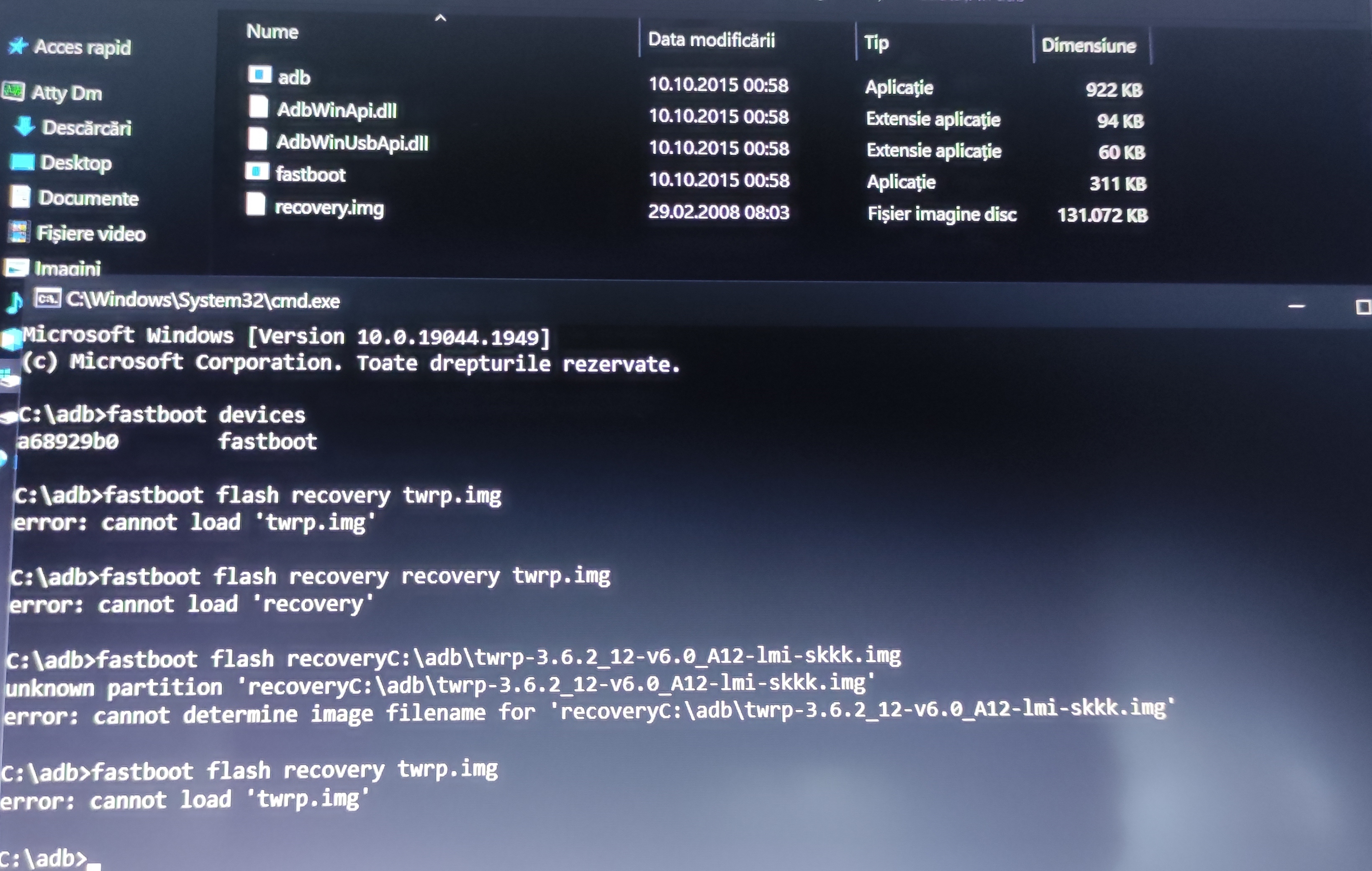

I need help pls,i have this error when i try to flash twrp to my poco f2 pro

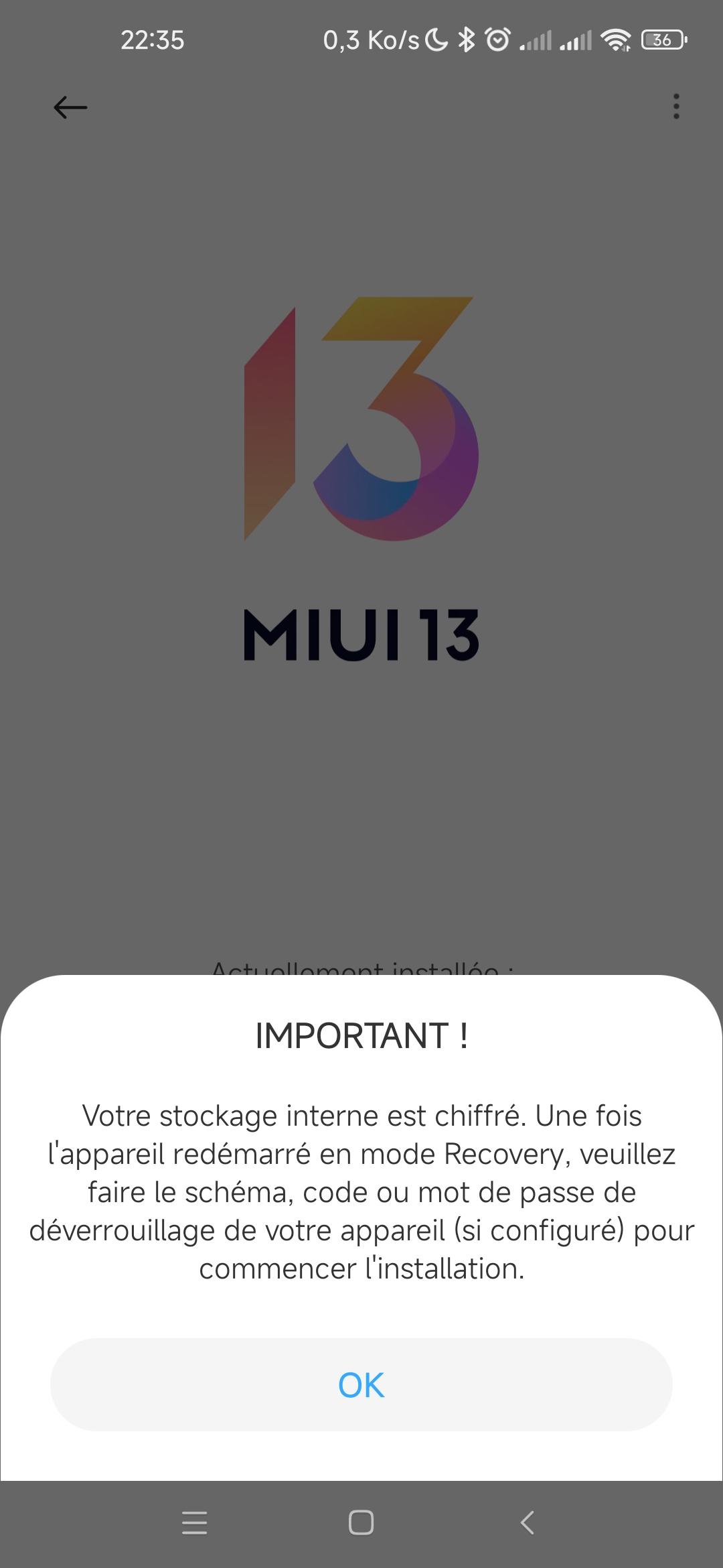

bonjour, j’ai la mémoire de mon MI10pro qui est verrouillée. les mises à jour automatiques ne sont pas possibles. Je voulais le DEVEROUILLER mais je ne trouve pas comment le faire?
Hello, first you need to write in English, you also need to explain exactly what is your exactly your situation, what is the installed TWRP, your current ROM, and so on...
Here is katerpanne's tutorial, you can try to follow it and explain where and how it fails : https://xiaomi.eu/community/threads/howto-install-recovery-image.66211/
Reactions: katerpanne
look here
Fastboot or Recovery rom
- xiaomi.eu_multi_MI10Ultra_V12.5.10.0.RJJCNXM_v12-11.zip -> no fastboot in filename -> recovery rom / twrp
- xiaomi.eu_multi_MI10Ultra_V13.0.4.0.SJJCNXM_v13-12-fastboot.zip -> fastboot in filename -> fastboot rom
Thanks buddy, that was useful!
