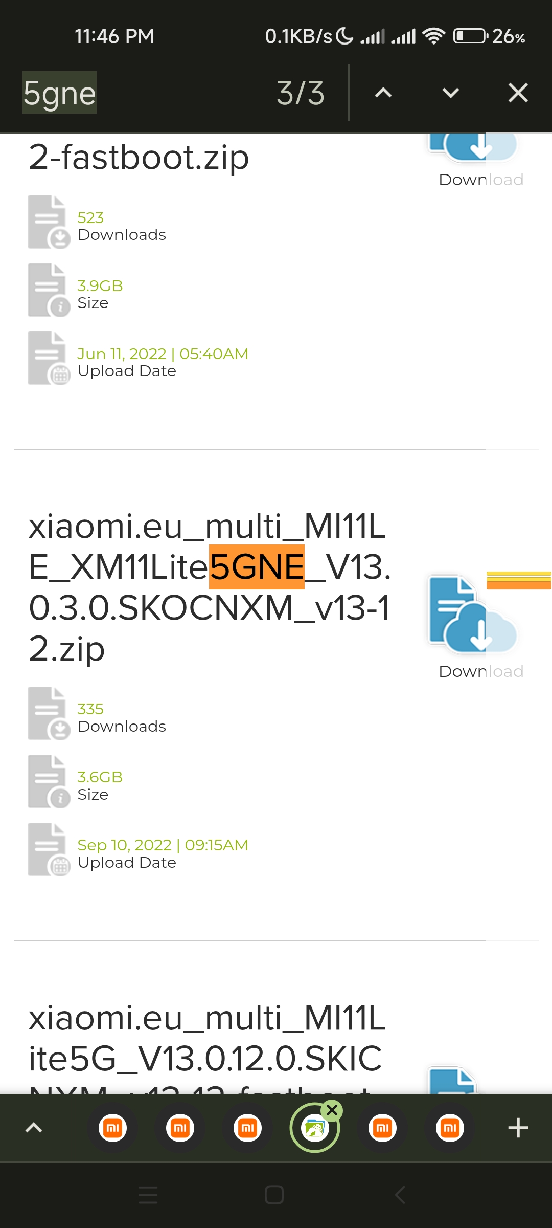

Hi, good morning, i have on my lisa device v13.0.2.SKOCNXM (STABLE) and the next one the MI11LE_XM11Lite5GNE_V13.0.3.0.STOCNXM_8833d413BE_v13-12.ZIP follows up. When i tried to download the next message shows up.
What i do???? i have stock recovery with open bootloader. If i click yes will brick de devce??
Thanks a lot.
By looking to the AFH (link from the post #1), subsequent Stable for Mi 11 5G NE (Lisa) is named exactly as that - see the screenshot:
xiaomi.eu_multi_MI11LE_XM11Lite5GNE_V13.0.3.0.SKOCNXM_v13-12.zip​
Download that zip (by browser).from the AFH server and leave it on your Internal memory, in Download folder
