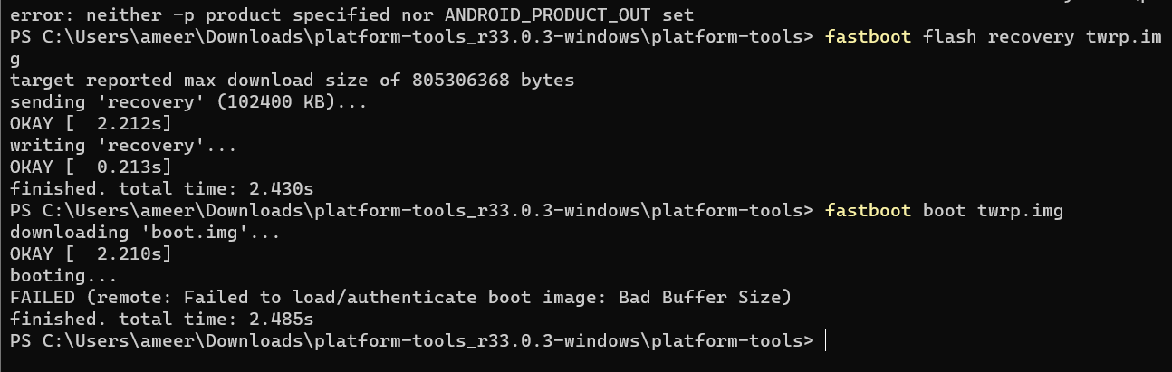

I have problem with installing TWRP on Xiaomi 12TPro , I got this error, can someone help me, or describe me how to install TWRP properly
Use the command:
Code:
 fastboot flash recovery_ab twrp.img
If you want to use only TWRP boot, you must use this version of TWRP with fastboot command.
BOOT / REC TWRP for some devices
For some devices there are different TWRPs available
1.) BOOT-TWRP -> fastboot boot twrp - boot TWRP only
2.) REC-TWRP -> fastboot flash recovery_ab twrp.img - install TWRP permanent
3.) BOOT-REC-TWRP -> you can use both fastboot commands -> see 1.) & 2.)
https://xiaomi.eu/community/threads/howto-install-recovery-image.66211/post-662483
# Error when booting in TWRP "Failed to load/authenticate boot image: Bad Buffer Size"

Use the command:
Code:
Code:
fastboot boot twrp.img
Nothing didn't work, still got bad buffer Size at the end ,when I try Fastboot boot recovery.img.
I got boot loop to fastboot.
I decide to flash Xiaomi eu custom Rom, after boot Rom, I try to go to TWRP and it was flashed.
I don't know if TWRP was install with Xiaomi Rom or.. I don't know what happened but TWRP was there
I had also that problem, after unlock tried to flash twrp but every time I get message Bad Buffer size!
After that i have flash Xiaomi.eu rom which have preinstaled twrp, so now i have twrp.

Use the correct command.
Code:
Thank u a lot. Flashing process is good.But when run"fastboot boot twrp.img",it says
E:\xiaomi flsash script\platform-tools-windows>fastboot boot twrp.img
Sending 'boot.img' (102400 KB) OKAY [ 2.183s]
Booting FAILED (remote: 'Failed to load/authenticate boot image: Bad Buffer Size')
fastboot: error: Command failed
it seems the img is not for Redmi k50 Ultra(diting)
