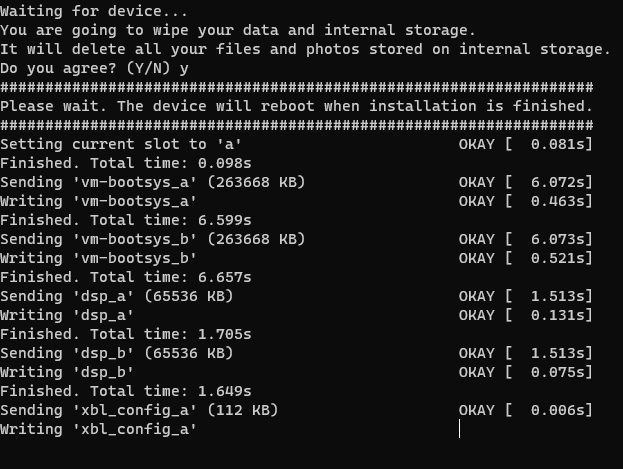

Second user in my group have this problem , but after flash Xiaomi eu Rom 13.0.7. in fastboot mode, boot Rom, and go to recovery, TWRP is there. I don't know why is this happening. But almost every user have bad buffer size and after flashing fastboot Xiaomi eu Rom 13.0.7. TWRP is flash and it's fully working. How is this happening, is Xiaomi eu Rom flash TWRP? A lot of users reports this ,that after failed to boot into TWRP and get bed buffer size. Xiaomi eu fastboot Rom solve TWRP problem.

Yeah! TWRP installed. The thing is, is in chinese! But I change language.
