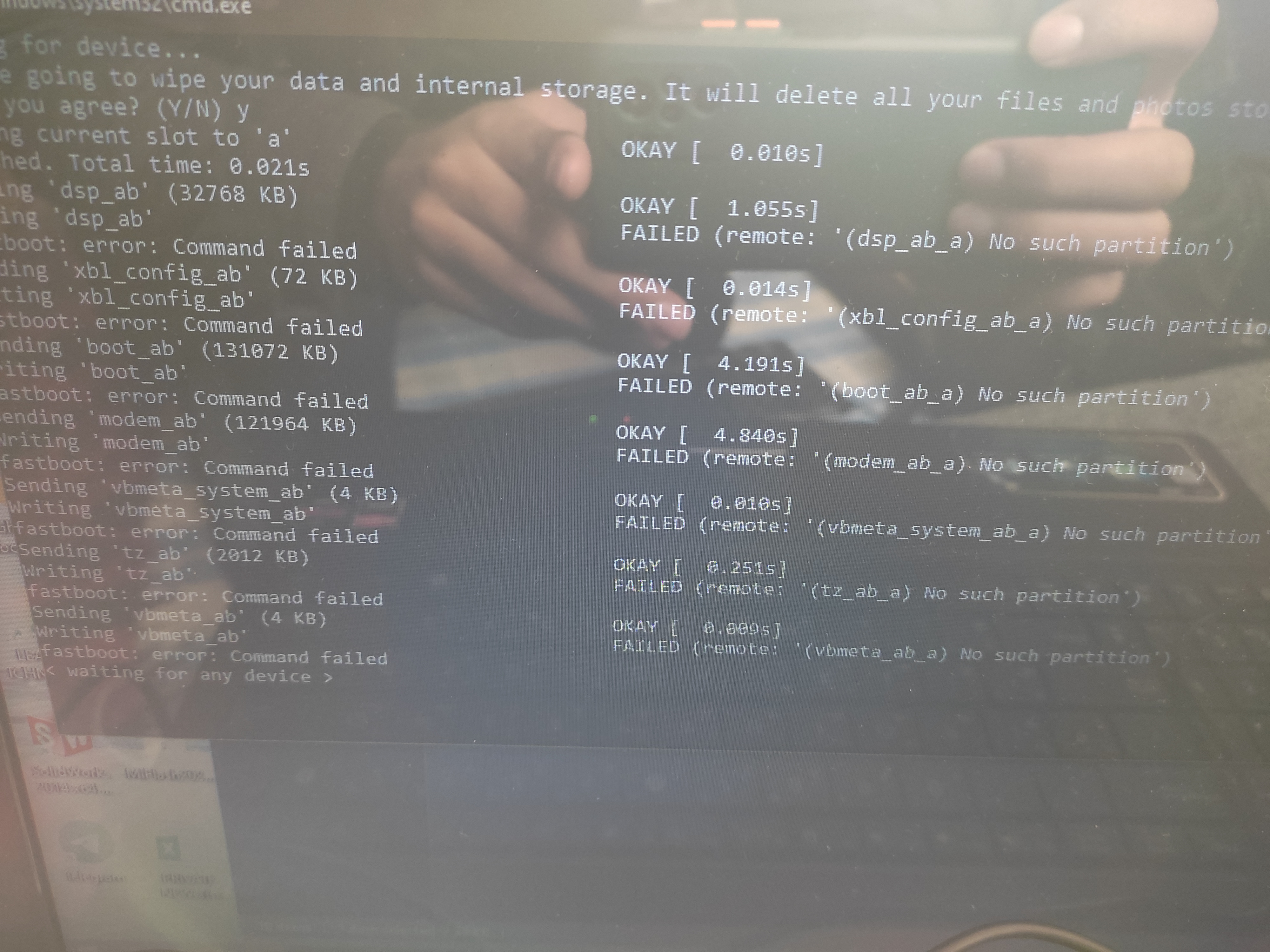

Im stuck on boot logo after restart the device i was using miui 13 global rom ,then i installed miui eu using windows_fastboot_first_install_with_data_format.bat and when reboot get stuck on mi logo

Ok clear.. New ROM coming soon..
Or fix installation script by yourself..
Open it in text editor and remove all _ab extensions..
Example:
boot_ab rename to boot
Post full installation log..
******** Did you mean to fastboot format this ext4 partition? Erasing 'metadata' OKAY [ 0.015s] Finished. Total time: 41.161s Erasing 'userdata' OKAY [ 0.249s] CreateProcess failed: %1 is not a valid Win32 application. (193) fastboot: error: Cannot generate image for userdata Rebooting It says like this at the end and then boots up to system but when i try to reboot, it gets stuck on mi boot logo.

i did the rom installed succesfully but when try to reboot it stucks on redmi logo on my redmi note 10
Example:

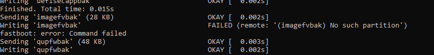

its work but installation stopped after writing 'cust' .. whats wrong?
Example:
