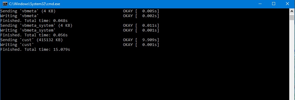

Any reason why 13.0.2 boots and then after a couple of seconds reboots into MIUI recovery? How exactly is this stable if it keeps restarting?
Code:
Setting current slot to 'a'                        OKAY [  0.011s]
Finished. Total time: 0.013s
Sending 'dsp_ab' (65536 KB)                        OKAY [  1.590s]
Writing 'dsp_ab'                                   (bootloader) Partition dsp_a flashed successfully
(bootloader) Partition dsp_b flashed successfully
OKAY [  0.193s]
Finished. Total time: 1.799s
Sending 'xbl_config_ab' (100 KB)                   OKAY [  0.012s]
Writing 'xbl_config_ab'                            (bootloader) Partition xbl_config_a flashed successfully
(bootloader) Partition xbl_config_b flashed successfully
OKAY [  0.006s]
Finished. Total time: 0.027s
Sending 'boot_ab' (131072 KB)                      OKAY [  3.200s]
Writing 'boot_ab'                                  (bootloader) Partition boot_a flashed successfully
(bootloader) Partition boot_b flashed successfully
OKAY [  0.405s]
Finished. Total time: 3.622s
Sending 'modem_ab' (279084 KB)                     OKAY [  6.766s]
Writing 'modem_ab'                                 (bootloader) Partition modem_a flashed successfully
(bootloader) Partition modem_b flashed successfully
OKAY [  0.844s]
Finished. Total time: 7.627s
Sending 'vbmeta_system_ab' (4 KB)                  OKAY [  0.002s]
Writing 'vbmeta_system_ab'                         (bootloader) Partition vbmeta_system_a flashed successfully
(bootloader) Partition vbmeta_system_b flashed successfully
OKAY [  0.002s]
Sending 'tz_ab' (3116 KB)                          OKAY [  0.083s]
Writing 'tz_ab'                                    (bootloader) Partition tz_a flashed successfully
(bootloader) Partition tz_b flashed successfully
OKAY [  0.010s]
Finished. Total time: 0.101s
Sending 'vbmeta_ab' (4 KB)                         OKAY [  0.005s]
Writing 'vbmeta_ab'                                (bootloader) Partition vbmeta_a flashed successfully
(bootloader) Partition vbmeta_b flashed successfully
OKAY [  0.002s]
Finished. Total time: 0.016s
Sending 'bluetooth_ab' (412 KB)                    OKAY [  0.014s]
Writing 'bluetooth_ab'                             (bootloader) Partition bluetooth_a flashed successfully
(bootloader) Partition bluetooth_b flashed successfully
OKAY [  0.003s]
Finished. Total time: 0.035s
Sending 'abl_ab' (204 KB)                          OKAY [  0.014s]
Writing 'abl_ab'                                   (bootloader) Partition abl_a flashed successfully
(bootloader) Partition abl_b flashed successfully
OKAY [  0.002s]
Finished. Total time: 0.033s
Sending 'dtbo_ab' (32768 KB)                       OKAY [  0.802s]
Writing 'dtbo_ab'                                  (bootloader) Partition dtbo_a flashed successfully
(bootloader) Partition dtbo_b flashed successfully
OKAY [  0.100s]
Finished. Total time: 0.921s
Sending 'featenabler_ab' (88 KB)                   OKAY [  0.009s]
Writing 'featenabler_ab'                           (bootloader) Partition featenabler_a flashed successfully
(bootloader) Partition featenabler_b flashed successfully
OKAY [  0.002s]
Finished. Total time: 0.025s
Sending 'vendor_boot_ab' (1560 KB)                 OKAY [  0.048s]
Writing 'vendor_boot_ab'                           (bootloader) Partition vendor_boot_a flashed successfully
(bootloader) Partition vendor_boot_b flashed successfully
OKAY [  0.006s]
Finished. Total time: 0.067s
Sending 'keymaster_ab' (272 KB)                    OKAY [  0.009s]
Writing 'keymaster_ab'                             (bootloader) Partition keymaster_a flashed successfully
(bootloader) Partition keymaster_b flashed successfully
OKAY [  0.003s]
Finished. Total time: 0.030s
Sending 'uefisecapp_ab' (124 KB)                   OKAY [  0.012s]
Writing 'uefisecapp_ab'                            (bootloader) Partition uefisecapp_a flashed successfully
(bootloader) Partition uefisecapp_b flashed successfully
OKAY [  0.002s]
Finished. Total time: 0.023s
Sending 'qupfw_ab' (56 KB)                         OKAY [  0.004s]
Writing 'qupfw_ab'                                 (bootloader) Partition qupfw_a flashed successfully
(bootloader) Partition qupfw_b flashed successfully
OKAY [  0.002s]
Sending 'xbl_ab' (3480 KB)                         OKAY [  0.083s]
Writing 'xbl_ab'                                   (bootloader) Partition xbl_a flashed successfully
(bootloader) Partition xbl_b flashed successfully
OKAY [  0.023s]
Finished. Total time: 0.114s
Sending 'cmnlib_ab' (388 KB)                       OKAY [  0.012s]
Writing 'cmnlib_ab'                                (bootloader) Partition cmnlib_a flashed successfully
(bootloader) Partition cmnlib_b flashed successfully
OKAY [  0.004s]
Finished. Total time: 0.034s
Sending 'cmnlib64_ab' (504 KB)                     OKAY [  0.023s]
Writing 'cmnlib64_ab'                              (bootloader) Partition cmnlib64_a flashed successfully
(bootloader) Partition cmnlib64_b flashed successfully
OKAY [  0.003s]
Finished. Total time: 0.043s
Sending 'devcfg_ab' (56 KB)                        OKAY [  0.012s]
Writing 'devcfg_ab'                                (bootloader) Partition devcfg_a flashed successfully
(bootloader) Partition devcfg_b flashed successfully
OKAY [  0.002s]
Finished. Total time: 0.031s
Sending 'hyp_ab' (436 KB)                          OKAY [  0.014s]
Writing 'hyp_ab'                                   (bootloader) Partition hyp_a flashed successfully
(bootloader) Partition hyp_b flashed successfully
OKAY [  0.003s]
Sending 'imagefv_ab' (2048 KB)                     OKAY [  0.063s]
Writing 'imagefv_ab'                               (bootloader) Partition imagefv_a flashed successfully
(bootloader) Partition imagefv_b flashed successfully
OKAY [  0.007s]
Finished. Total time: 0.087s
Sending 'aop_ab' (200 KB)                          OKAY [  0.016s]
Writing 'aop_ab'                                   (bootloader) Partition aop_a flashed successfully
(bootloader) Partition aop_b flashed successfully
OKAY [  0.002s]
Finished. Total time: 0.039s
Sending 'cust' (415132 KB)                         OKAY [ 10.060s]
Writing 'cust'                                     OKAY [  0.000s]
Finished. Total time: 10.078s
Sending sparse 'super' 1/8 (721168 KB)             OKAY [ 17.550s]
Writing 'super'                                    OKAY [  0.000s]
Sending sparse 'super' 2/8 (786336 KB)             OKAY [ 19.463s]
Sending sparse 'super' 3/8 (786332 KB)             OKAY [ 19.263s]
Sending sparse 'super' 4/8 (767572 KB)             OKAY [ 18.593s]
Sending sparse 'super' 5/8 (785968 KB)             OKAY [ 40.335s]
Sending sparse 'super' 6/8 (760124 KB)             OKAY [ 18.463s]
Sending sparse 'super' 7/8 (725144 KB)             OKAY [ 17.683s]
Sending sparse 'super' 8/8 (317744 KB)             OKAY [  9.931s]
Finished. Total time: 167.117s
Setting current slot to 'a'                        OKAY [  0.012s]
Finished. Total time: 32.141s
Rebooting                                          OKAY [  0.000s]
Finished. Total time: 0.201s

mi 11 pro - stable - i saw at youtube that someone run the "rom file.bat" as administrator and not with the cmd , is it possiable ?
