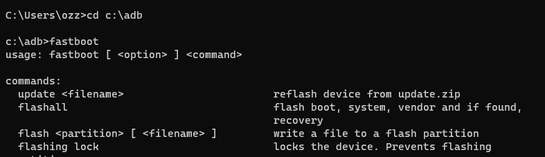

Hi. I have mi13 pro phone.
i have installed (not by me, by store i guess) MIUI by xiaomi.eu 14.0.14.0.tmccnxm
i faced with issues with gpay and want to update.
i tried two options:
-Check for updates (in updater)
- download
- install
-Download xiaomi.eu_multi_NUWA_V14.0.28.0.TMBCNXM_v14-13
- put it in phone storage
- chose update package (in Updater)
- confirm
after both options i'm notified that device will reboot to recovery and install package but i'm ending in MIUI Recovery without updating.
could you tell me what am i doing wrong? or what i suppose to do get latest update with working gpay
thanks in advance
thanks in advance
You don't seem to have TWRP installed. The easiest solution is to follow instructions for fastboot install (first post, or search the forum for detailed guides, including required drivers).
You do not have TWRP installed.
You either install TWRP or update with the "fastboot method".
Reactions: JiaiJ
You don't seems to have TWRP installed. The easiest solution is to follow instructions for fastboot install.
i tried to move in this direction also.
- i switch my phone to fastboot (i see fastboot text on the screen)
- i connect it to PC
- i run script from the unzipped folder
- i get "waiting for device" message
i tried to figure out what to detect it (unzipped adb and platform tools folders on C:\) but this process was not clear for me so i could maybe do smth not correct here
Only Magisk without additional modules. Of course Magisk under a changed name
Okay, thanks! I'll try, I think I might have an idea what I did wrong now. Btw, I can't find Google pay in the list of processes from magisk hide, only Google wallet
you lack the necessary drivers on your PC.
Install Tools and Drivers
- install USB drivers & adb and fastboot tools (Windows 10)
- install SDK Platform Tools (Windows 10 & 11 / Mac / Linux)
- install xiaomi drivers (sometimes necessary)
-> a small [howto] if you have driver issues
i've done those steps and will try that things from howto video now.
but could you please confirm if i can do this (see the picture) it means that i installed adb and platform tools correctly?
