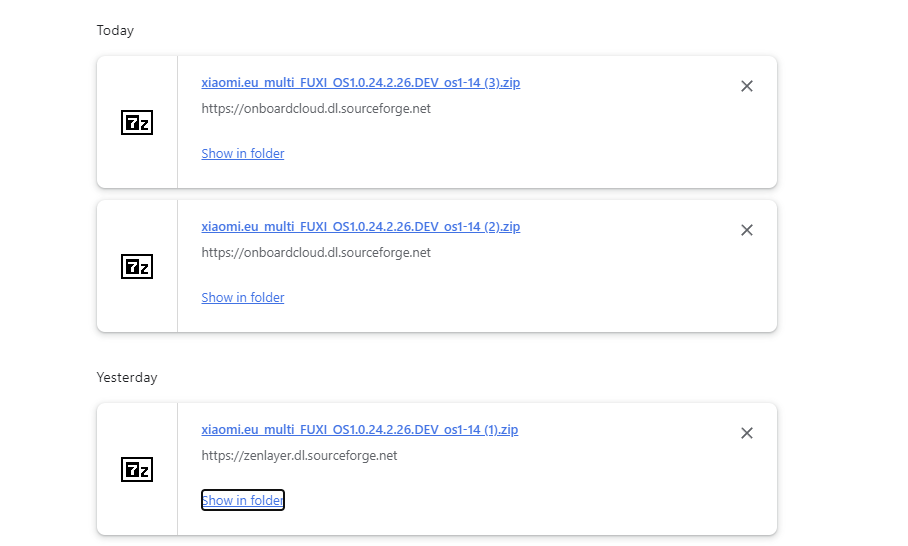

links for 13ultra is not wo
rking, actual downloaded file is for xiaomi13. please help to update
thanks!!
this is my test. i´m going to apply the patch but i don´t know the cache that i must delete. Play Store? Google Pay?
best regards

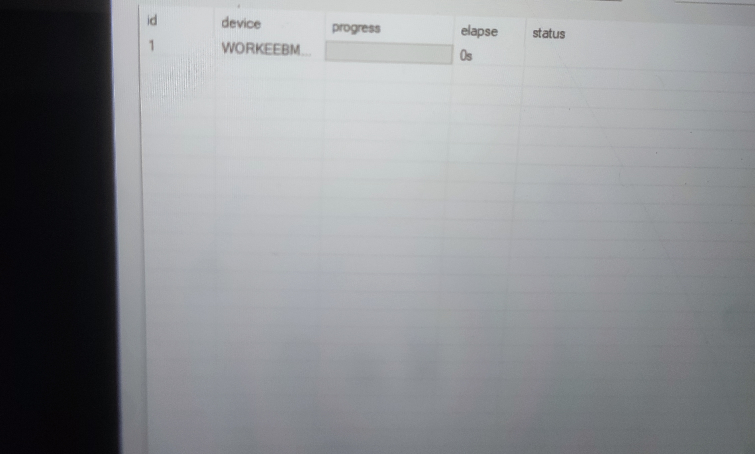

I don't know where else to ask this, so I'm sorry if this is not supposed to be asked in this thread...
My device shows up as WORKEEBM7HPNYPT4 in fastboot and in Mi Flash Tool(photos attached). I am trying to flash a stock MIUI ROM on Redmi Note 10s.
I really need to understand if this is normal or there is something I should do differently.

Your device is probably connected successfully. It doesn't matter what name the device is connected to (because the code name of the device is not written there). If you want to be even more sure, check that device manager >> android bootloader interface appears.
