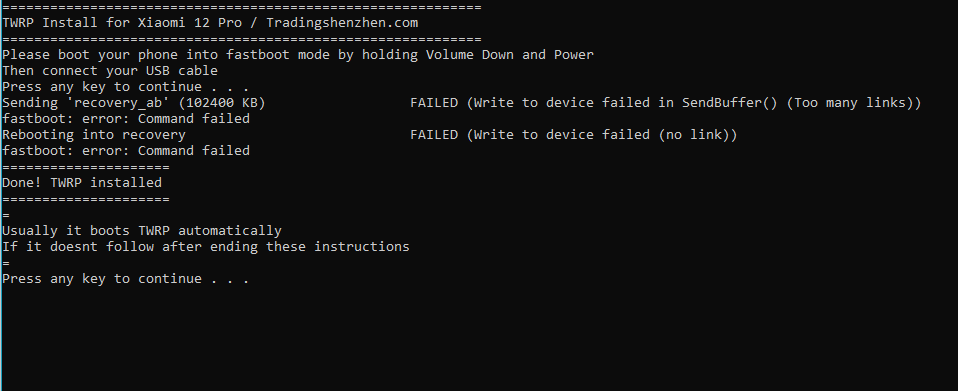

I can't get TWRP installed to 3.7.0_12
can I have some more help or suggestions please?
want to upgrade MIUI from14.0.4.0 to 14.0.8.0 but my sd says it's 0MB
The TWRP you are trying to install is for Android 12. MIUI 14 is Android 13. Update it using the Fastboot method
