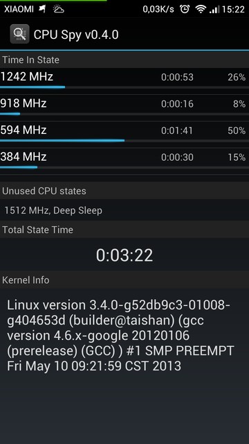

Install CPU Spy. CPU is definitely maxed to 1242. I'm sure.
i repeat...with power saving mode cpu frequency is maxed at 918mhz...as proof a print of your loved CPU spy with timers resetted then I played a bit to carmageddon and some multitasking switching between several apps opened...
now hoping that you finally thrust me, imo, to improve the smoothness you could try to increase min frequency from 384 top 594mhz instead maximize it to 918/1242 cause it should be more battery friendly
Im, sorry but you're still wrong. You flashed 918 Mhz mod or its not working for you. I manually compiled my rom with 1242 init.d script and as I said im sure that max CPU is 1242 Mhz.
It have to be because:
Code:
echo "1242000" > /sys/devices/system/cpu/cpu0/cpufreq/scaling_max_freq
writes 1242 Mhz into system scaling_max_freq file.
I reset timers in CPU Spy, turned Power saving mode and played Cut The Rope. As you can see 1242Mhz is used.
Code:
lol in post #7 you were not talking about the stock power saving mode?
In post #7 I wrote my observations about 1242 Mhz mod. And I was wrong just about Normal and Performance mode because CPU is locked to 1242Mhz in every power Profile.
The Power Saving mode works as I said few times. The max CPU is set to 1242 Mhz. And... I'm still talking about Wajk mod.
Stock power saving mode goes max to 918Mhz. But with this mod its 1242Mhz.
