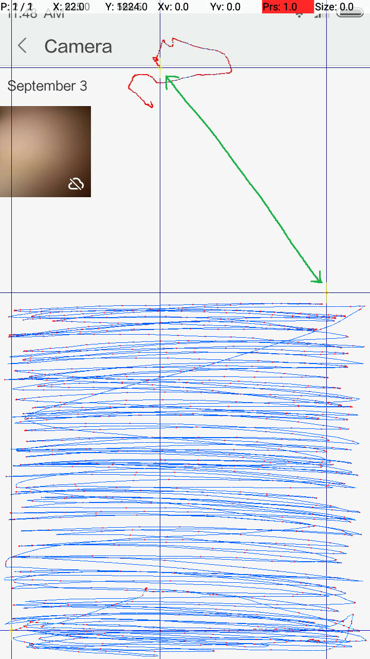

I've encountered a bug that whenever I press the screen at the same time I release a long press, the long press won't release it, instead keeps pressed until I release the second or press at anywhere else on the screen (which will make the press drag to this new point).

The problem with the long press seems to happen within the colored area in the screenshot and that the second press however, has to be somewhat at a minimum distance apart from the long press, but can be pressed inside or outside the colored area (the green arrow is close to the minimum distance), but may also happen at the upper side of the screen at the right side.
