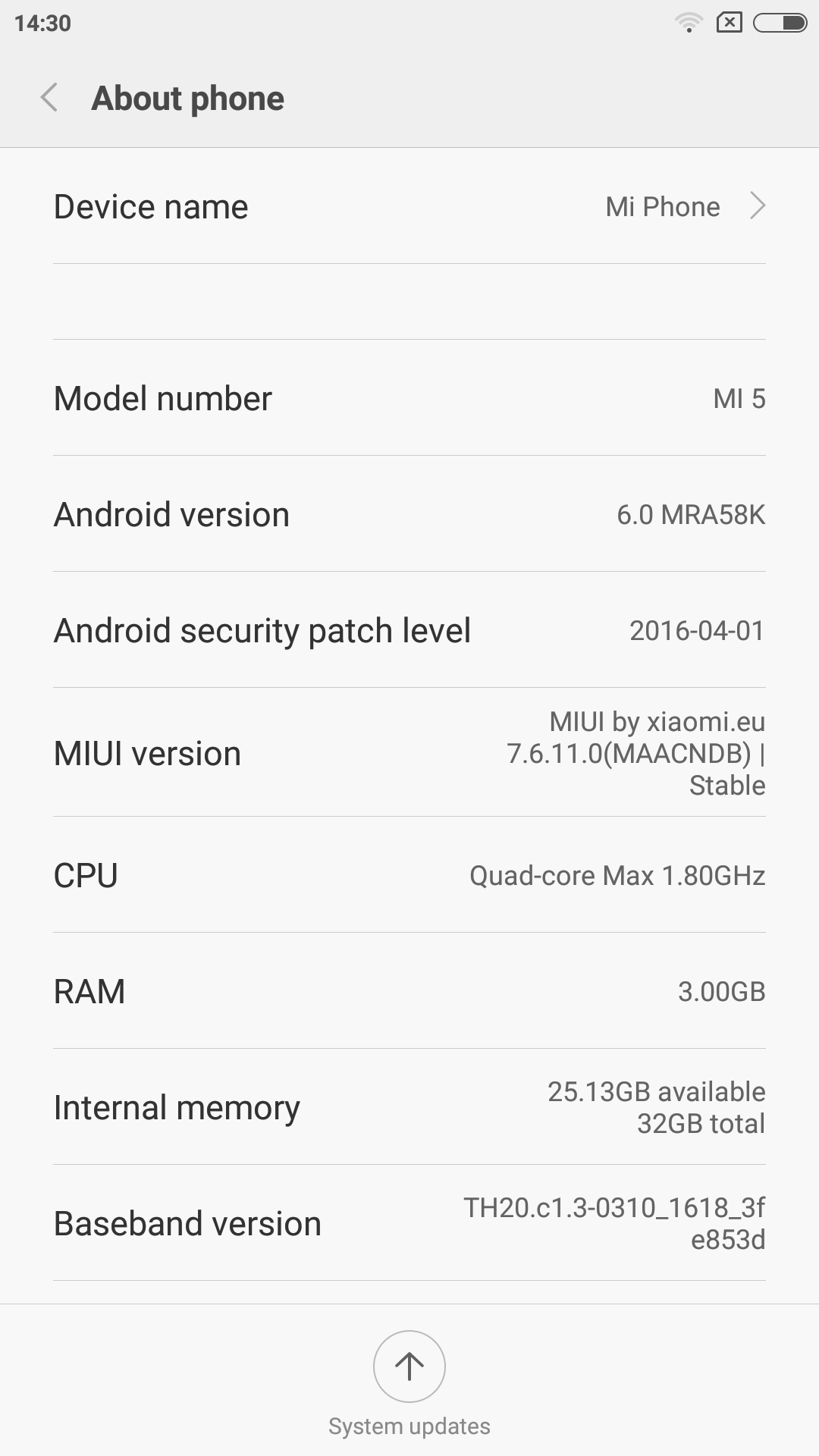

    My mi5 just arrived, I had been looking at this site to see how to install the EU Tom which would be a bit scary for me, however,
    My phone has arrived from ******* and it seems to have the EU Tom already installed, is there any way to tell if this is good? Screenshot_2016-09-27-14-30-20_com.android.settings.png

    its FAKE ROM... not our.. we never released this version...

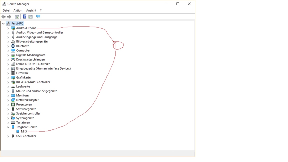

    ADB has nothing to do with unlock, are all drivers installed correct?
    In Win10 it looks like this:
