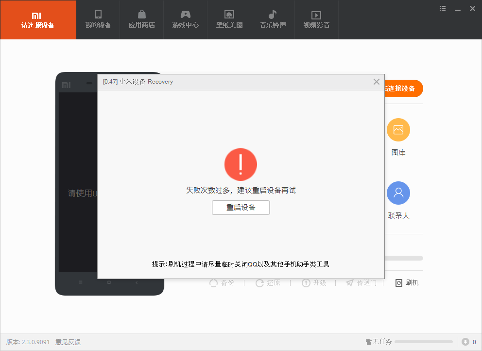

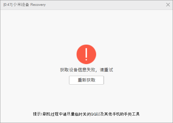

Feronix
Mar 27, 2016
26
@Feronix if you have problems at 5:25: do you have the correct rom? try en.miui com/download-320.html#463
When I get stuck at 5:25 it's simply because Mi PC Suite doesn't recognize my phone. I simply get this error (if anyone could translate this I'm sure it might give some insight):

Armator
Jan 11, 2017
View attachment 15029 View attachment 15030
What do you mean "it took some tries to get PC Suite to recognize the device"? How did you eventually get it to show? I'm dying to know cause all I get are the above errors. English PC suite tells me "please boot normally first", Device manager shows it as Qualcomm 9008, but MiFlash doesn't see it at all and ADB can't find the phone either.
Do you have the adb drivers installed? I think it might related to the drivers that you are using. My phone showed up as Android Device -> Android ADB Interface.
It was neccesary to unplug it a few times before Mi PCsuite recognized my phone.
Once connected to Mi PC Suite, a window pops up, inidcating which ROM is installed on your phone. You need exactl the same one to proceed (shown in Minute 5:29 in the video in 6;45 where he chooses the file).
Reactions: Feronix
Feronix
Mar 27, 2016
26
Did install the ADB drivers and I think they also come with the Mi PC Suite (driver signatures turned off in Windows). Is it possible I have the wrong drivers? If I boot it normally (or in fastboot mode, can't test now) it does show up as Android ADB Device in my computer's device manager, except the phone doesn't get past the Mi logo.
I'll try re-plugging the phone in Mi PC Suite, did you get any errors before you got it to work? Could a Deepflash cable help me out with this?
I thought you could just use the recovery ROM? Either way I don't even get to the point of selecting a ROM as it refuses to connect the phone.
