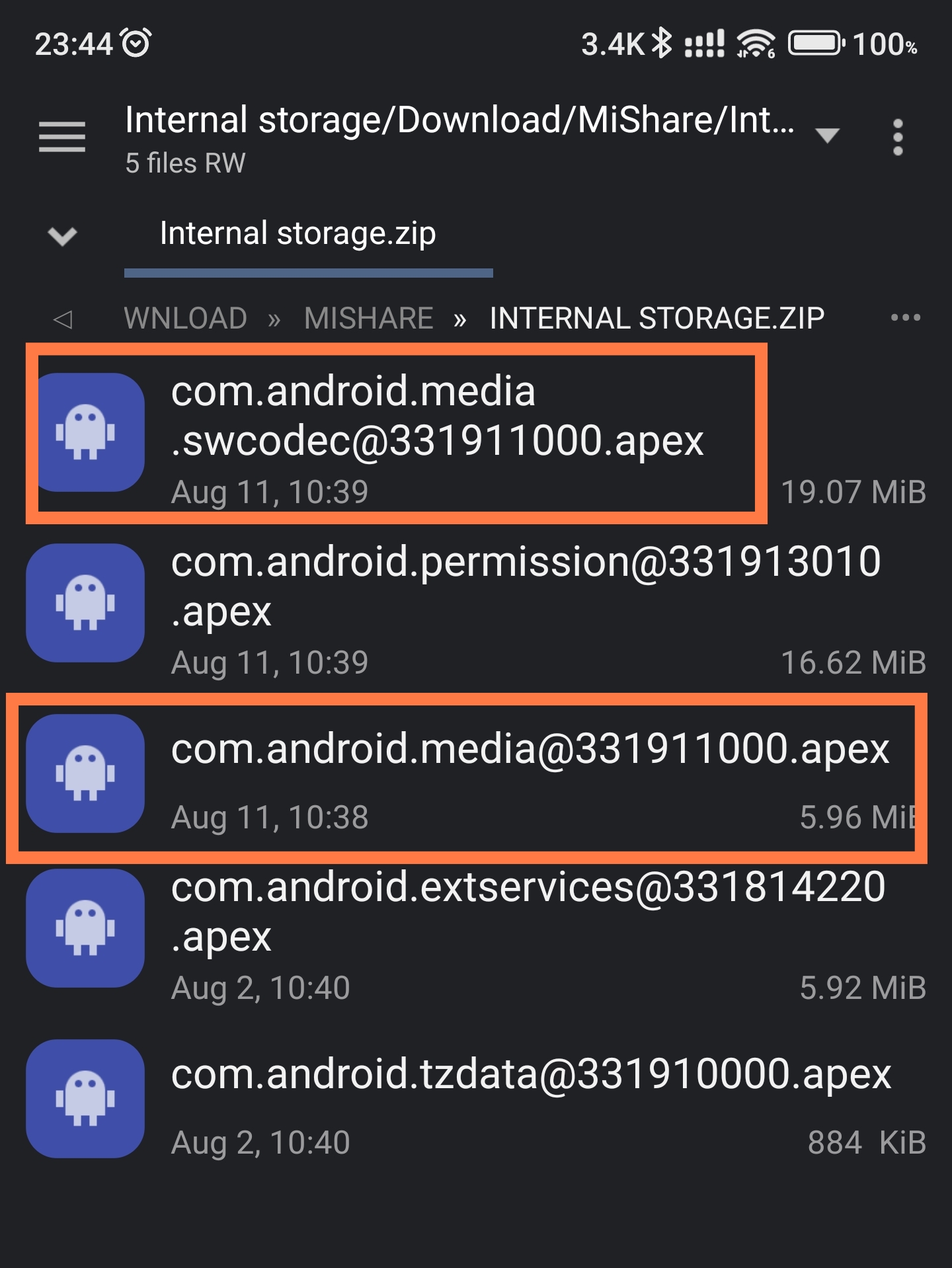

Ishtar 14.0.16.0, deleting file (with different numbers at the tail end of the filename) worked!! Camera and Firefox working as expected again! Thank you so much!!

I have cleaned a "/data/apex/active/com.android.media.swcodeҨ340818112.apex" once again today, my Mi13 didn't play mp3 file for ringing.
This problem of Google play store was solved, in a weekly version of Rom ?
I managed to restore mp3 ringtones and custom notifications by deleting another file too
/data/apex/active/com.android.media.#########
Everything works again.

I use Redmi K60 Pro (socrates). I wanted to install roms only with Fastboot. But this big "bug" forced me to install TWRP. I still only have a workaround by delete the com.android.media.swcodec*** file.
Sometimes the file comes back. It felt more often when i restart the phone.
After deleting the file the phone is usuble but these "small" bugs left:
- HEIC images at camera dont work, x265 videos work but there seems to be a problem with the timestamp so the sorting in gallery is broken
- send videos via WhatsApp dont work, images work (update: playable when com.android.media.* also deleted)
- music is not playable (update: playable when com.android.media.* also deleted)
My personal Recommendations:
- if the file *swcodes* comes back and you have the problems dont use filemanager to do anything. I think it can do data lost. Go to. TWRP and delete file first.
- do not copy any other *.apex files in ../active/ folder. For me no of the "small" problems solved.

have you deleted both? com.android.media.swcodec* and com.android.media.*
