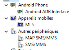

I have done what you said, and I think the drivers are OK now :
In MiFlash : Capture8.PNG
But I still have the same message...
Read the first post, you dont flash it with mi flash, its just for the drivers. You select the .zip file from within Mi Pc Suite..
Sent from Mi 5
Sent from Mi 5

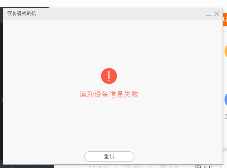

He's showing you that its working in MiFlash which means the drivers are good but not in Mi suite. Im having this same issue aswell
I dont know why the Mi PC Suite can not read your model, but its the only way so far. Maybe the OS version is so screwed so even the Suite can not get it right.. For me, i tried 5 phones, with different OS versions, they all worked without any problem..

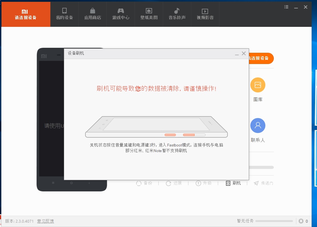

when i press the SHIFT key an klick on this icon, i get this pic... an i can not browse for the FW... ????
