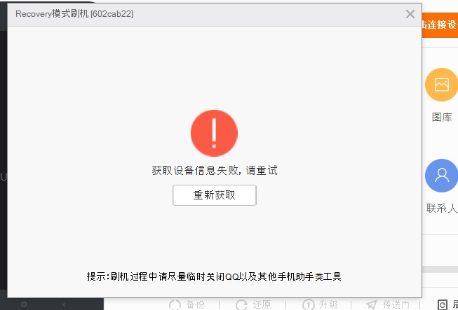

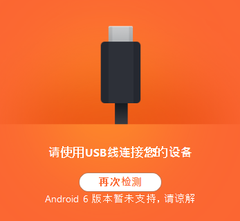

I don't think it says about the signature, it does not recognize my Mi5 at all (i now tried with ENG version but the same thing):
okay on my other pc the program shows me this picture: see attached.
So am i right, when i guess i first have to flash the original chinese rom ?

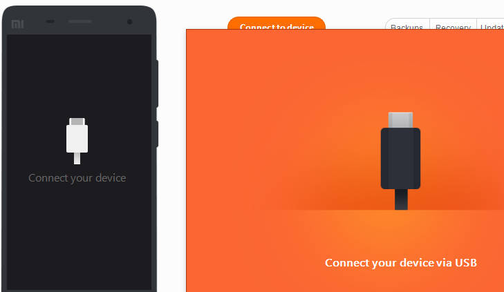

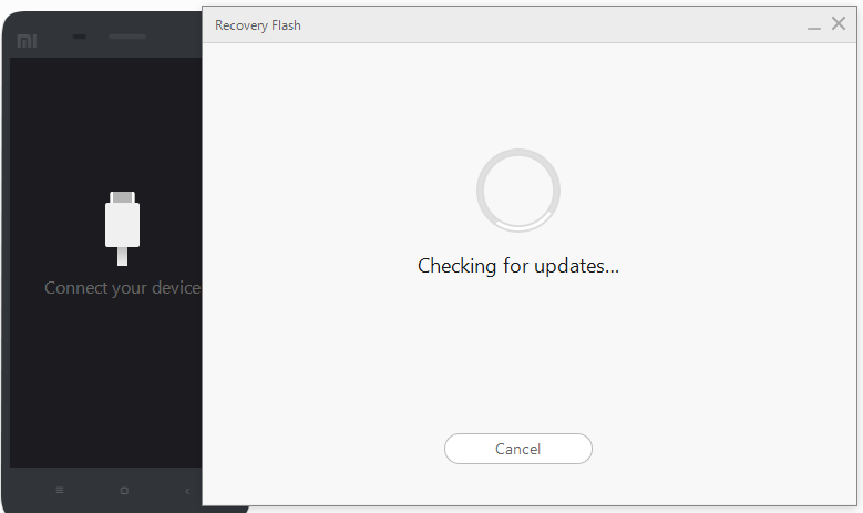

When i hit retry few times it behaves like i disconnected it physically (but i did not, its still connected on USB) i can heard usb disconnect sound and then connect and i can see the animation on the phone itself like the usb has been unplugged and then plugged back. After few time like that it continues to circle with checking for updates...
I even clicked X o that windows and tried with Shift and Update R, it now does not give me the window to chose the file but it brings back the looping animation and checking for updates...
I will leave it like this for a while, something might happen :D

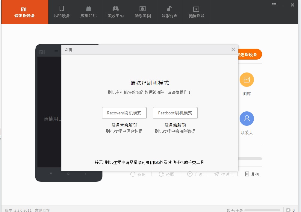

Its written in the first post, to hold Shift while pressing on the R. Update button, so it will open explorer to choose the .zip file. This here i dont understand what it says.
Sent from my MI 5
okay doing this a new window pops up where i have to choose something between recovery or fastboot.
well.. after few hours nothing happened... phone is still on recovery screen and not being recognized bz the suite.

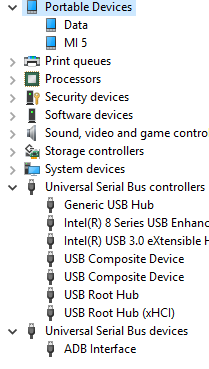

Can someone verify to have this working on Windows 10 x64? And screenshot of any drivers from device manager would be nice to have to compare with?

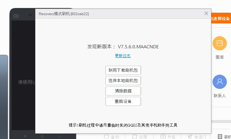

Can somebody explain what this picture mean ?
It pops up, when cklickung the shift and the flash button

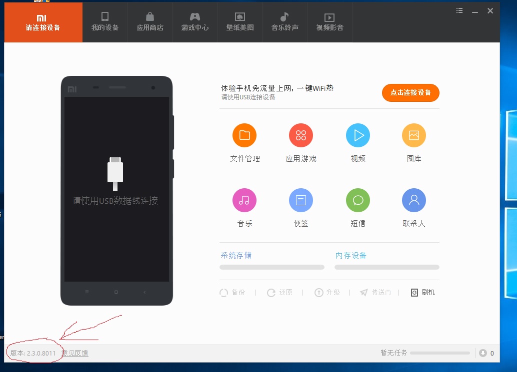

okay, xiaomi seems to have updated their program ( see attached image, with the red marked vers. number)
perhaps here is the failure
can somebody send me the version ...4071 ?

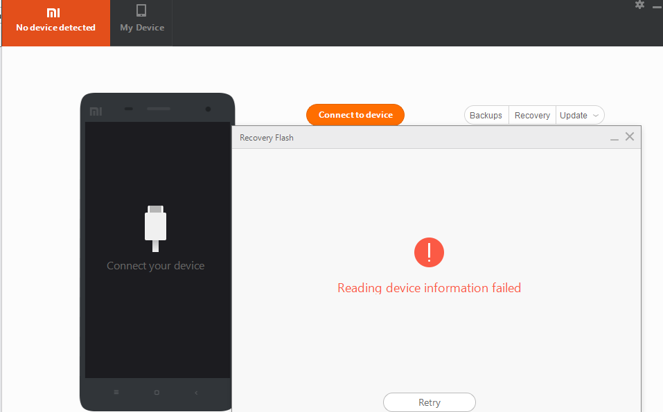

Yes Mike, i noticed the same behaviour, new version from CH. However the ENG one still offers to sideload file when you hold "shift" while Pressing the "R. Flash". Not sure if that's enough for you, i get error reading device :(
