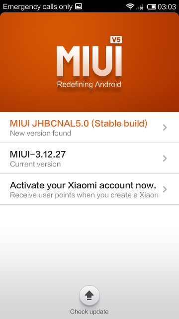

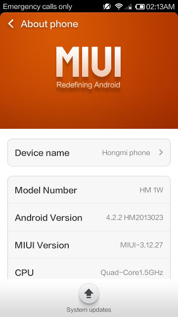

MIUI is this version:

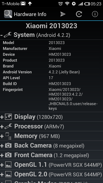

Current version from hw info:
CWM:

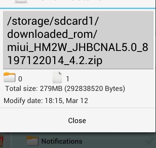

Update downloaded automatically:
Can anyone explain the versioning system, I'm confused :)
JHBCNAL5 vs 3.12.27?
What is the difference between the version phone came with, the one from updater and the multi rom here from the dedicated thread?
I'd like to get rid of the chinese keyboard, how do i do that?
I am considering to flash english CWM via Mobileuncle tools and then multi rom.
Thank you

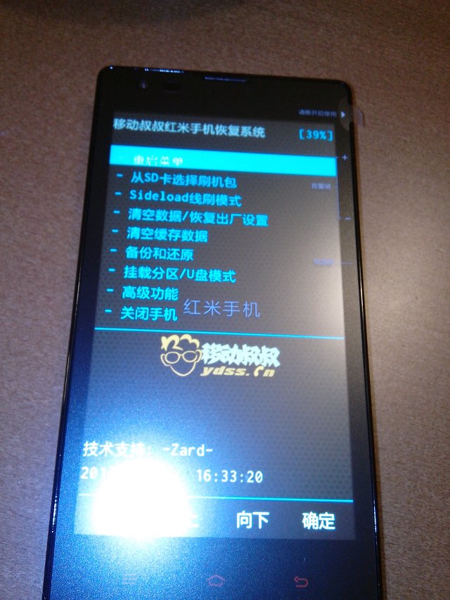

A problem: after flashing recovery via mobileuncle, I cannot boot to recovery, phone show some garbage for a second and then boots normally.
Any ideas?

#10
Sorry, doesn't work for me :-(
Tried twice, flashed ok with SPflash tool, phone works ok, stock e3 recovery good.
Tried rooting with vroot and framaroot, everything well until I flash the CWM recovery.
Every time the same thing - for a second or two garbled graphics on top of the screen and phone resumes stadnard boot.
I guess it tries recovery, fails and continues with normal boot.
Any ideas what could be wrong?

#12
It's good to know that.
Seems this CWM simply doesn't work with my device.
I wanted some recovery and ended up last night with TWRP from other thread.
Flashed via original recovery, works well, ROM is finally up and running :)

#13
Cwm uploaded here is outdated. New phones coming with a differrent lcm module and current cwm doesnt support it.
Use twrp instead of cwm cuz it built with latest kernel supports new lcms.
Also many new phones will not be flashed or will be BRICKED by jhbcnah1.0 flashtool image. In such case new jhbcnal5.0 flashtool image with new bootloader needed.
