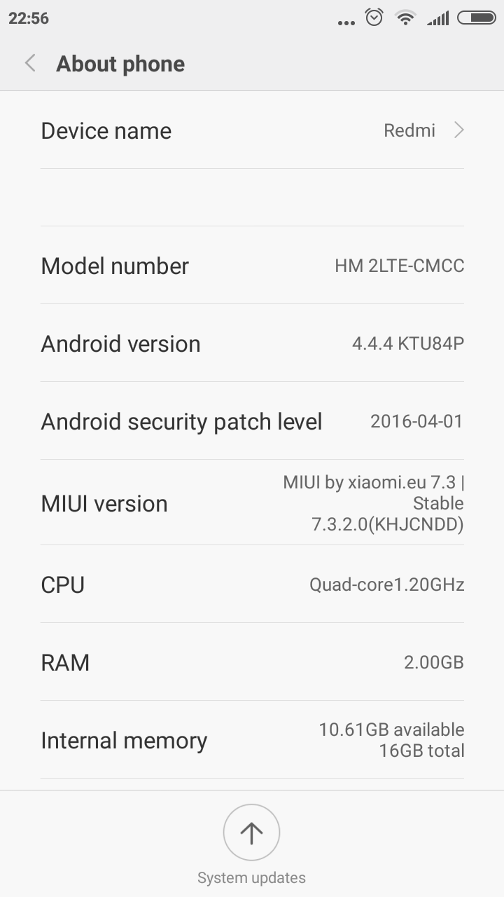

BIG THANKS to everyone participating in this thread!
Updated kids phone to stable 7.3 without any problem.
The biggest hassle was waiting for the backup to finish; that is because he had plenty of games and other apps installed; actually had to ask him to delete quite a few to speed things up :)
Just for the reference, and for people reading this topic at a later date.
1) Installed adb & fastboot via in Debian, from official repositories:
sudo apt-get update
sudo apt-get install android-tools-adb android-tools-fastboot
2) Enabled USB debugging, and OEM unlock in Settings/Advanced settings/Developer options/
3) Made a backup using built-in backup app.
4) Downloaded TWRP from the "ROMs download" page, connected phone to PC, and issued the following commands:
# to see if the phone can be seen from PC
adb devices
# to spare fiddling with vol dwn + pwr buttons
adb reboot bootloader
# made oem unloch, cleared cache
fastboot oem unlock
fastboot boot twrp.img
# Selected options to wipe data in TWRP
5) Rebooted the phone
fastboot reboot
6) Loaded v7.3 ROM to phone, and selected the file within the updater app.
7) After the new ROM has been installed I restored from the backup.
Thats it. Worked like a charm.
THANKS !!!!!!!!!!!!!!!!!!!!!!!!!!!!!!!!!!!!!!!!
