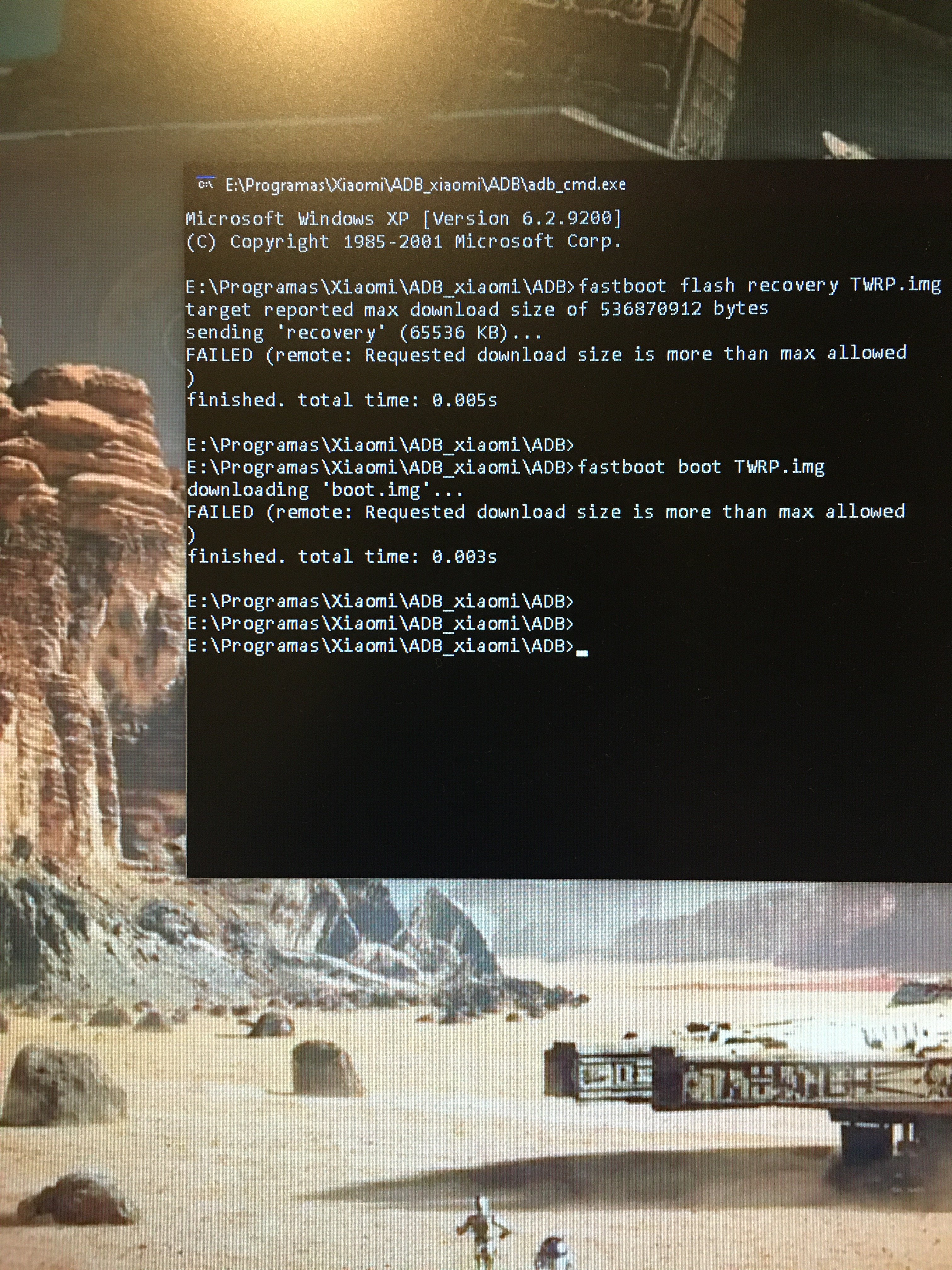

At the moment of wanting to go to the stable version of miui 11, it rebooted and I stayed on the fastboot screen, the black screen comes out when I want to use miflash or miflashpro, and when I try to use adb I get the following image what is the solution? has a solution? :( thank you very much

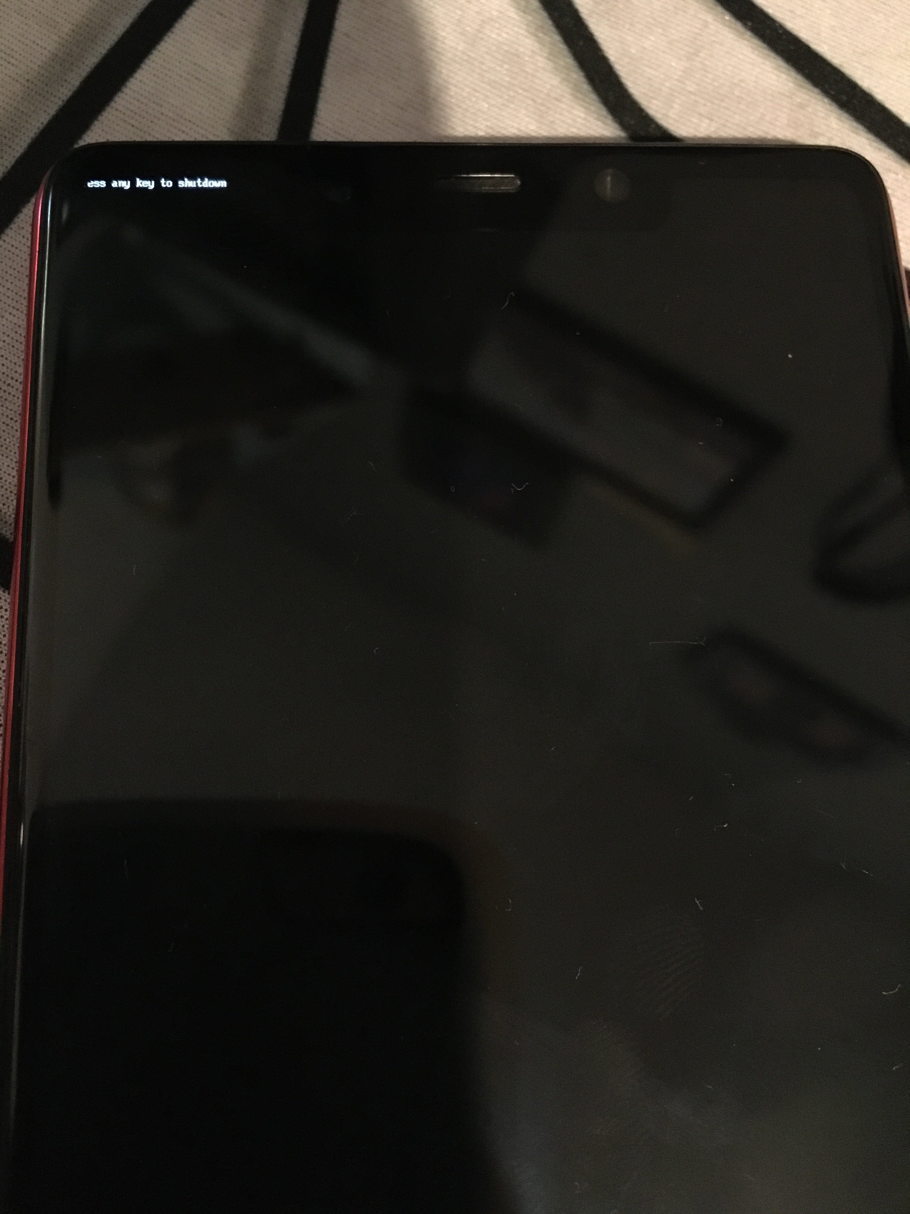

Reflash fastboot official rom via miflash to reset the phone.
when I use miflash at the moment of using refresh, the black screen appears with the letters "press any key to shutdown and I can't flash it, it resets fastboot again, and if they have unlocked bootloader
change USB output plug and try on another computer.
Do you use AMD CPU? If yes i have the same problem with my main pc and fastboot commands doesn't work. So if you have a old Intel pc you can use it to flash. I solved this with my old i5 notebook.

Thanks to everyone, I made it work with a PC with intel, I just can't install the stable rom, so I spared a little more but thanks
