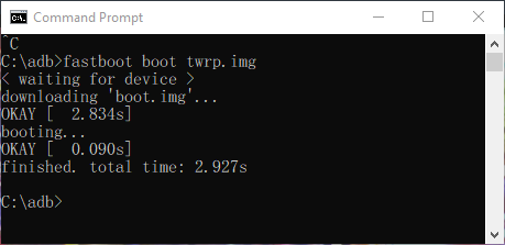

Thanks for responding. I managed to boot into recovery through fastboot (by downloading it as a boot.img). For some reason mauronofrio's worked, but chinese TWRP didn't. I flashed 12.1.3.0 again, but then I couldn't restore my nandroid backup because of an extracttarfork error 255. But my userdata did get wiped.
I wanted to restore through chinese TWRP, but it couldn't decrypt storage no matter what I tried, until I booted into the rom (which had no userdata at this point) and was able to remove the lockscreen password. Then I could access my storage in chinese TWRP and I was able to restore my nandroid.
Strange experience all in all. It's a mystery to me why 20.10.30 would mess with recovery..
While I got everything working again, it has now become impossible to decrypt storage, unless I set a pattern pin or remove the phone password entirely.
It's a bit absurd, because this combination was working fine on the same rom (stable 12.1.3.0) before I tried to move to weekly.

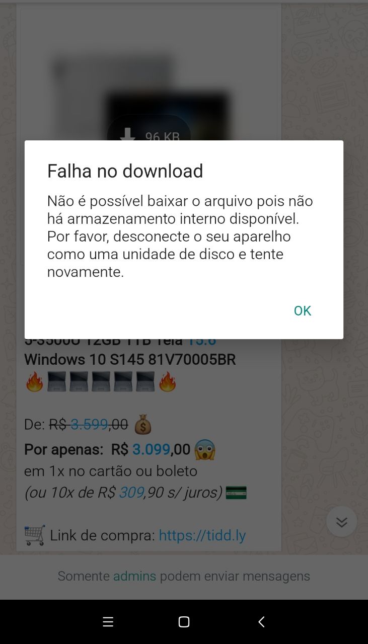

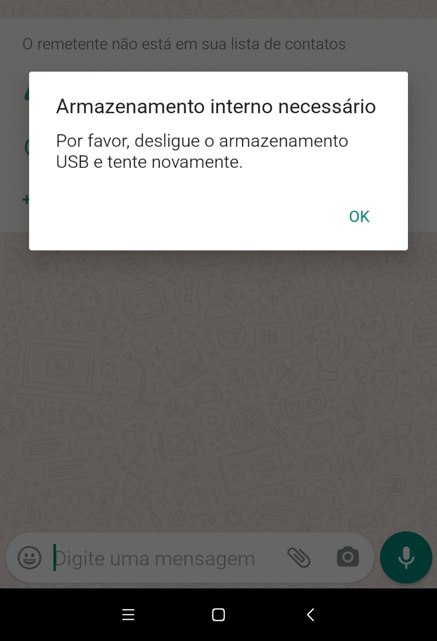

Guys, I have a Mi 9T, using a MIUI.EU for some time, but I have a great difficulty to migrate to the version with android 11.
Whenever I update the phone, it has a problem without storage, it happened with 20.10.22 and now with 20.10.30. However with 20.10.17 (android 10) everything works perfectly. It is as if my device had no more space. I can no longer send or receive media (audio, images, videos) by whatsapp. The camera does not save photos. Several apps, including the miui itself, close on their own, such as the app that shows the use of space on the cell phone.
I've tried everything: format data before and after installation, install using TWRP, Orange fox, OTG, etc. but the problem is the same.
Another detail the "disk" is decrypted in recovery, but when I install MIUI.EU, any version, it encrypts again ...
Can someone help me?
Do you use dual apps?
If so delete all dual apps and dual app account
