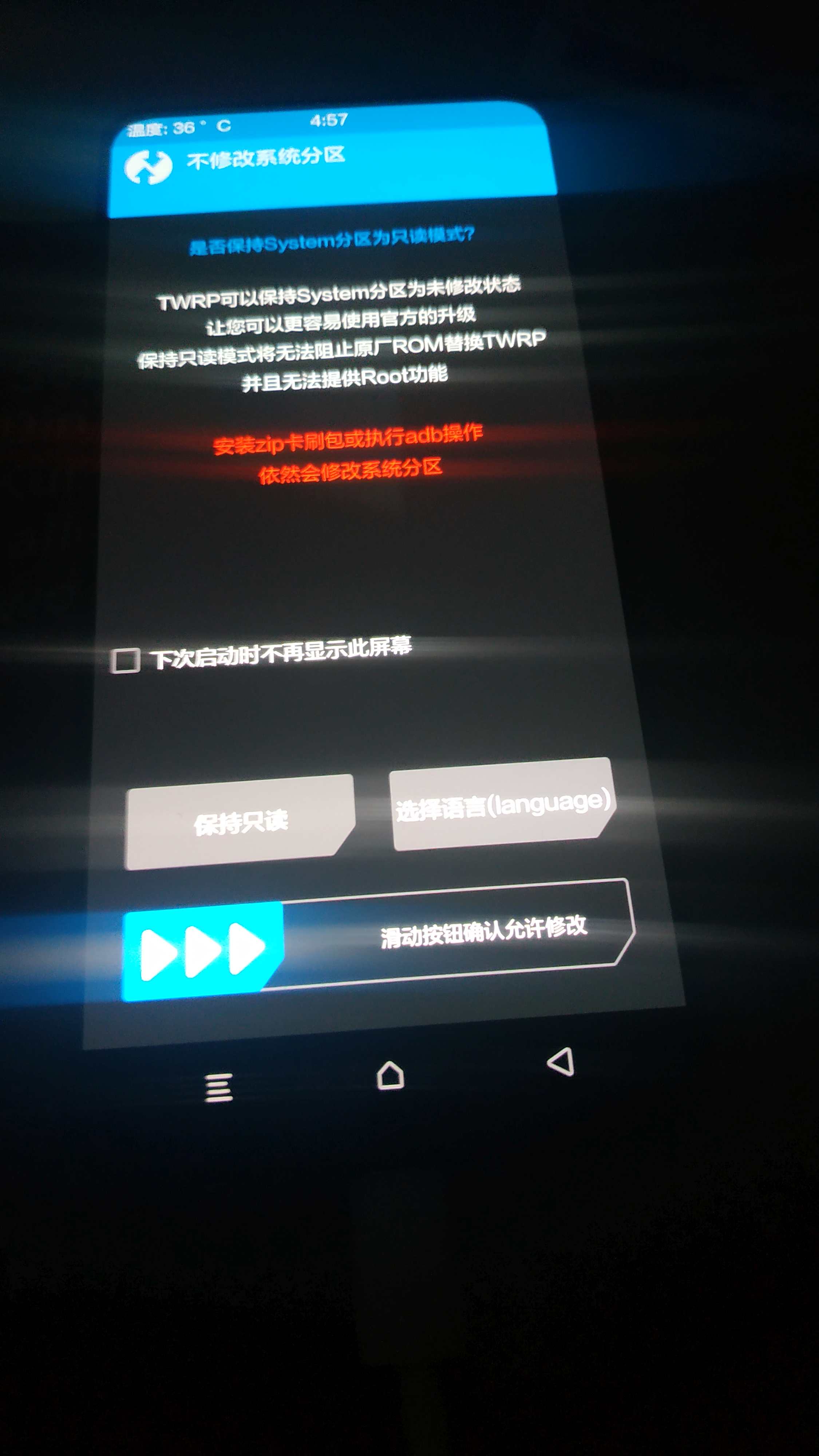

I knew about the issue and was using only fastboot. tryed again with this version of twrp no use. it installs twrp without problem, but wenn i am one the screen, i cant swipe to unlock or do anything.

i am also stuck tried 20.10.29 on a poco f2 pro, couldnt install error and got stuck in bootloop. after severall tries i got back into twrp. but i dont have touch control in twrp. anybody have a idea???

so i tried it again per fastboot but wenn twrp boots up i habe to swipe from left to right. and it dosent work,
so after hours of trying it bootet once up to the white screnn where it says miu12 but the screen buttons dont work
turned it off and on again it boots to where it says poco in the middle an on the butom android and stays there.
if i boot to twrp cannt do anything need to swipe left to right but dosent responde :-(

Try this please ..
Enter fastboot and connect your phone ..
Open a cmd and type ..
fastboot devices
fastboot boot twrp.img ( use the 0623 twrp )
Tell me what will be happen ??
Probably phone will boot to twrp , try to flash the rom ..
No issues on my poco ..

boots up to screen. but cant do anything no touch :-(
WTF ..
Download latest official fastboot rom , take official recovery from there ..
Then try the same thing .. and remember DO NOT flash the img only boot ..
fastboot devices
fastboot boot recovery.img
When it boots to official recovery probably you will not have touch issue ( works with buttons ) ..
Wipe all data and reboot to system ..
Edit
You have to know that everything will be lost ..
EDIT 2
You can still try to find a workable twrp though ..
EDIT 3
You can also flash a fastboot rom and start from scratch ..
Edit 4
I just try to find the quickest solution to your issue cause i never faced such an issue on my poco , neither with 0623 twrp nor with 0328 twrp..
