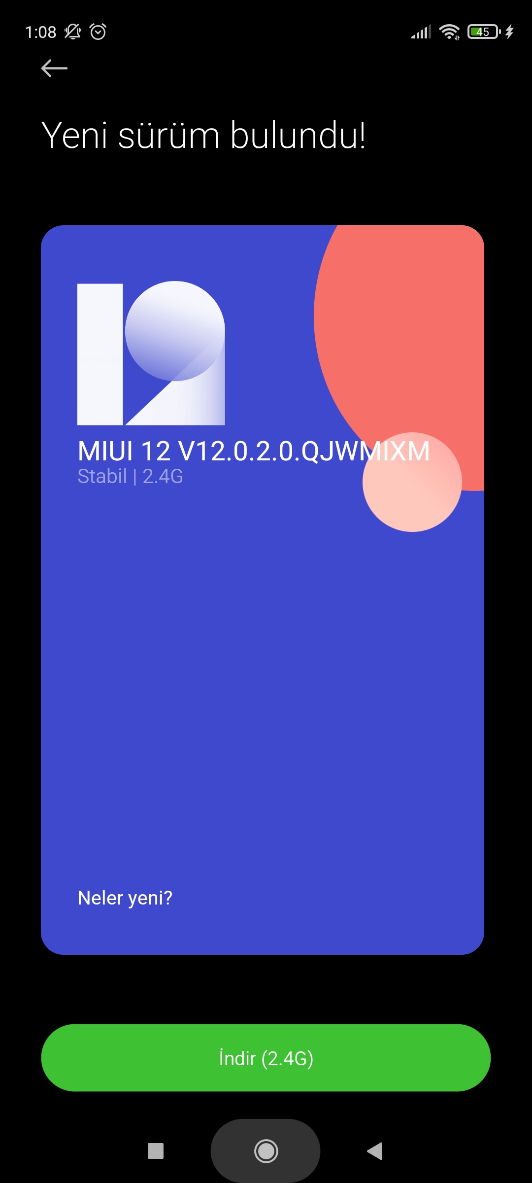

Hello can you add Xiaomi redmi note 9s MIUI 12 episode locked ı wrote from here thank you

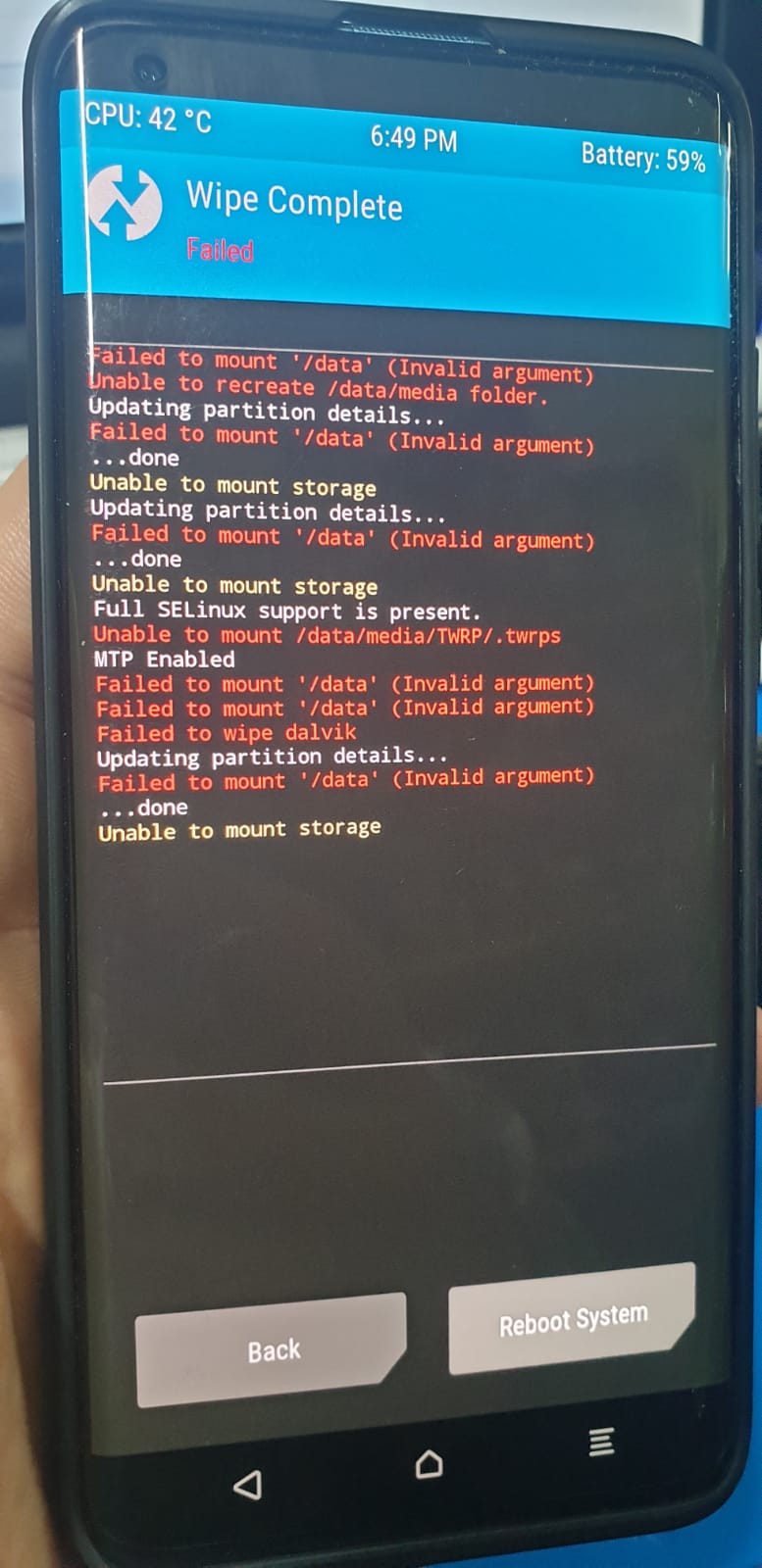

Mi 10 umi
I can't see my pictures, gallery is constantly closing without error message. Map, file manager, xiaomi wear.
I tried the previous version of trwp installation and everything you described but it didn't help.
Mi 10 umi
This has started happening this week, after upgrading from last week's ROM?
When you upgraded, did you clear the Dalvik and Cache, and delete the (system)/data/system/package_cache folder? This often makes a difference.
Yes, but only when I installed it on the old trwp. The new trwp issues error messages.
OK - you have TWRP 3.4.0, so you cannot decrypt, and therefore are getting these errors.
If you are familiar with Fastboot, you will have to download and use a newer version of TWRP - 3.4.2b-0623 from here. You will have to boot with this recovery, but NOT flash it - fastboot boot [recovery.img]. You will need to input your pattern to decrypt your data. You may have to wait before you are able to put in your pattern. You will then be able to clear the Dalvik and Cache, and delete the (system)/data/system/package_cache folder.
I did it successfully. But the problem was not solved :(
You didn't accept my password trpw TWRP - 3.4.2b-0623 . Finally, I deleted the password in phone and didn't ask for it. Could this be the problem?
So long as you can see the folders correctly, clear the caches without errors, and delete the package_cache folder, it should be OK. Beyond that, I am not sure what is causing these issues. If they are still causing you problems, you could go back to last week's ROM.
