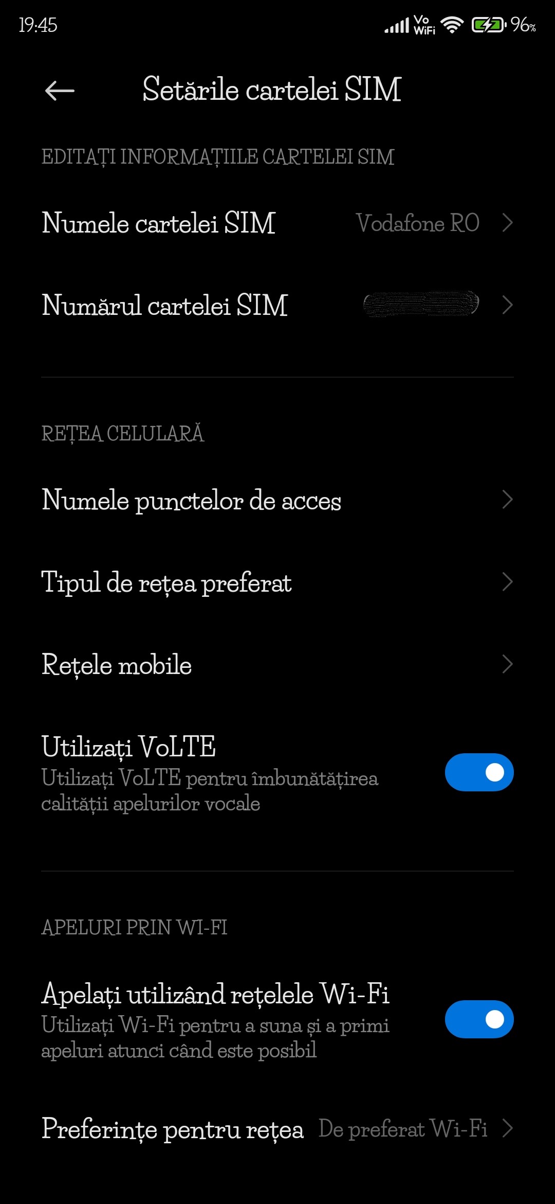

After the new update:
1. My wifi calling option is missing
2. The option to enable volte is there, but i cannot turn it on
3. I try dial VoLTE *#*#86583#*#* & VoWIFI*#*#869434#*#* on the phone, but nothing happen
I'm using poco f2 pro and my carrier support volte and wifi calling

if VoLTE/VoWIFI was working before the update, by clearing the Phone app data/cache (and SIM activation app) should restore VoLTE/VoWIFI.
be aware that codes applied toggles between enable/disable carrier check.
to get it work the phone should reply with message "disabled carrier check" after dial the code.
if applied again will "enable check" and that will inhibit VoLTE/VoWIFI (will gray out the option).
I did that, however it said disable carrier check in sim 2 only. U don't know why it wasn't apply at sim 1 also.
you can try also - after clearing apps data - to do a reboot.
also take out SIM , verify codes and see that also for sim 1 carrier checks are disabled. reinsert sim - this will reactivate and if data cleared and checks disabled phone will load proper carrier info and VoLTE/VoWIFI should come up (to enable).
if your carrier supports VoLTE and you have it activated at carrier side for your number it must work. looks to me that your phone doesn't loaded proper configs to allow usage.

- Wifi auto on doesnt work (see wifi settings to set on)
- No volte/vowifi is fixxed.... Clear phone app cache

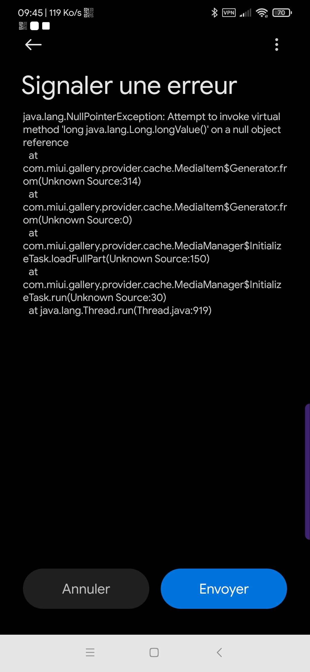

On Mi 9 Transparent, Gallery is crashing.
This is the log :
33356
The crashes happen when you try to oppen the Gallery app, or try to synchronize with Mi Cloud (and make a partial Sync).
