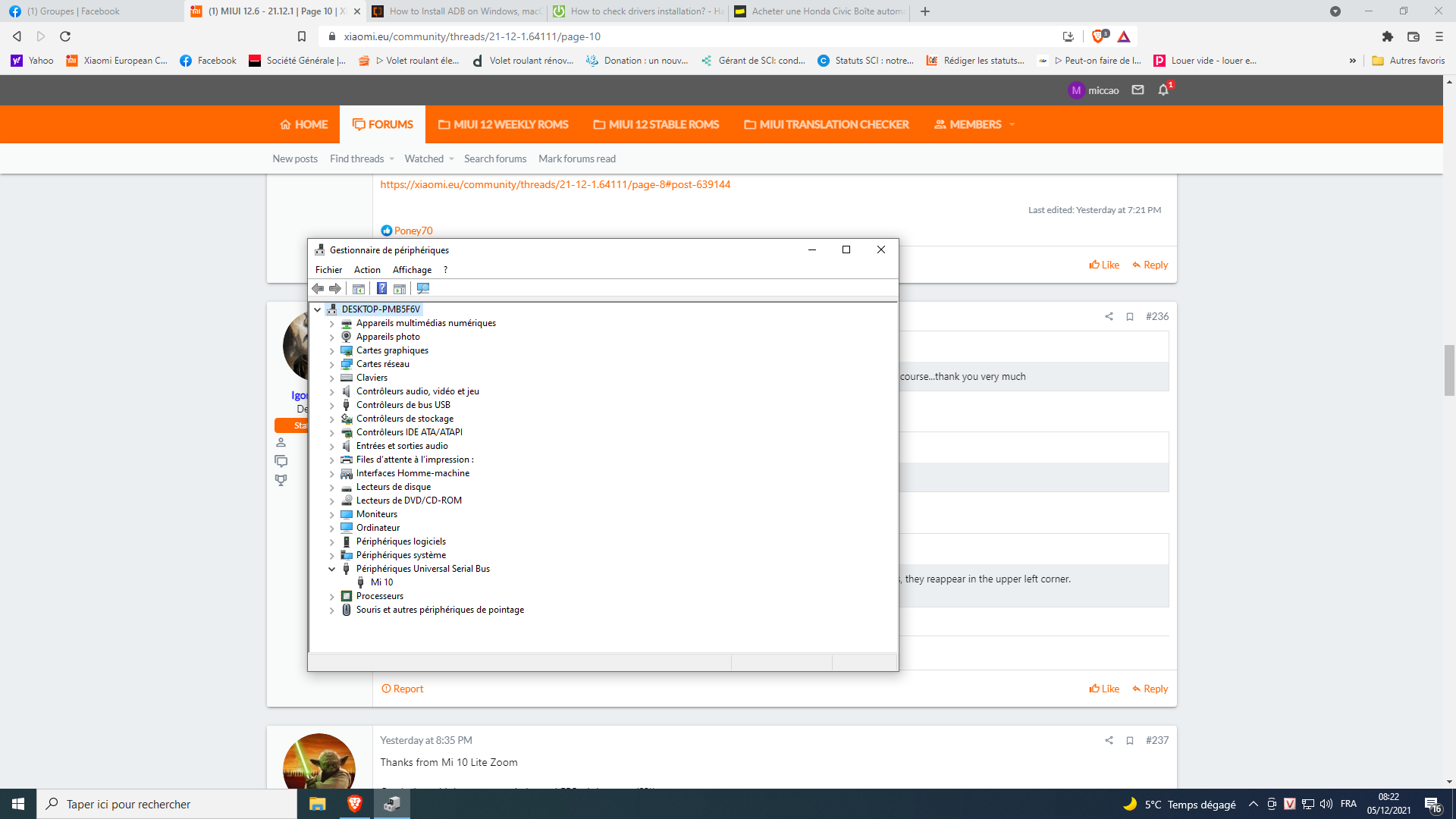

It means the PC doesn't detect any device. Make sure the drivers for your device are installed.
I have drivers installed, please take a look ...

- is your device in fastboot mode
- what is the output of # fastboot devices
- delete .\
- type only: windows_fastboot_update_rom.bat
- is it the directory were you have extracted the image
- did you install the drivers
My Mi 10 is in fastboot mode
what do you mean by " what is the ouput of *fastboot devices"
If I delete ".\", it won't work ...a mesage appears saying "error, we do see the windows_fastboot_update_rom.bat" but you have to add" .\" in order to make it work .
I have installed the drivers a year ago...When I go to device manager here it shows
if you follow my link in the post - you will see this:
- boot the device in fastboot, open cmd and with "fastboot devices" you should see a number
and I have put into the thread an example screenshot and I am wondering about this message "error, we do see the windows_fastboot_update_rom.bat"
I suggest....
- create a directory c:\test
- extract the fastboot image into this folder
- open cmd
- change to directory were you have installed adb & fastboot
- put phone in fastboot
- fastboot devices
- check if you see a number -> then all is fine
- change to c:\test
- windows_fastboot_update_rom.bat

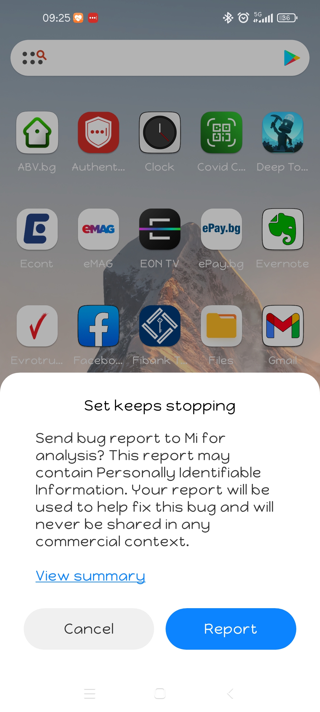

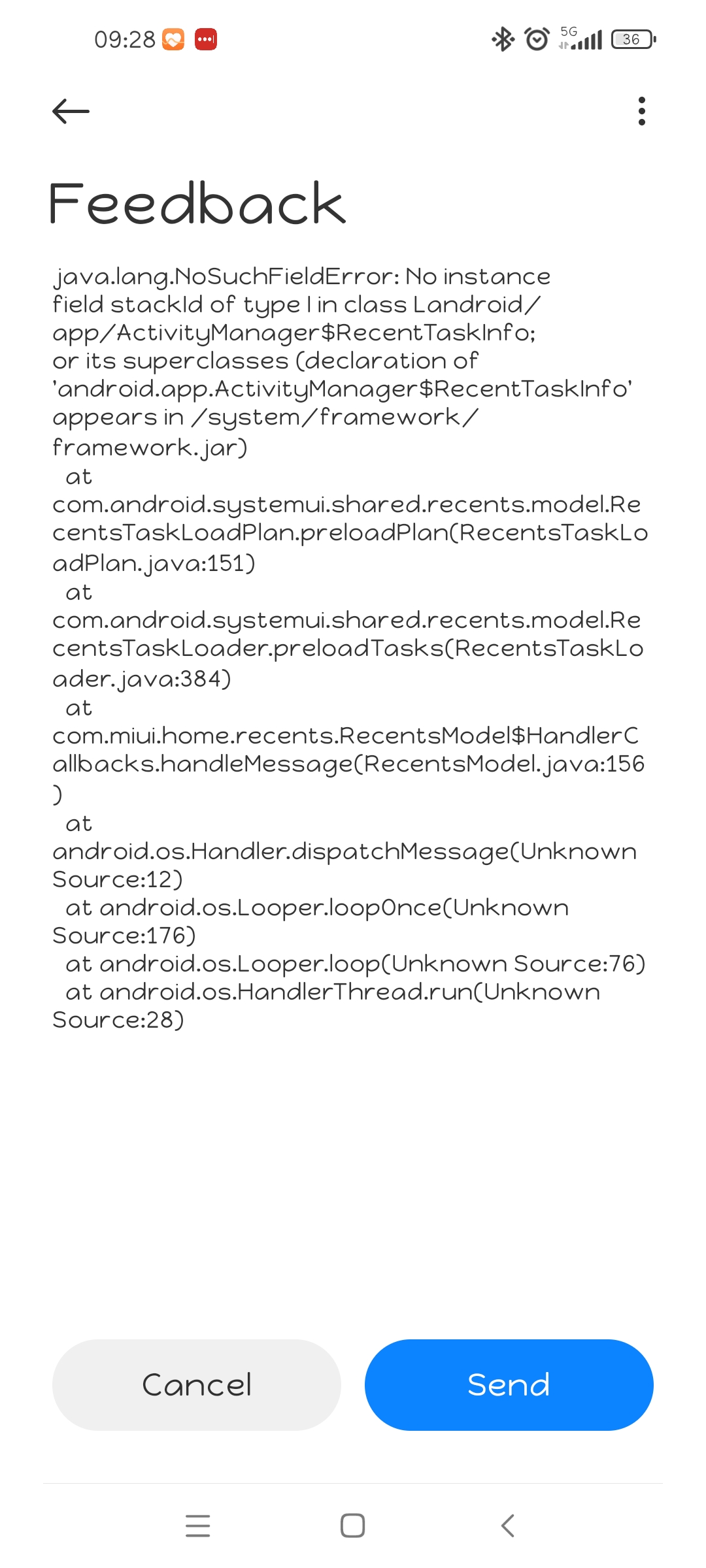

Hello to all
I am using mi 10t and I updated from Weekly Beta a11 to a12 without any problem, but now It keeps me showing that issue. Also Recent apps button doesn't work.

Hello to all
Set MIUI launcher as default launcher. And try again
