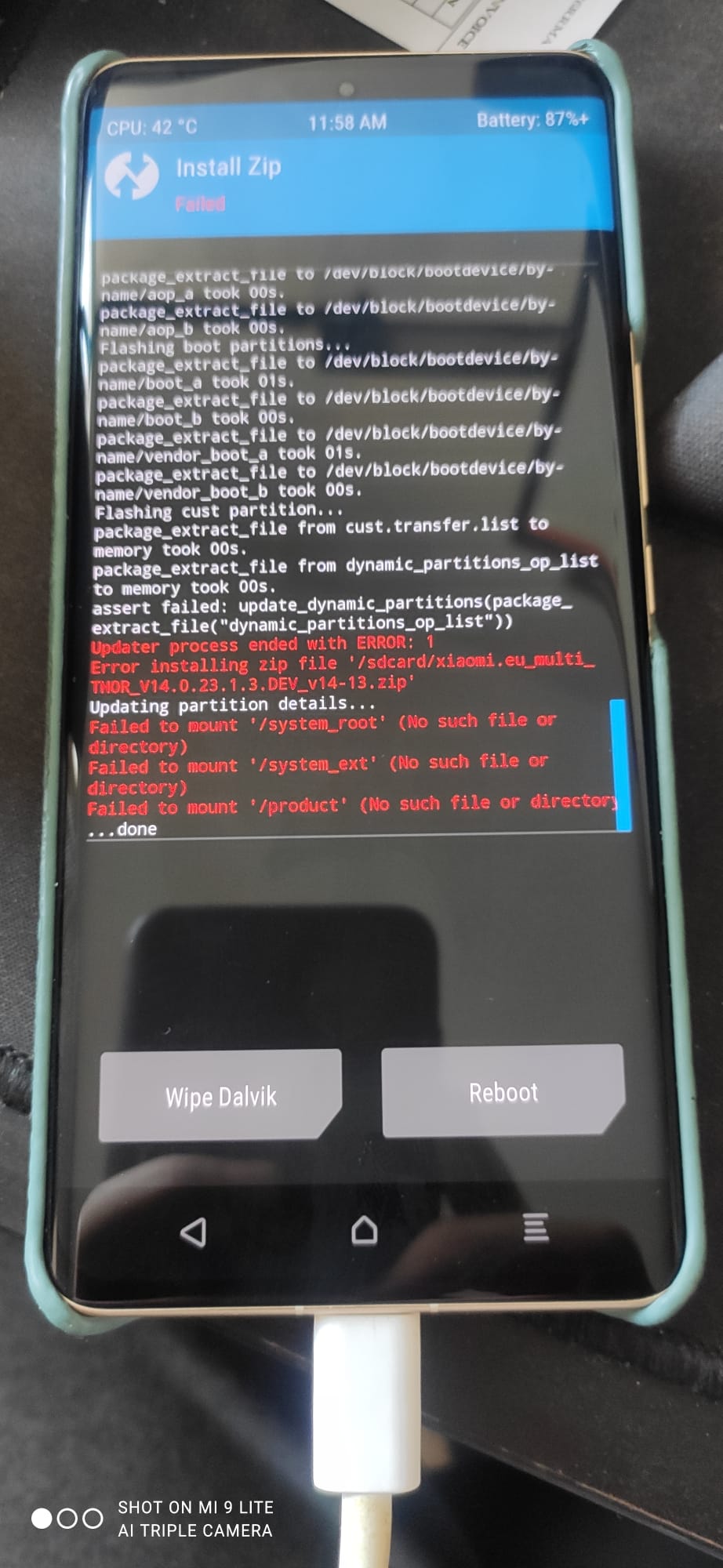

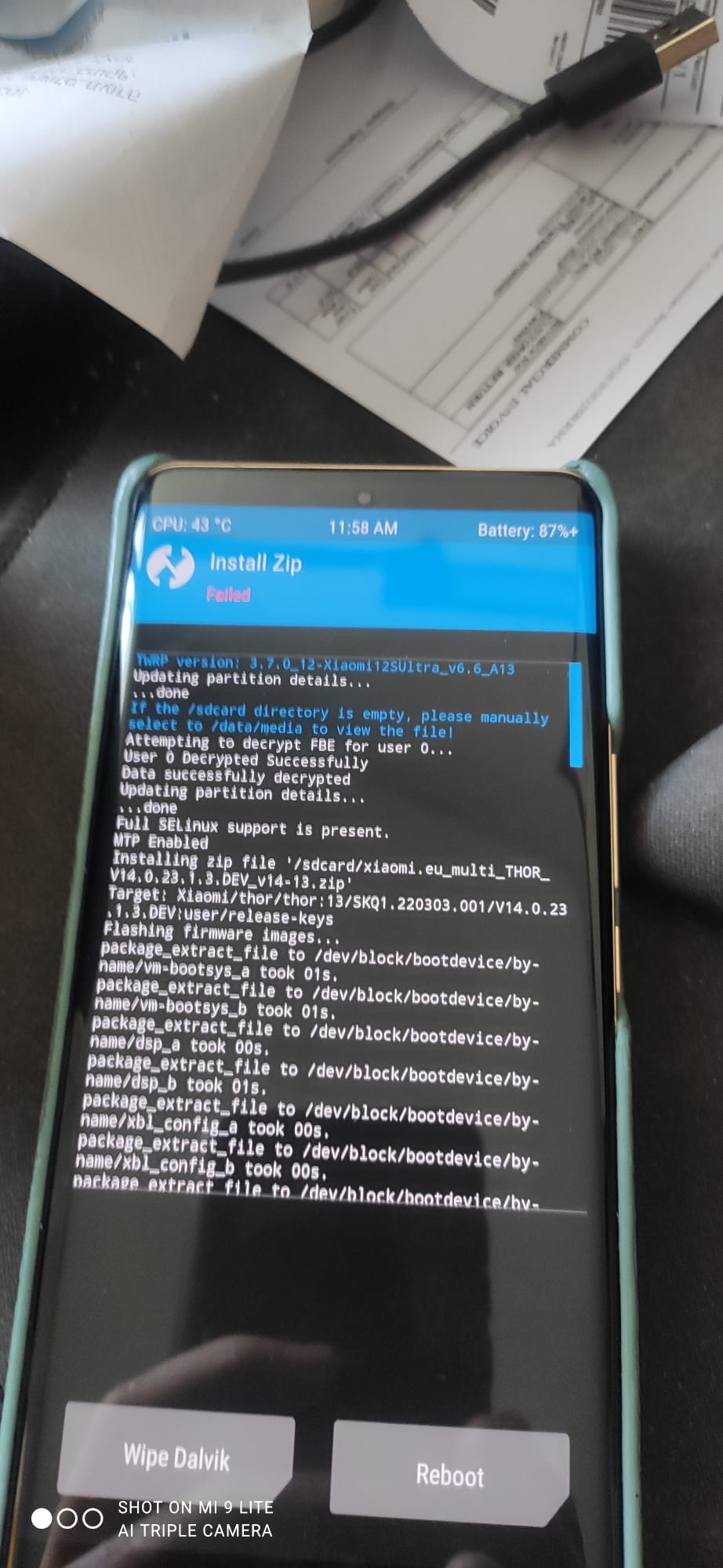

Issue installing this version on mi 12s ultra.
Tried through the updater app and failed then through latest twrp as can be seen in these images.

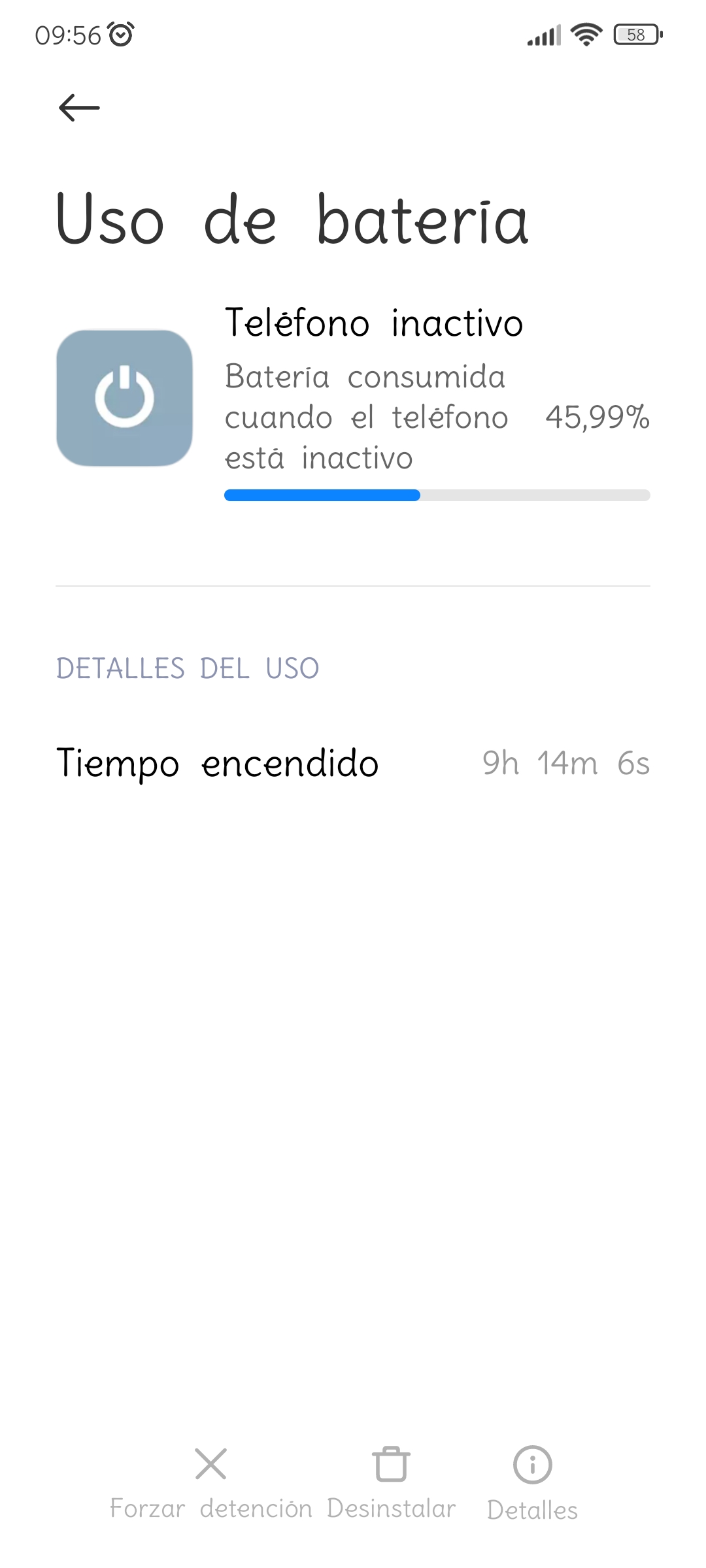

Good morning, I made the update without any problem and everything was fine. With this latest update, the biggest problem is excessive battery consumption, while using the phone I realized it, but tonight with the phone on standby it was amazing (see image) it's a problem I didn't have with the first one.
Can something be done?
Similarly, during charging the phone gets very hot.
If you will see this error in TWRP during ROM install, just reboot to TWRP again and try again (repeat until the installation is successful, maybe even 10 times)
It is written in the second post of this thread.
Thanks for the gig and updating our phone. By the way,
I have a Poco F3View attachment 45563!!
Mine is 14% which still seems higher than usual. Same device
Thank you, I've seen that yesterday but then forgot all about it until it happened to me this morning, sorry for that

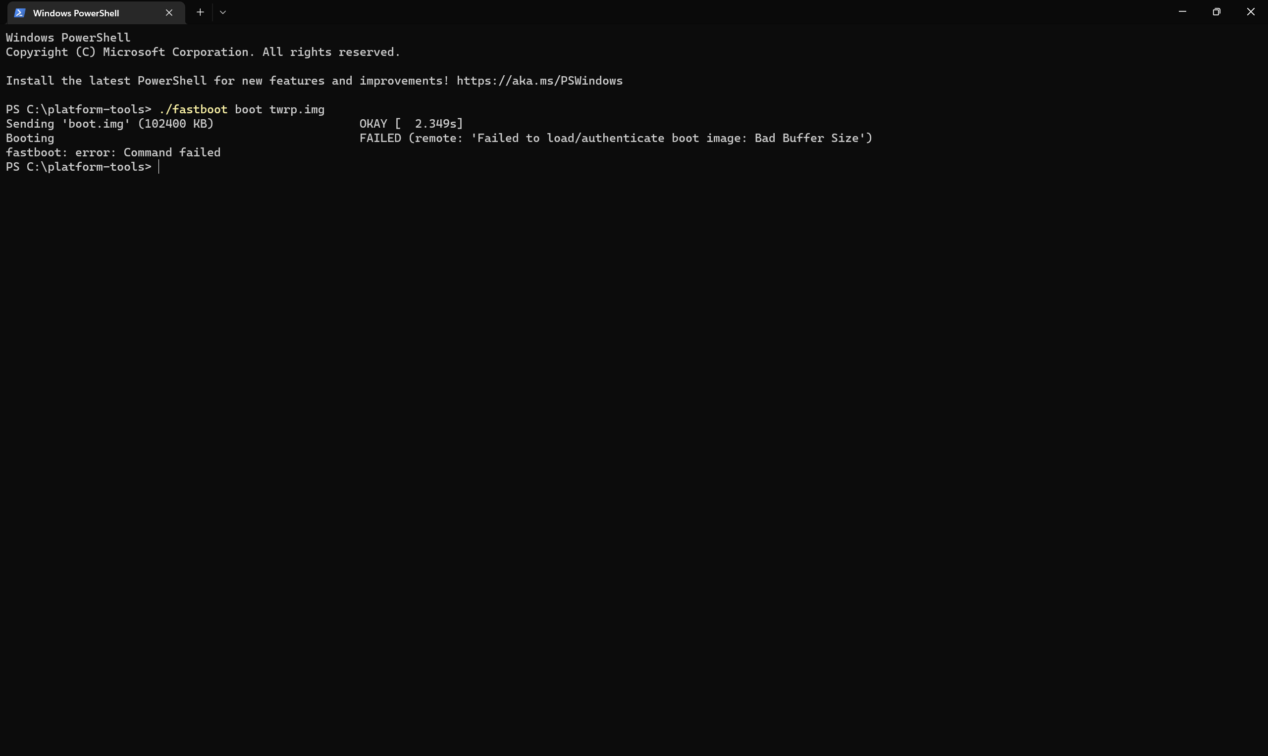

Hello, I read the forum, I tried everything you wrote, the TWRP installation gives me an error message. I also tried the command lines that were suggested, then the old TWRP for Android 12 came up, which does not see the phone's internal storage
Use "fastboot flash recovery_ab twp.img" and then "fastboot reboot recovery".
Look at the first and second post in this thread

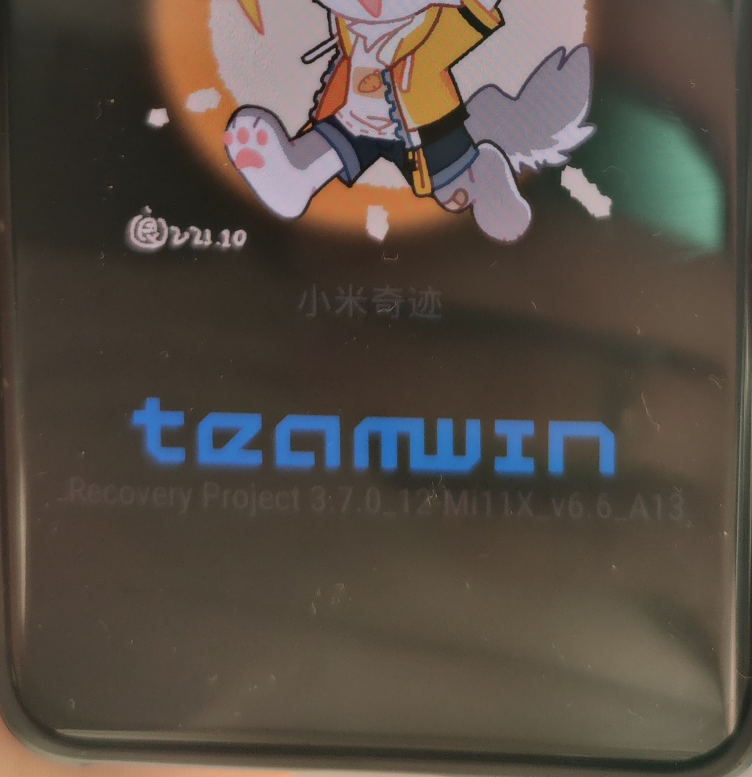

Xiaomi 12X here: I still have twrp-3.6.2_12... do I need to update it to 3.7.0 or can I just install the new Xiaomi-EU using my old twrp?

Yes. Boot into the existing TWRP and goto "install recovery as ramdisk" and select twrp-3.7.0_12-v6.6_A13-alioth-skkk.img linked above for Alioth/K40/F3.
I did, now it's stuck everytime I try to boot into TWRP, should have pick the correct one for my 11 pro xD, going to flash the older one again until it's working.

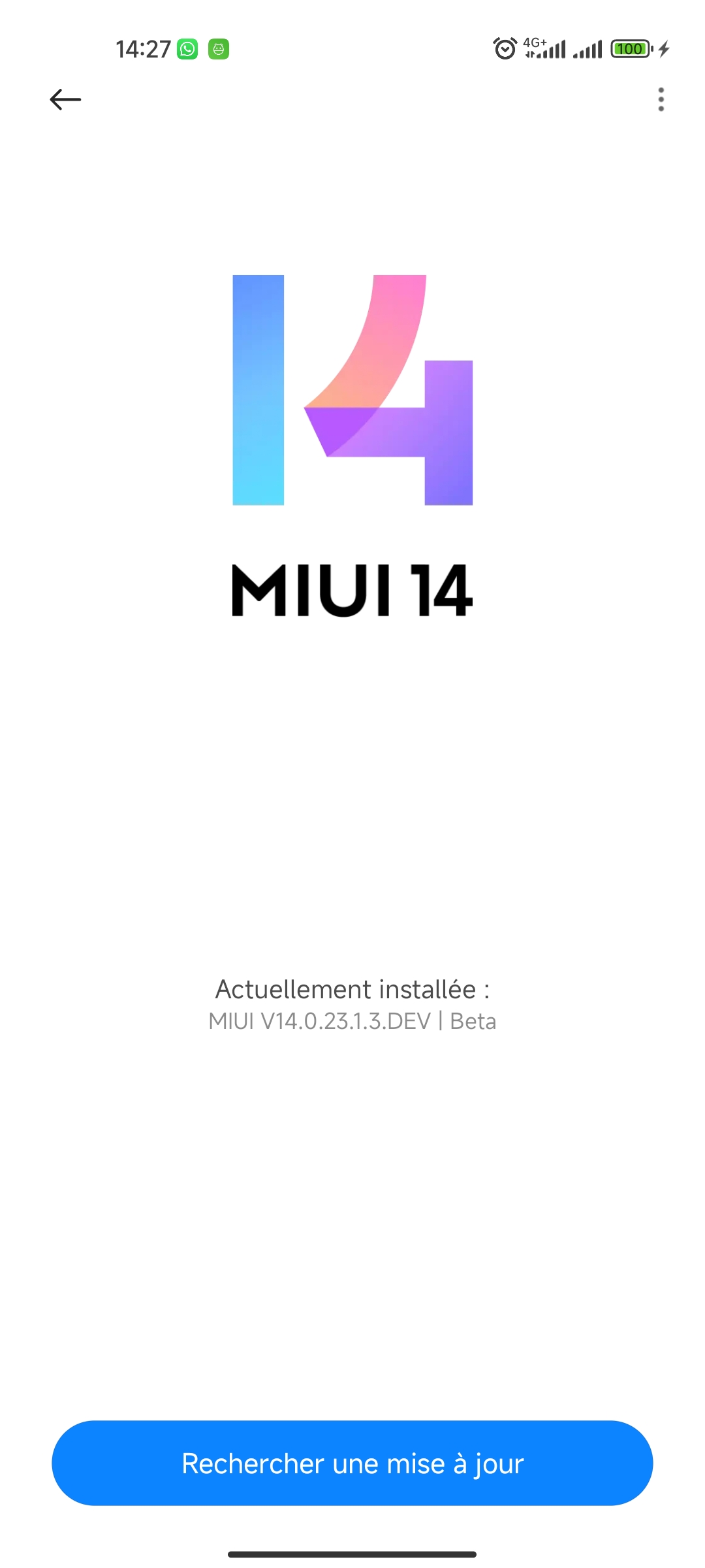

Update succeful mi 11
