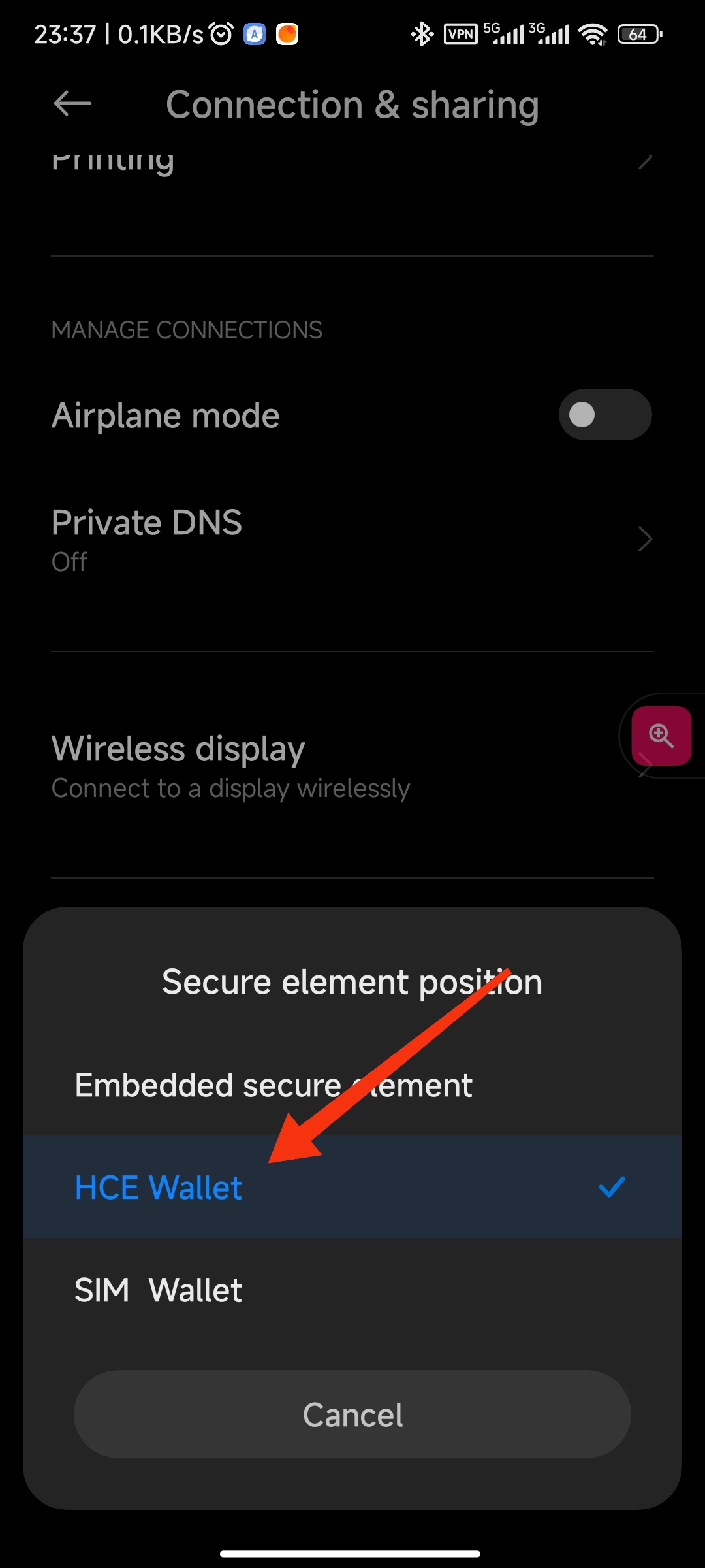

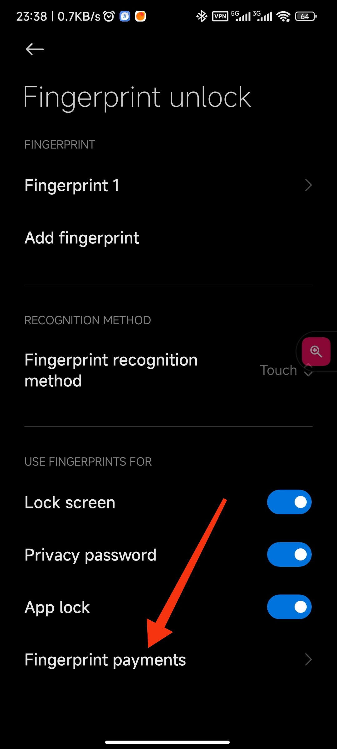

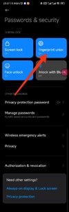

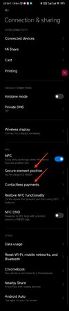

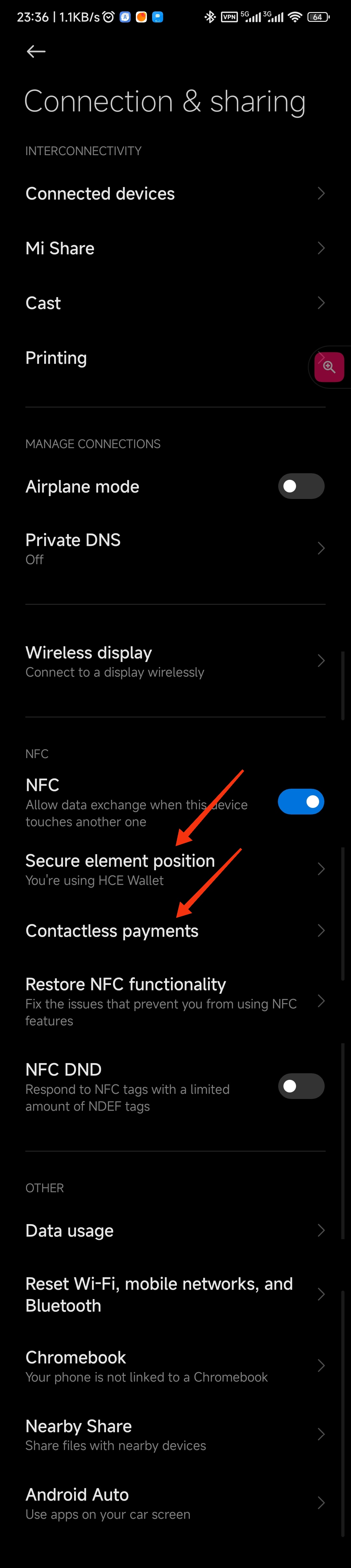

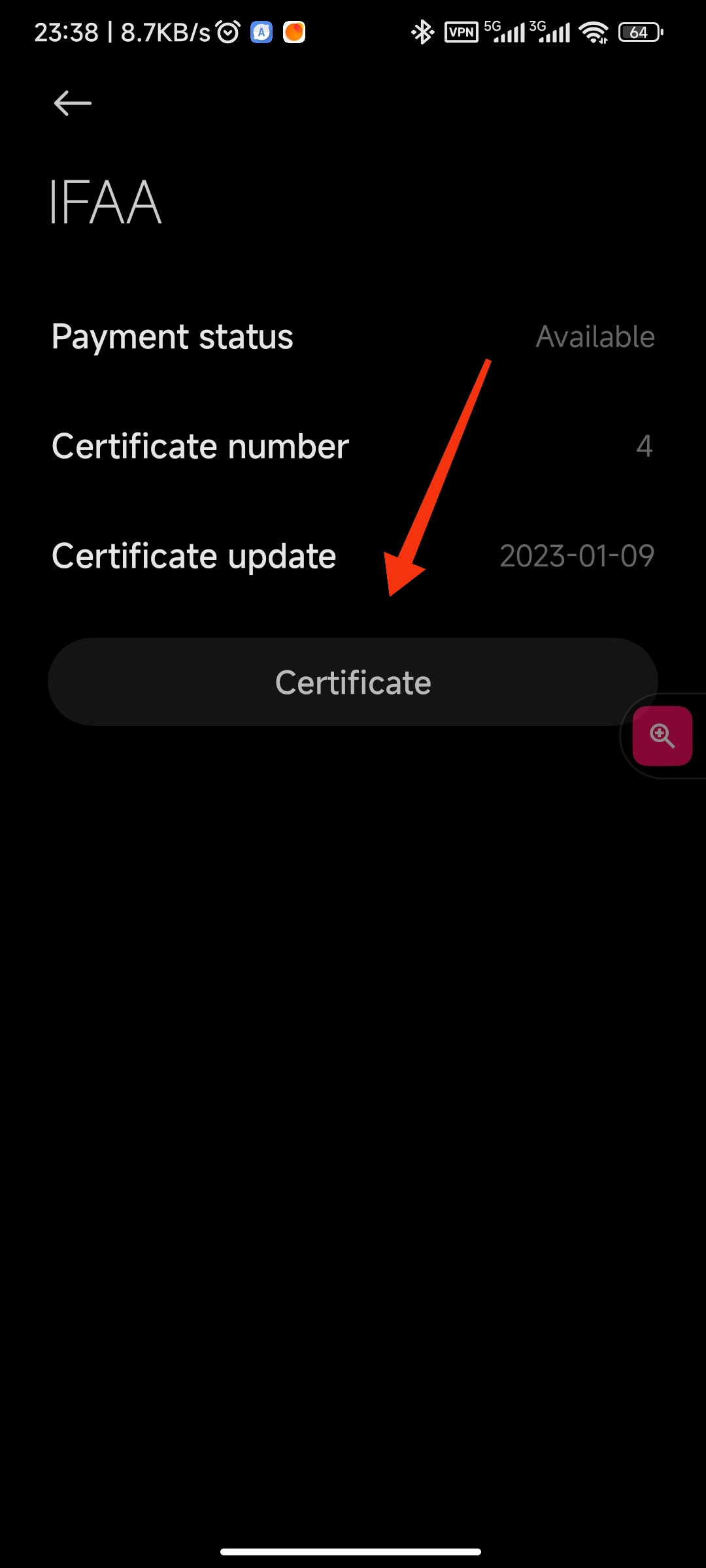

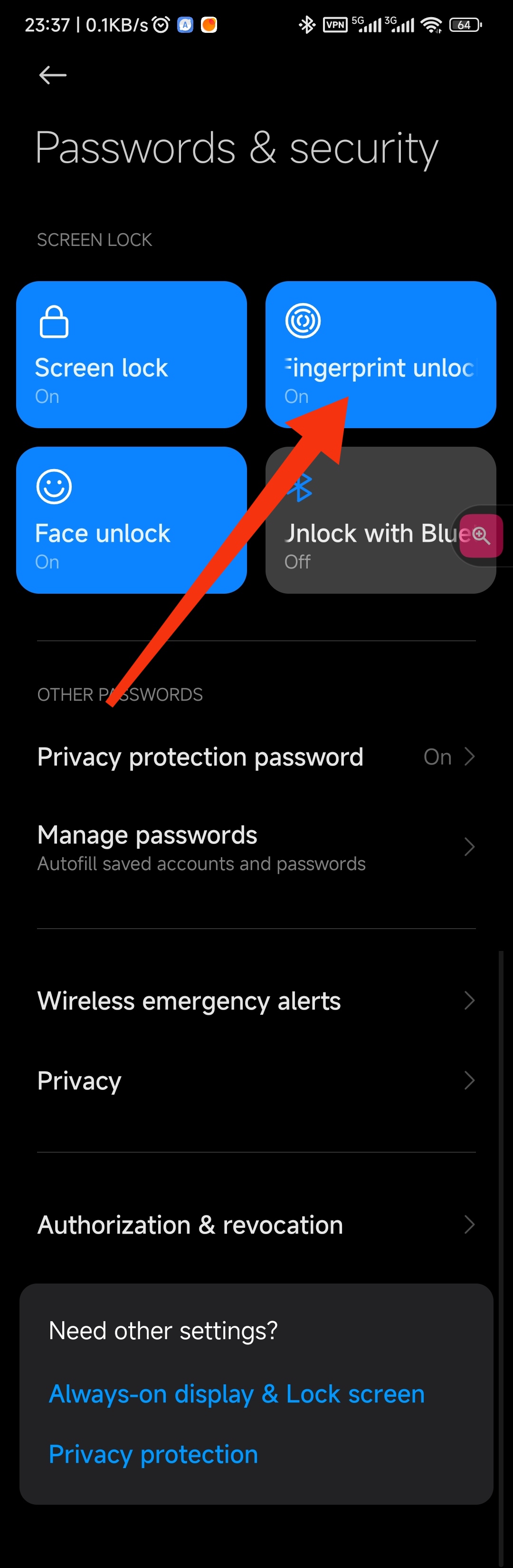

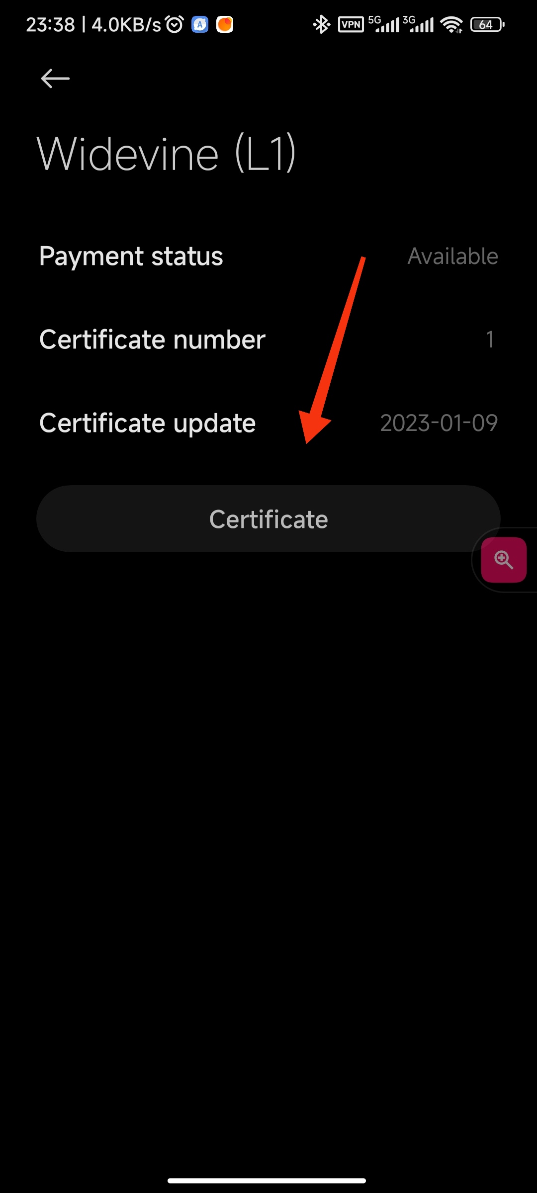

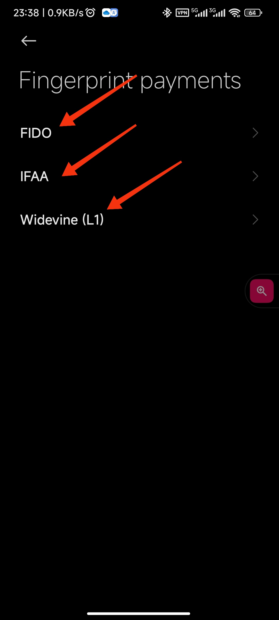

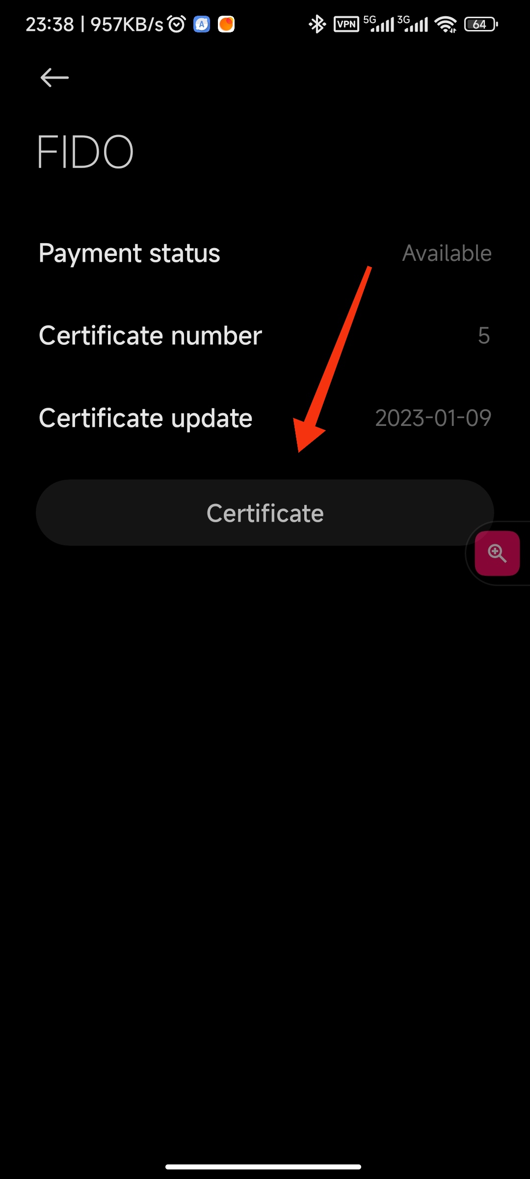

For those who are having issues with payments through Google Pay (NFC) after MIUI 14, it's worth checking the settings below and updating all certificates:
Settings / Connection & sharing / Secure element position / <HCE Wallet>
and
Settings / Connection & sharing / Contactless payments / Default payment app / <Google Pay>
and
Settings / Connection & sharing / Contactless payments / Use default payment app / <Always>
and
Settings / Passwords & security / Fingerprint unlock / Fingerprint payments / <FIDO> and <IFAA> and <Widevine (L1)> / <Certificate>
Note: Check the screenshots (annex)
Let we know if the payments works now.

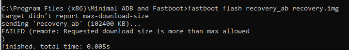

Hello, user of CUPID XM12 here, when i try to install twrp-3.7.0_12-v6.6_A13-cupid-skkk.img i get this error:
C:\Program Files (x86)\Minimal ADB and Fastboot>fastboot flash recovery_ab recovery.img (I did change the name of file)
target didn't report max-download-size
sending 'recovery_ab' (102400 KB)...
FAILED (remote: Requested download size is more than max allowed
finished. total time: 0.005s
I have tried rebooting phone, different USB ports, different cables and nothings seems to work, any help?

Use fastboot boot xxxxx.img
Then in twrp- go to advanced and Install current twrp, reboot to recovery and enjoy.
