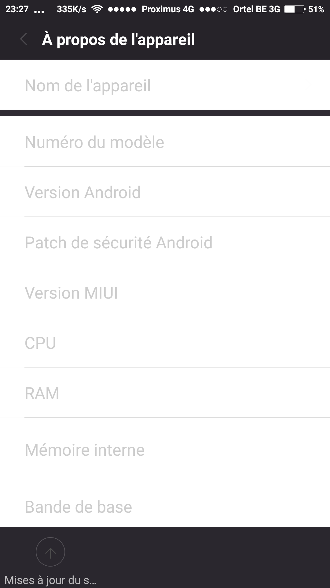

Hi first thank you for your great job !!
Gemini is OK but when I check the phone specs there is nothing on this page...just to ask what to do ? Download again and re install?
@ ingbrzy or other persons who had this, do you have a solution for my problem ?
Thank you

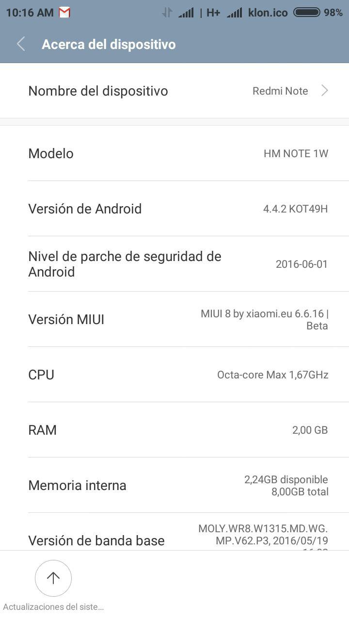

For users of redmi Note 3g (HM Note 1W).
The phone is not the end of life, you just have to increase the system partition, as was done with the Mi4 when you upgraded to android 6. The increasing size version of miui 8 and having to include gapps ( unlike the Chinese version miui 8), the system takes up more space. We must increase the partition of 786 Mb to 1.5 Gb, and have room to spare. This means that we will lose more than 700 Mb of internal storage space, but it's worth (we have Sd card).
To increase the space of the system can go to google and enter "increase system partition in redmi note 3g"
Miui 8 is working fine in redmi Note 3g.
Sorry my bad English (google translator)

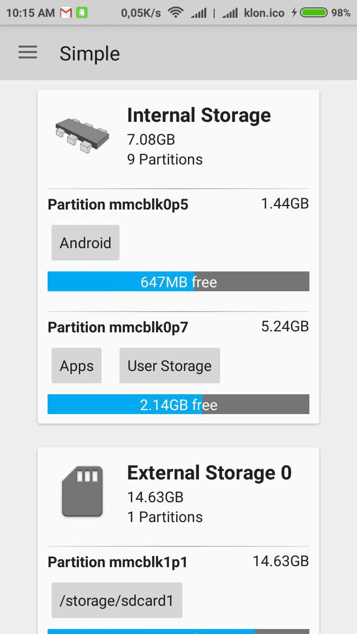

For users of redmi Note 3g (HM Note 1W):
To increase the space of the system can go to google and enter "increase in redmi system partition note 3g"
Lucky!
View attachment 12607 View attachment 12608
What app is that?
