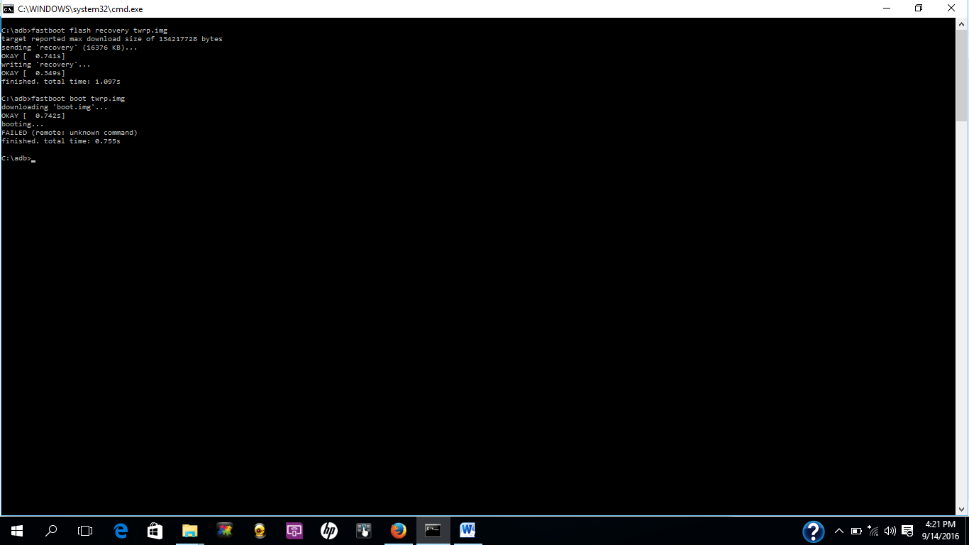

This is a fine way to flash the recovery, make sure you have the recovery image in your adb folder and fastboot is working. And start the cmd from the adb folder/browse to adb folder in cmd before entering fastboot command.
All procedure followed to the letter. the the image below for the error i get when trying to boot to recovery

no i cant boot to recovery
Just to clarify so others can understand your situation.
Can you check again if your device is unlocked, with fastboot conmand?
Check if you have usb debugging and oem unlock enabled in developer options.
Can you boot in current recovery (any recovery installed at moment)?
Is your rom working atm?

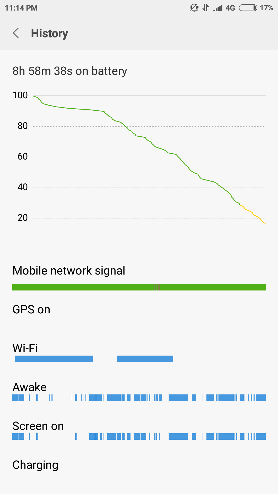

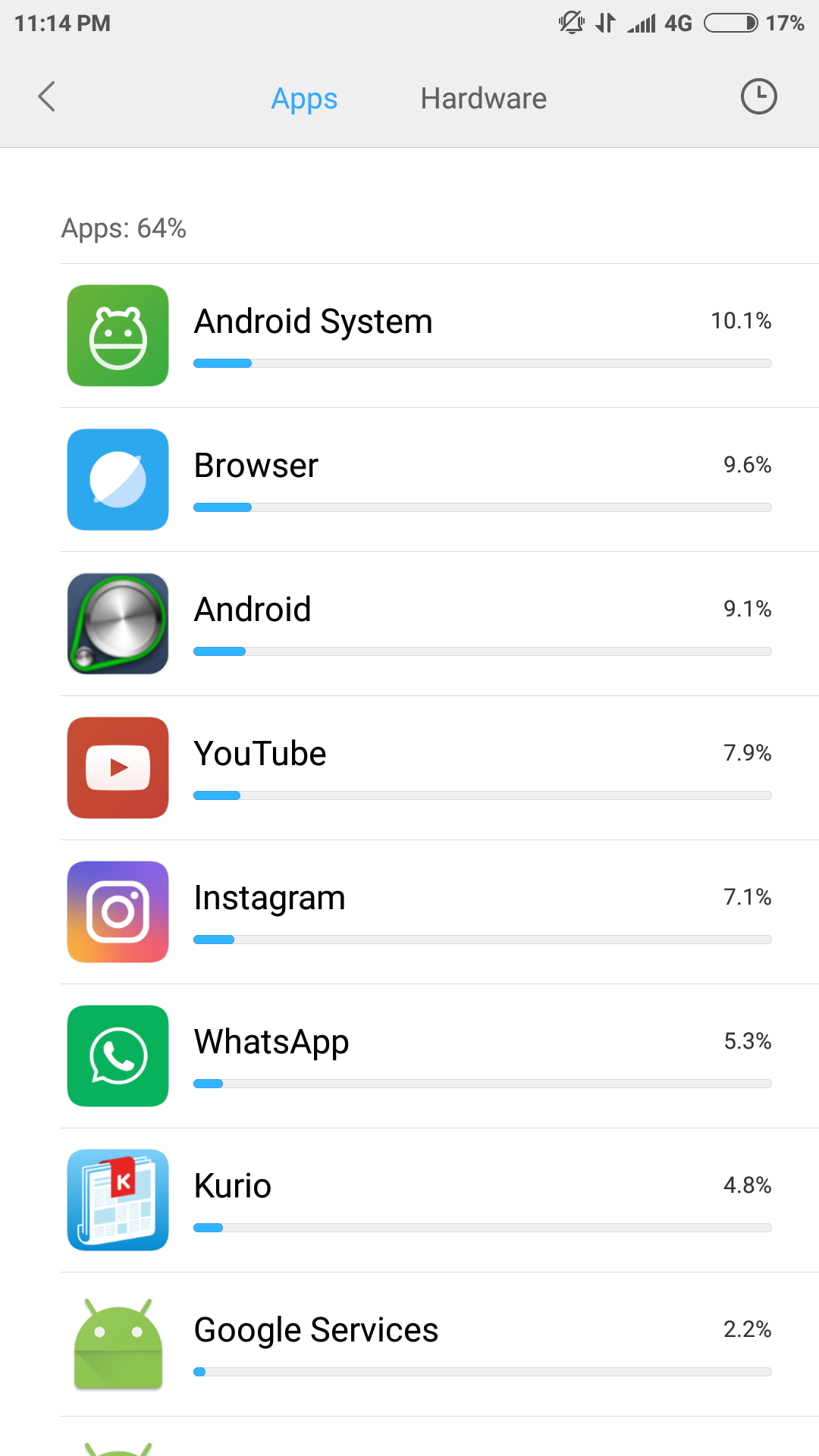

My Mi4C battery life so far with 6.9.8 Dev without optimization, mostly on 4G. This is a lot better, thanks dear dev. Keep up the good work ;)

Can u please put up a more recent way of flashing twrp or link pointing to it. I'm also having same problem flashing twrp recovery on my redmi note3 Hennessy
For windows pc:
Download adb from here: http://en.miui.com/thread-235865-1-1.html (scroll a bit through the text for the adb link)
Extract to desktop
Download twrp from the link on page one of this thread
Rename it to twrp.img
Copy twrp.img to the adb folder on your desktop (same folder where fastboot.exe is located)
On your phone, in developer options enable usb debugging
Put the phone in fastboot mode (volume down + power)
Connect your phone to the pc
In the adb folder hold shift and right click with mouse
Select open command window here
Type: fastboot flash recovery twrp.img
When finished, type: fastboot reboot and immediately after hold volume up + power to put the phone in recovery mode
Wait for the mi logo to appear for the second time and release the buttons
Twrp should start
Reboot to system
If the phone reboots to system after the fastboot reboot command, wothout booting to recovery first, twrp will be deleted so you will have to flash twrp again. Be sure that you have unlocked the bootloader before flashing, otherwise you may brick your phone. You should also install mi pc suite before flashing and connect your phone to the pc with mi pc suite running because it will automatically install the drivers you need
