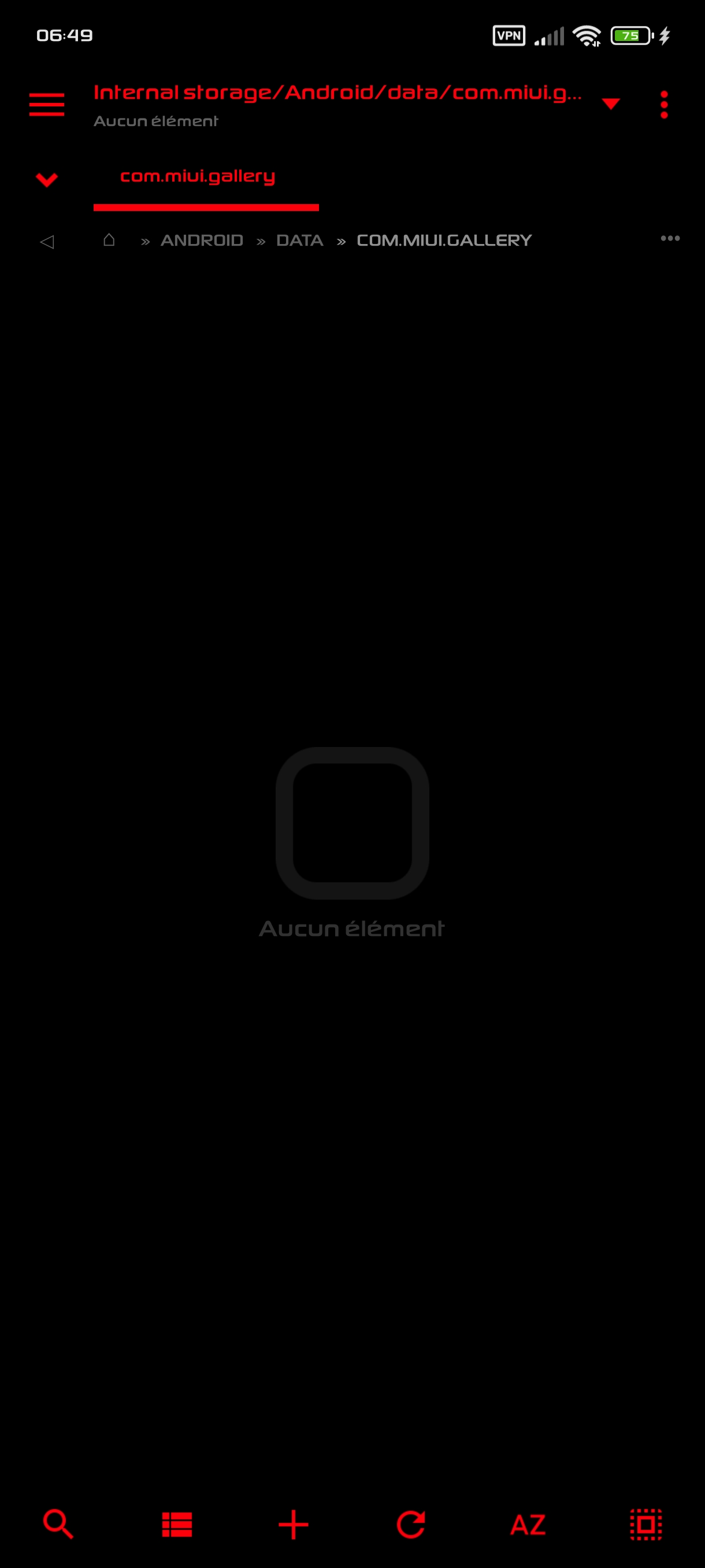

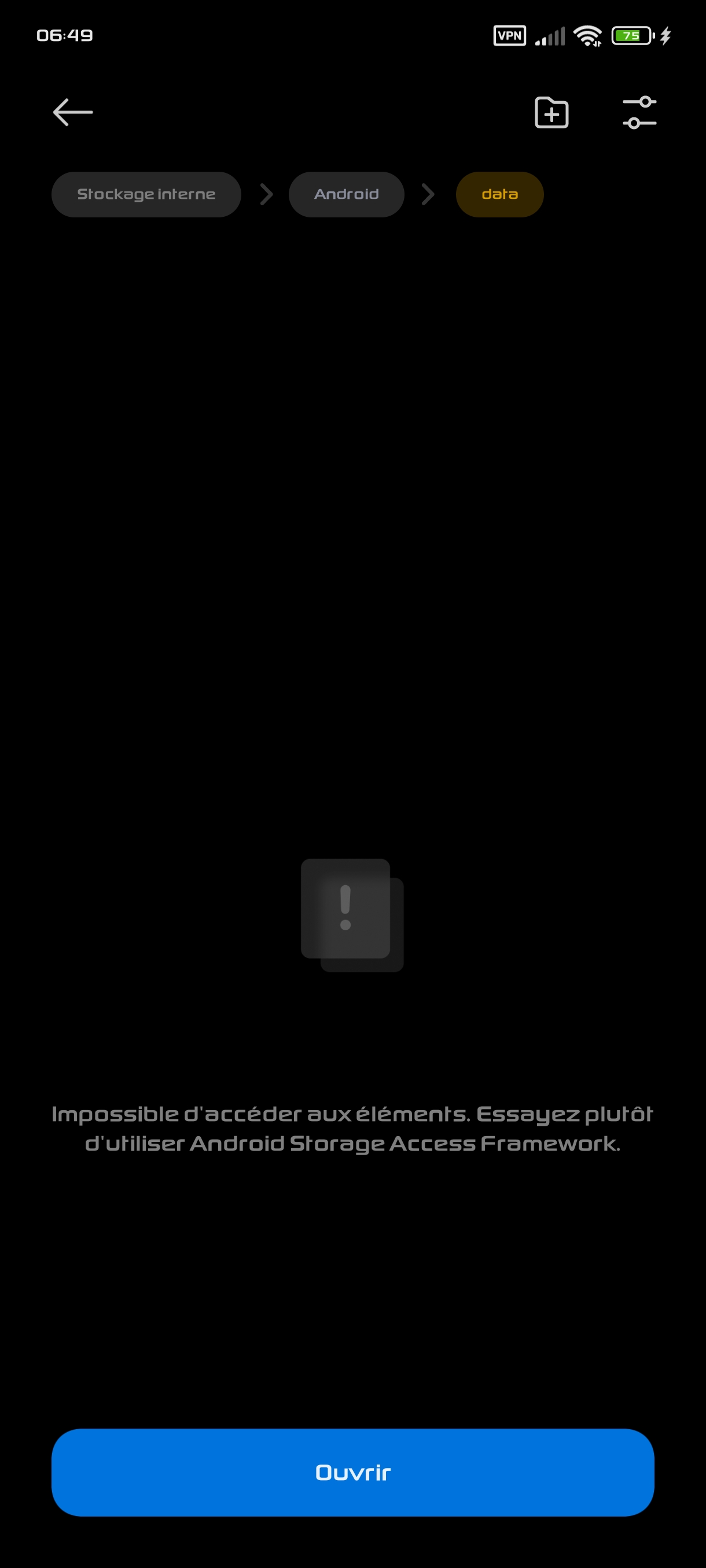

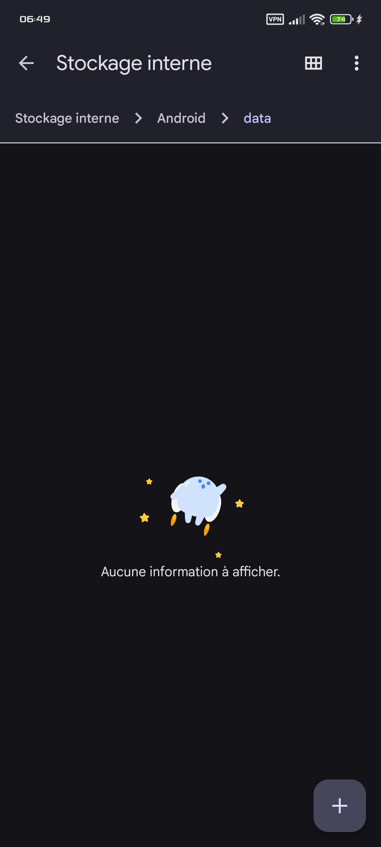

Hi, I try to acces to some files, I have try 3 files manager And none have access, it's as if it's empty
Edit : I have read it's a new security on android, Is there a way to access it ?

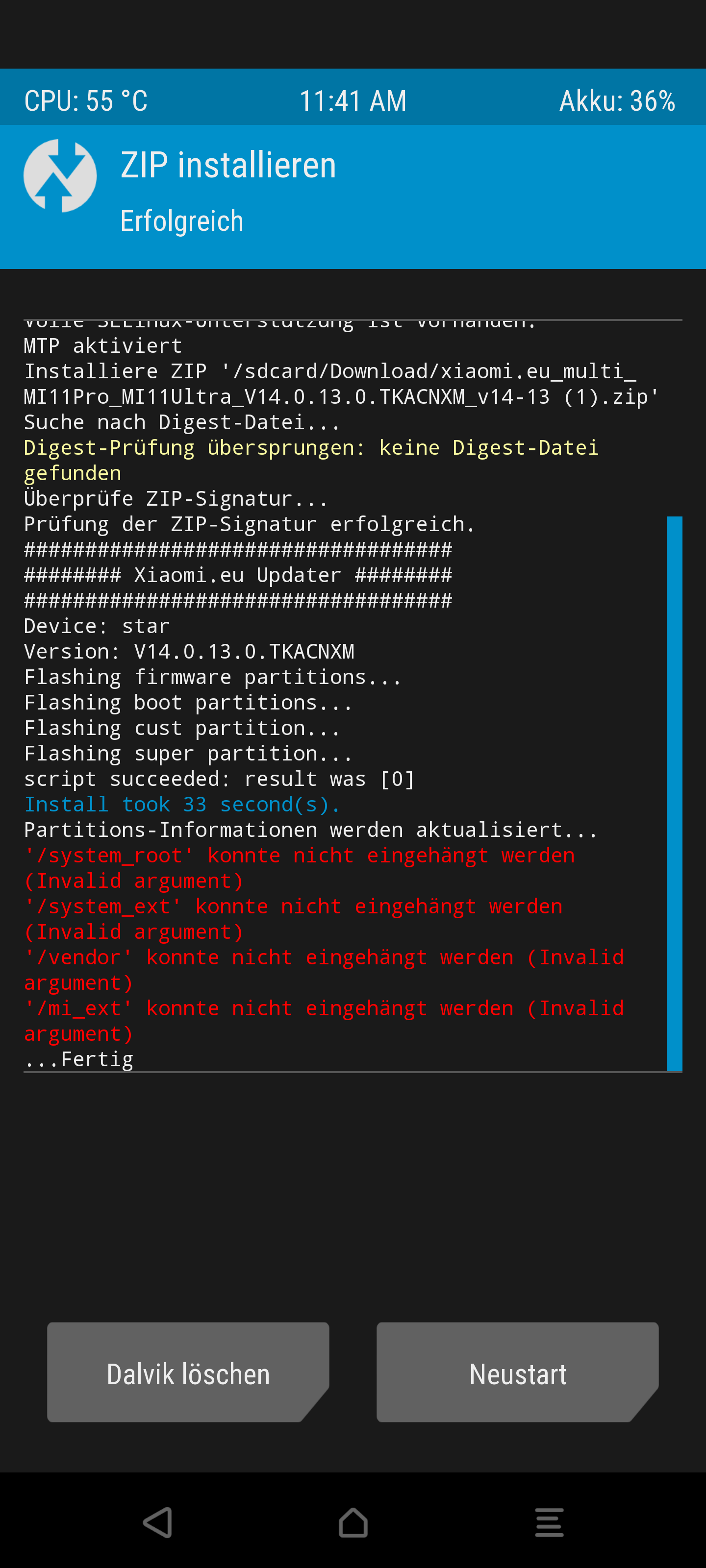

Hello, unfortunately an error occurred during my last update, but the update still worked. If I now want to install this update, can this lead to problems? What can I do to avoid the errors?
Unfortunately the screenshot is in German, I translated the text here:
Partition 'xxxx' could not be mounted

That always appears after flashing an update.
After rebooting to twrp it will be fine.
If you want to be more on the safe side, go under Erweitert and scroll down to flash current twrp and confirm, if you had root you also need to flash magisk or kernelsu depending on what you had

It's alright. The ROM was installed correctly. Just boot the device into the system. Nothing else needs to be done. It won't cause any problems.
This is due to the imperfection of TWRP.
