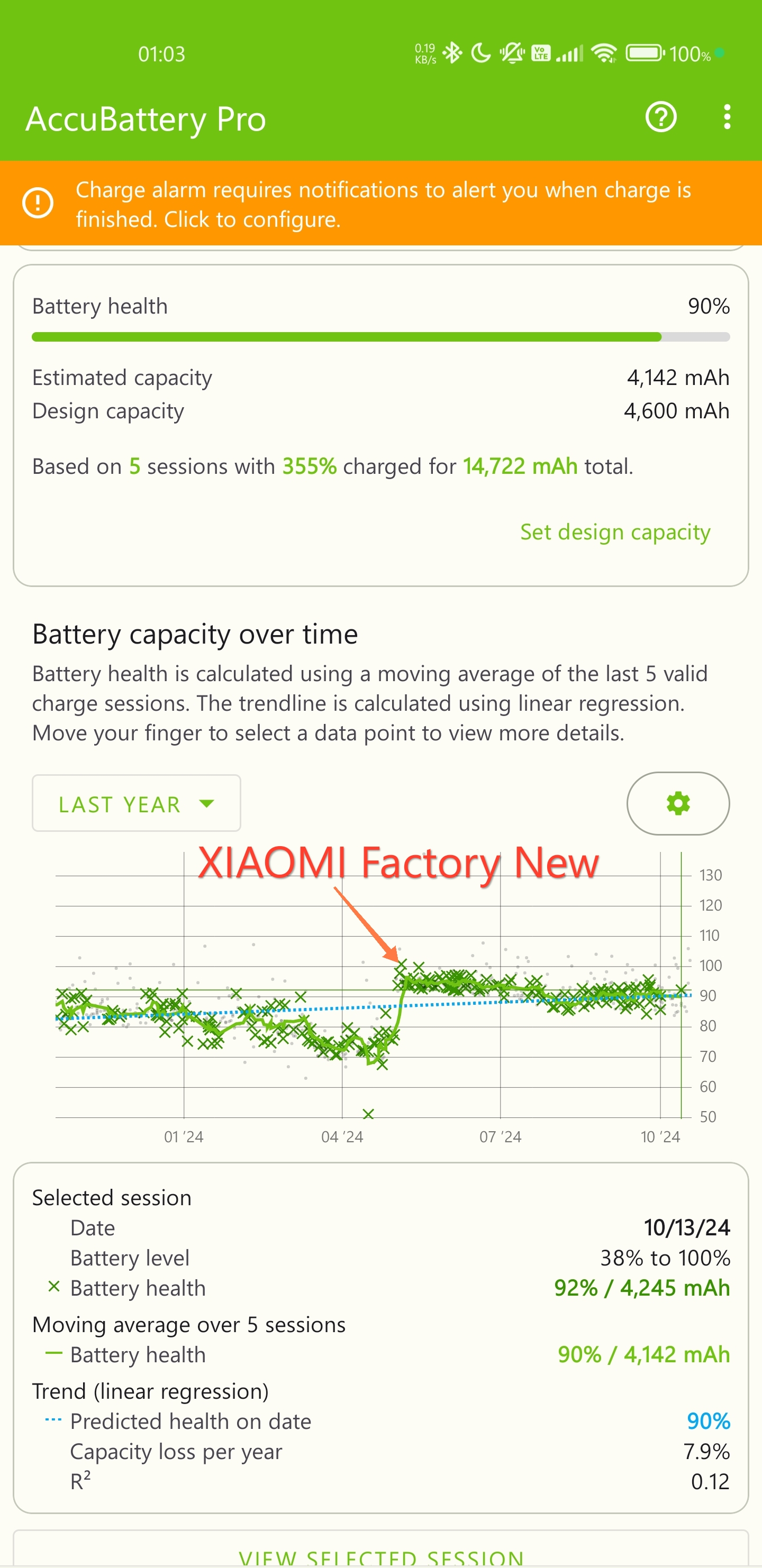

Where you have see that people have 90% of battery after only 4 month ?

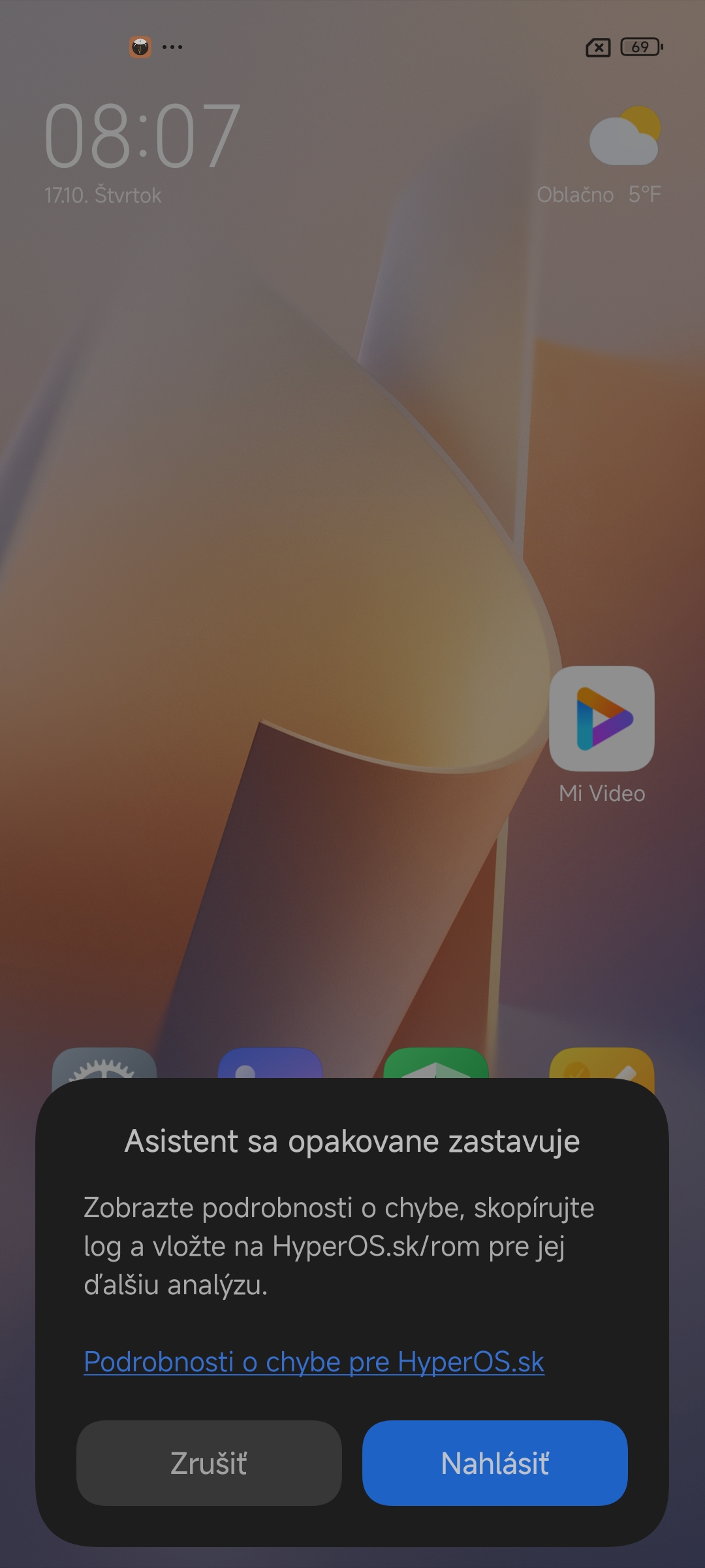

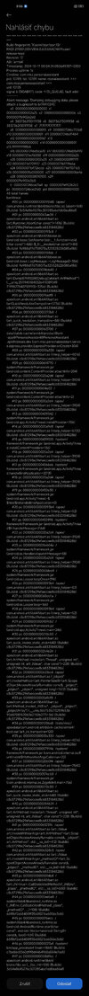

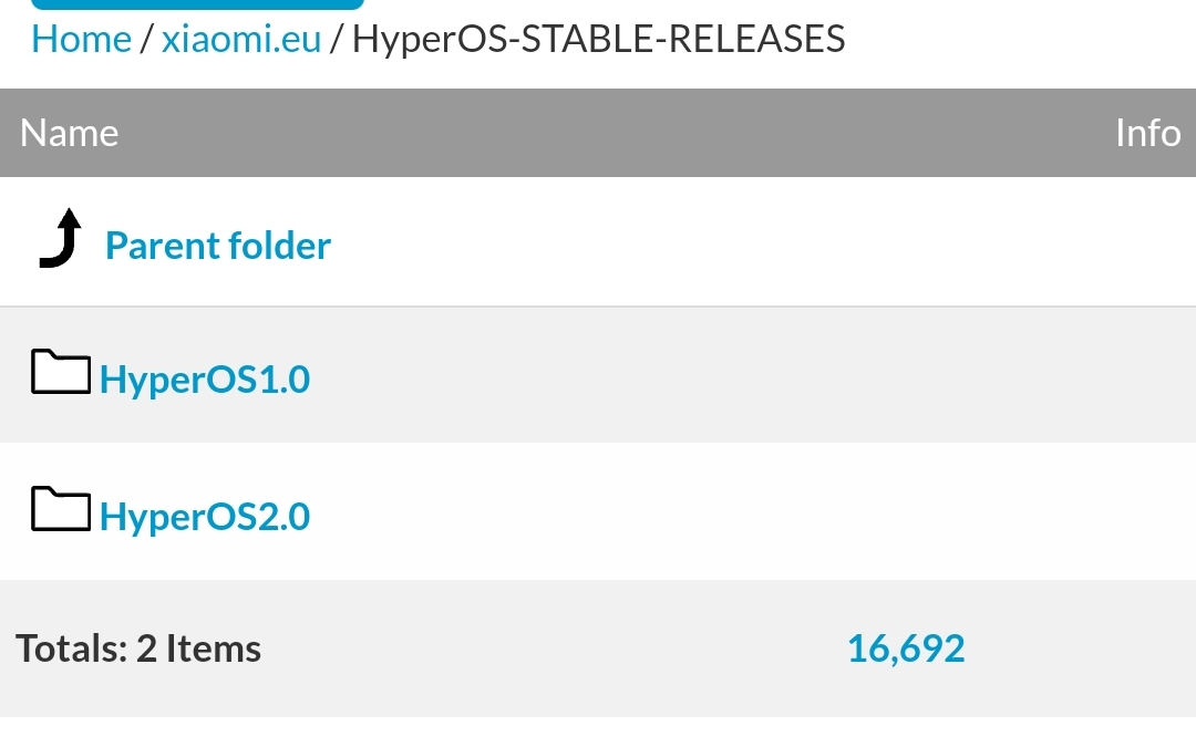

I just dirty flashed from 1.0.5 to 1.0.6 for star Mi11 Ultra. Immediately Gwallet, certain banking apps, xiaomi community app and youtube music cannot be opened. Tried clearing dalvik and cached and rebooting including reflashing the 1.0.6 ROM but no avail. Any suggestions? I am thinking of flashing down back to 1.0.5; does that count as a downgrade and where can i get the file as the sourceforge dir only contains latest ROM versions. Thanks
Reactions: ultra3000
I have already tried to dirty flash to 1.0.5. Don't do that. It messed up system completly..
Here I made a thread in "bugs", so if You get any new information or solution, just share it there. It may help in the future. Thanks.
It has been said several times but use the command adb shell pm compile -a -f --full via a PC while the device is running.
