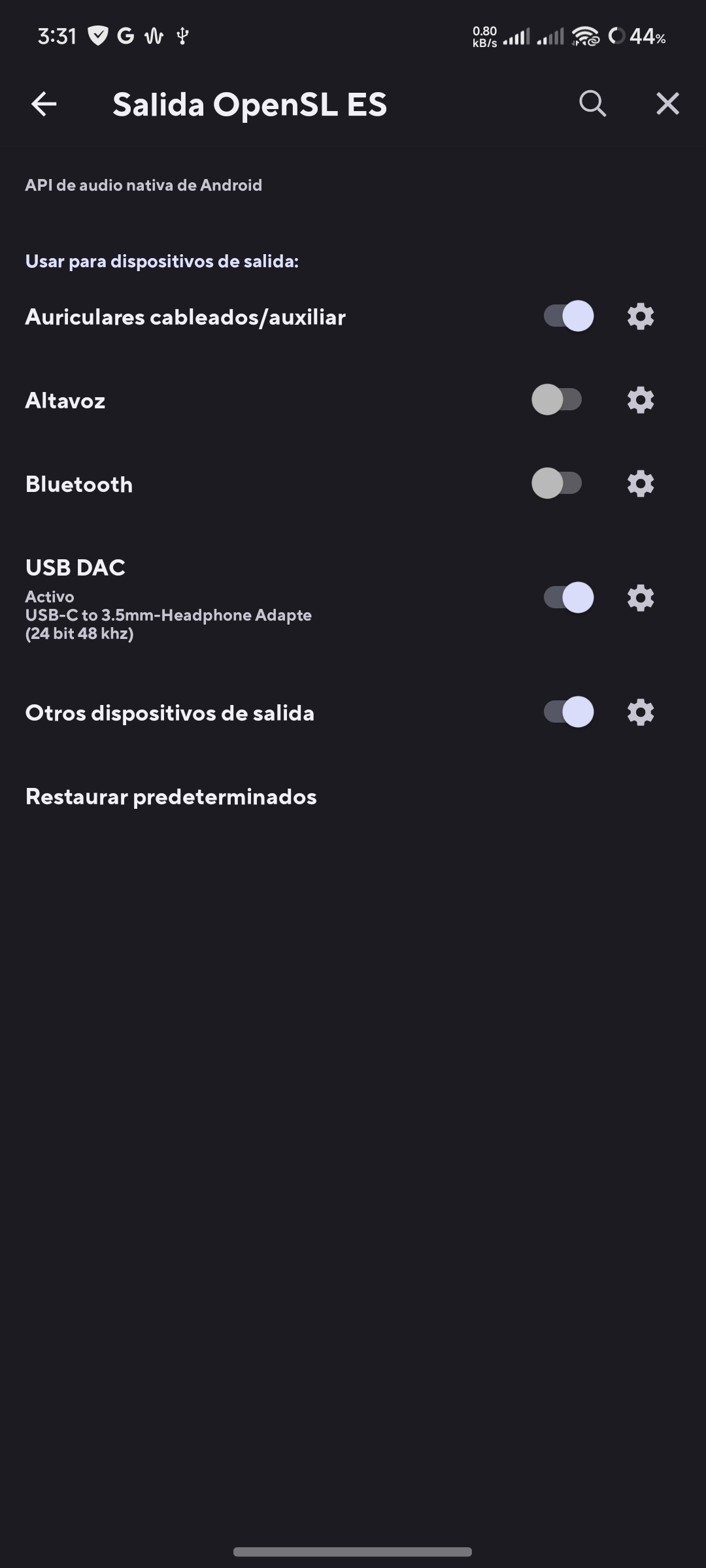

Hi every one I'm encounter an issue in hyperos 1.0.16.0.UMACNXM (ishtar) when using a USB dac to 3.5 jack adapter and listening to music when i use the prev next buttons the screen turns on and when my Device is in pocket the prev button doesn't work at all, I've tested several adapters and always occurs when the adapter is recognized as USB DAC USB to 3.5 adapter, this happens in every music player not poweramp only, this doesn't happens with another adapter that is recognized as wired headphones/aux and works just fine the problems is that I need the usb dac to work normally
Maybe this can be fixed in hyperos 2 release
Original cable (and charger)?
And when you turn off screen and plug the charger in? What do you see then? Can be, when screen is on, the speed is lower to prevent heating?

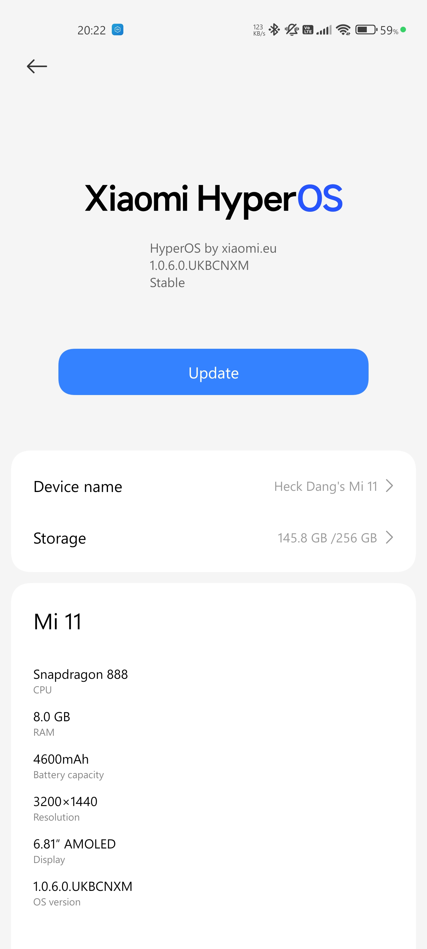

I revert to 1.0.3 and phone work, but say "let the phone reboot fully before opening apps" or something. I am crying. The sobs, the sorry sorrows.,.,.,.,
but
i flash back to 1.0.6. This time. Overwrite MODEM.IMG from 1.0.3 into 1.0.6 folder
BINGO
we have the truth
the good fix
incredible
if you find this helpful, pleAse provide one liek to the message. I accept personal messages. Regards
can you please provide me modem.img from 1.0.3 , I have the same problem... flashed on my mi11 1.0.6 thru twrp ( was on 1.0.4 ) , system reboot with no sim service ( bluetooth works, wifi can see networks but cannot connect ) , tryed flash again 1.0.6 no luck... tryed flash 1.0.6 with modem.img from 1.0.4 , still no luck... nothing works on the phone, lots of force closes of everything, i do not have any more hope , any ideas ?
---update
lost any hope, as last resort flashed 1.0.4 even it's downgrade and knew that will have bad consequences ( but had hope as this post mention after that 1.0.6 with modem.img had chance... ) , but they got warse than expected , happen the same - rebooted ok - had network working , but with msg 'wait until your device is fully rebooted before opening apps' - which basicly means the encryption keys are lost - when reboot i can first only unlock with my correct pin ( any random number do not work , so still checks for my correct pin ) but after that there is no more pin request to unlock after and no app work... in twrp now do not recognize my pin to unencrypt the data , so basicly lost everything on the phone , till the last backup
---update2
i am almost certain that this happen due to pending google play system update ( from security status menu in settings ) , that wanted reboot to apply and didn't do it , flashed in this state to 1.0.6 and my best guess is this is the reason all the bad stuff happen after , missmatch between it and system android security patch level/date and the downgrade after to 1.0.4 trigger some kind of encryption fbe protection/missmatch/reset or so
