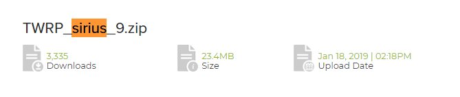

This TWRP does not work with MI 8SE, it works with the rest, but not with MI 8SE. I gave a link to TWRP, which is on my MI 8SE.
