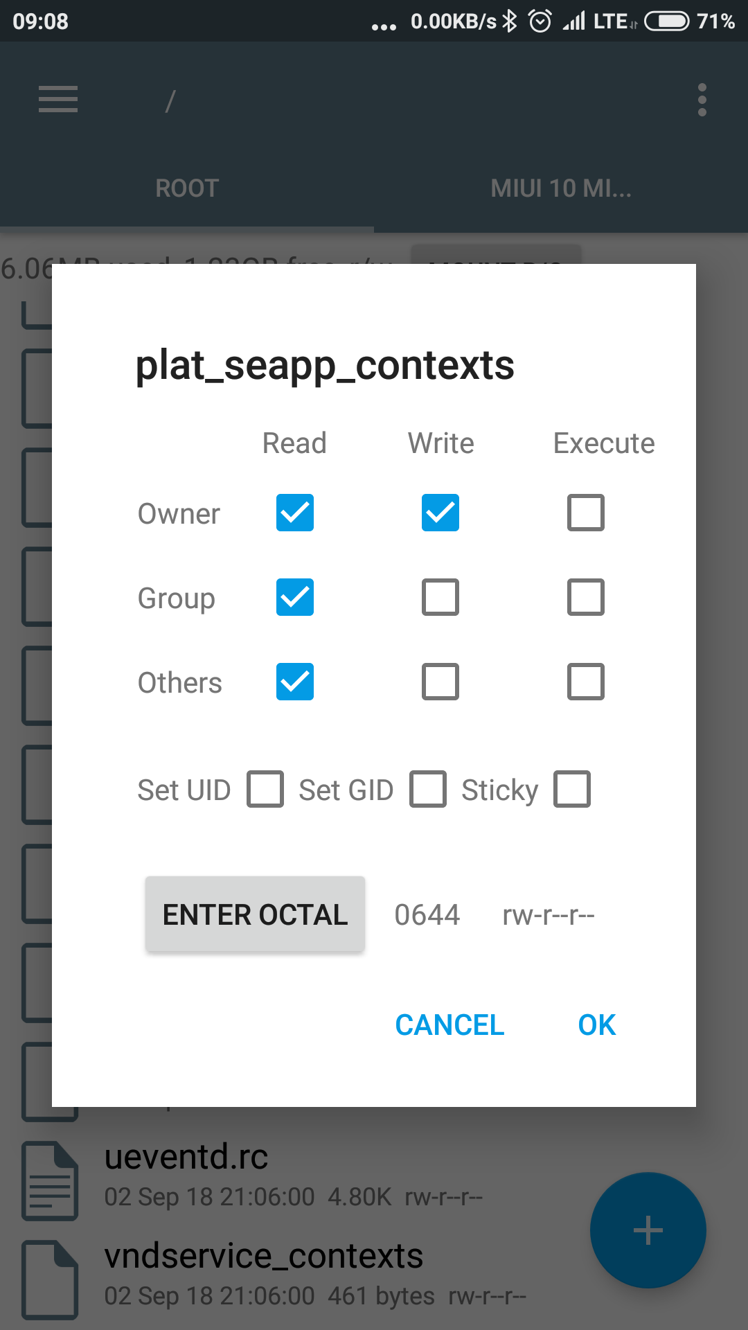

HI,
I have MIU10 also and the device rooted. It happened also to me that after installing one ROM the calls sound is very poor....at the beginning I thought it was the earpiecec but after I replaced it ti was the same....SO know I want to try with this.
I´m not an expert on all this I just follow the instructions of experts like you ;-P...
Being said that I do not know what to do when you say "set permissions back to rw-r--r-- for the 3 files. " could you please detail the steps to be done.
Many thanks
In the root explorer you use, long press the file and choose "permissions" option.
R=read W=write.
Owner rw
Group r
Others r
I am hardly an expert, but I learn when I need to...
