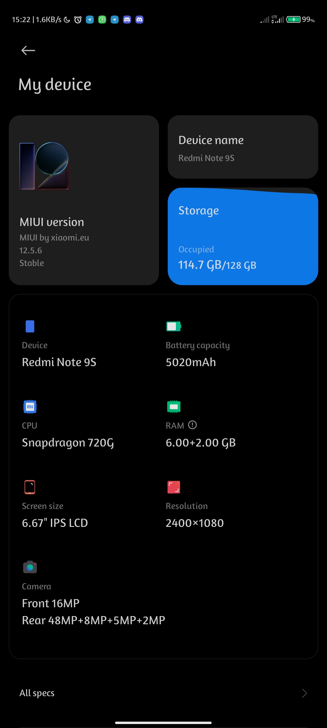

Can I install this MIUI 13 on my Redmi 9S without formatting?
Presently running on stable eu ROM 12.5.6, A11
Presently running on MIUI 12.5.6, A11
Do I have to format (not wipe) Data in TWRP
You have to format (not wipe) data in TWRP
- if you install the xiaomi.eu rom for the first time
- if you change from weekly to stable (recommended)
- if you change from stable to weekly (recommended)
- you will loose your data -> make a backup
