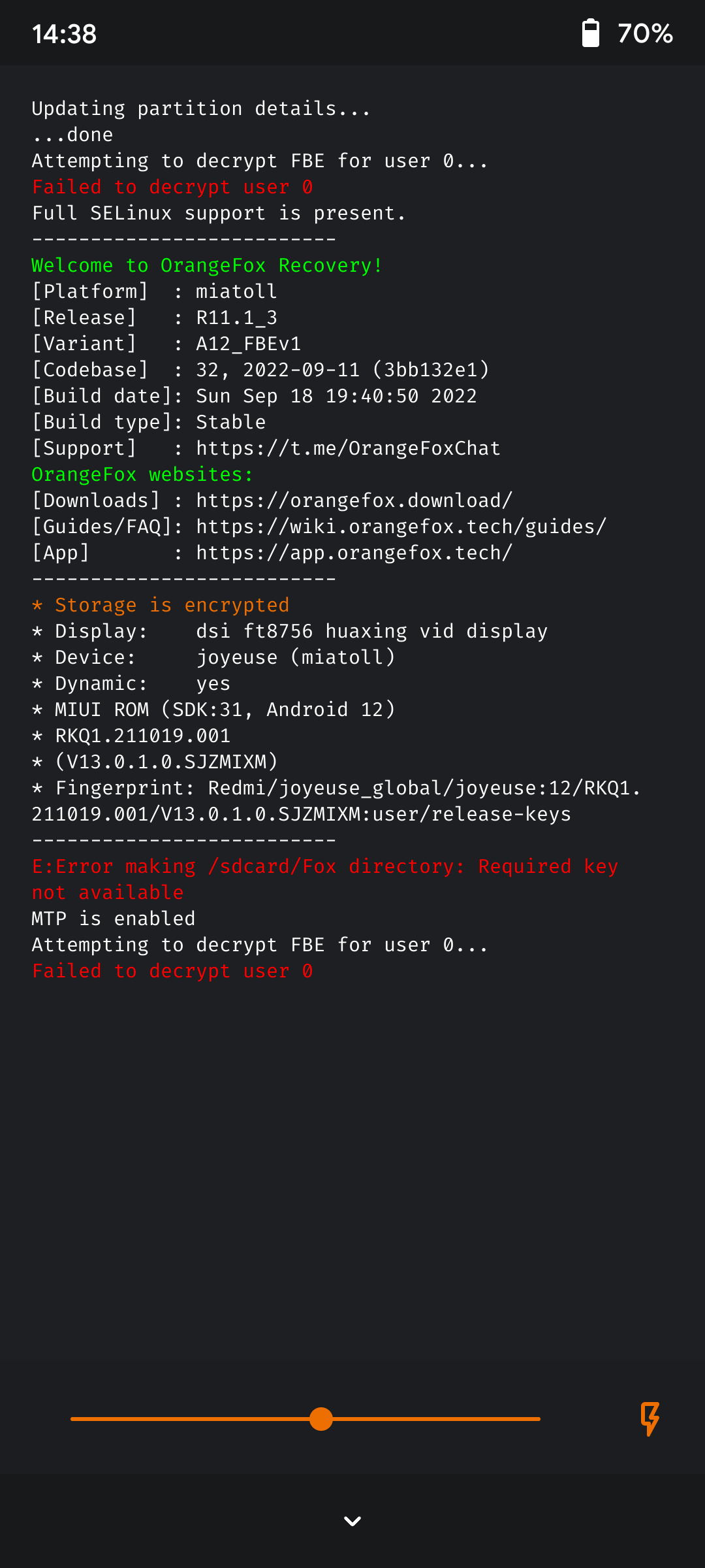

Anyone using Redmi Note 9 Pro EU MIUI V13.0.1.0 SJZMIXM (or anyone who knows the answer by heart): what is the default file system type of /data partition? Mine is F2FS and I didn't ever change it but I'm having a kind of strange issue with the latest stable OrangeFox-miatoll-stable@R11.1_3_A12_FBEv1.zip (and all betas): when OrangeFox is trying to decrypt my /data for my user with the 100% right pattern it says it can't decrypt user and in the same time I'm able to browse /data (no gibberish filenames/dirnames anywhere) and I can do whatever I want with the internal storage (mounting and everything is working, no gibberish filenames/dirnames anywhere). The OFox response on this matter was "it's a ROM issue".. which would be strange knowing that under Android 11 it did work perfectly. Any thoughts or ideas? Thanks!

So, you boot to OFox, it asks for a decryption pattern, I input the pattern, it says it doesn't work and after I hit the back button it still drops to the OFox menu and I can browse the files, I can manage backups, I can even go to the app manager in OFox and it sees all my apps, etc, so ___seemingly___ the pattern did work and it was able to decrypt + mount everything but still, there was an error message etc..
When I remove the pattern is doesn't ask for anything, just drops me to the file browser. When I add back the pattern and all my fingerprints it starting this again. Even after formating /data.
Hope this helps to understand the situation.

Read again what I wrote then because I explained it all - I did say everything but let me try it again:
- If I remove the pin or pattern (from the ROM or via formating data) then OFox is not asking for anything (obviously) and I can see all my stuff

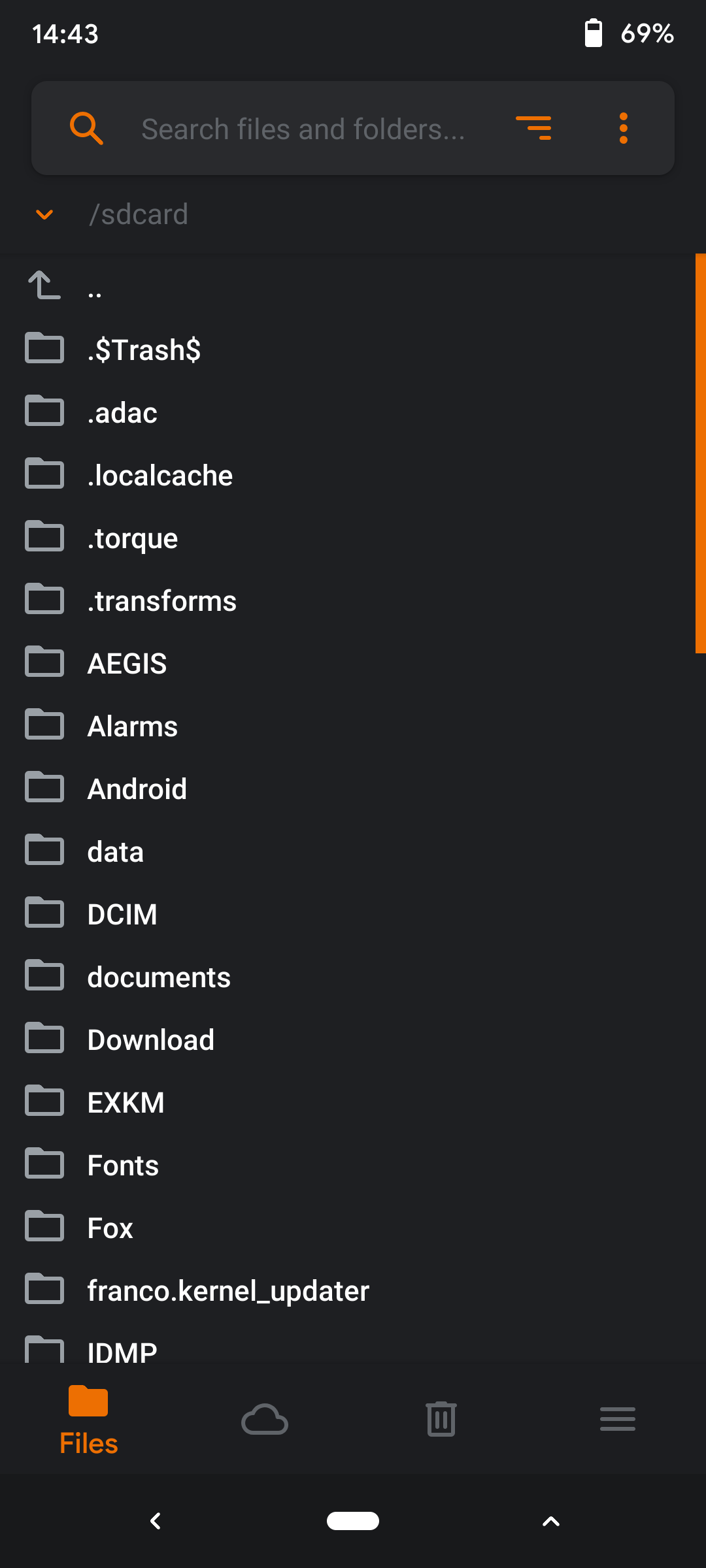

- If I set a screenlock pin or pattern in the ROM then OFox asks for pin or pattern and when I input the correct pin or pattern OFox says it is not working BUT if I just tap the back button I can see all my stuff (seemingly decryption did happen even though OFox says "Failed to decrypt user 0", see the screenshot below)
- If I set a screenlock pin or pattern in the ROM then OFox asks for pin or pattern and when I input an incorrect pin or pattern OFox says it is not working (obviously) and if I just tap the back button I don't see my stuff, it's all gibberish (obviously decrypt did not happen).
I really can't describe the situation any better because this is exactly what I experience in OFox with Xiaomi.EU ROM.
It looks NOT to be a ROM but an OFox issue and I wanted to crosscheck with others - probably this is why Joyeuse has only fastboot MIUI 13 ROM and no recovery ROM released as of yet. Guess you have a different phone and you can't crosscheck because I presume you would've already rebooted to OFox to check it.
Here are some screenshots, probably can help you to understand what's going on:
OFox says that storage is encrypted. After I input the correct pattern OFox says FBEv1 decrypt was not successful:
Although as you can see my internal storage is decrypted and you can read the file/dir names.
PS: When I input a wrong pin or pattern then everything in internal storage and in /data are gibberish, you can't read proper file/dir names.
TL;DR: When I input a correct pin/pattern then everything in internal storage and in /data are readable but still I receive the very same error message in OFox.
I really-really can't explain it any better........ but a picture says a thousand words, so I hope the screenshots are helping..
